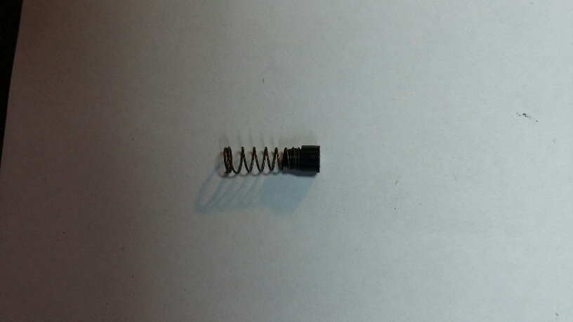

    When Fettle becomes Battle - Always had great difficulty getting the NRV in the Handi lantern to seal. Finally put a rotary wire brush down into the pump tube, a risky business, and Lo ! loosened and removed the remains of old washers, been in there for years. One lead and one of the quality gasket material, Klingite or somesuch, which did work for a while but has since disintegrated. Peering down into the pump tube with a torch, it's difficult to make out exactly what is down there. Then had to pluck out the bits of detritus with a rod and rag with grease on the end.
    The quaint little Handi NRV, smaller than all my other NRV's, has a chamfered face so that instead of pressing the washer against the face of the pump base, it actually spreads the washer - splays it outwards, i.e. from the inside diamter, radially outwards. A proper pain, because a new lead washer is instantly deformed when the NRV is tightened down. With a thread of 7.5 m/m od there are no suitable lead washers, or punches about. Arrgghh! Couldn't find my lead sheet, so made a washer from annealed copper. Yes, so far it's O.K. Better than lead, I expect. Also put in a new NRV kit. The old pip was without the little brass cup, quite good, easier to handle. The young fella who serviced this Handi many years ago, twice, has since moved on to other pastures, probably the meatworks, where his talents as a butcher would be more appreciated.

    Thanks. I thought the wire brush trick rather barbaric, but it was a last resort, since nothing would seal there had to be something wrong. I shall cut some more annealed copper washers, for standby's. Not as soft as lead.
