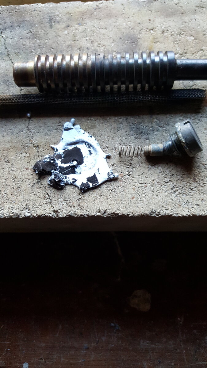

    I think that any material will do for an nrv sealing washer as long as it works.
    Originality is always nice but something like an nrv just needs to work.
    There are many other nrv pitfalls to be careful of as i found out today.
    After removing the nrv from my gunked up ditmar 506 and successfully removing the barrel without marking it and not getting caught by the left hand thread.
    I was well on track to see some light until I gave the barrel some gentle heat to burn away the gunk ready for a quick wash and reassembly. It turns out it was made from a pewter type white metal with a very low melting point, after a very gentle heat from the end of the flame, the moment it stopped smoking and burning crud away I switched off the blowtorch and looked back at the piece of wire I was holding it on to see that it had disappeared and reappeared as if by magic in the form of a splat on the bench.
    That is one rare part now even rarer and me even more experienced.

    Bugger, there’s a trap for young and old players alike.
    Thank you for sharing. I hope you find a replacement soon.

    Wow -some sort of "pot metal" I wonder ?
    11,105
    The dreaded Ditmar NRV! Left hand threads and low temperature metals...

    James: A calamity. Hope you can get around the problem, make something up.
