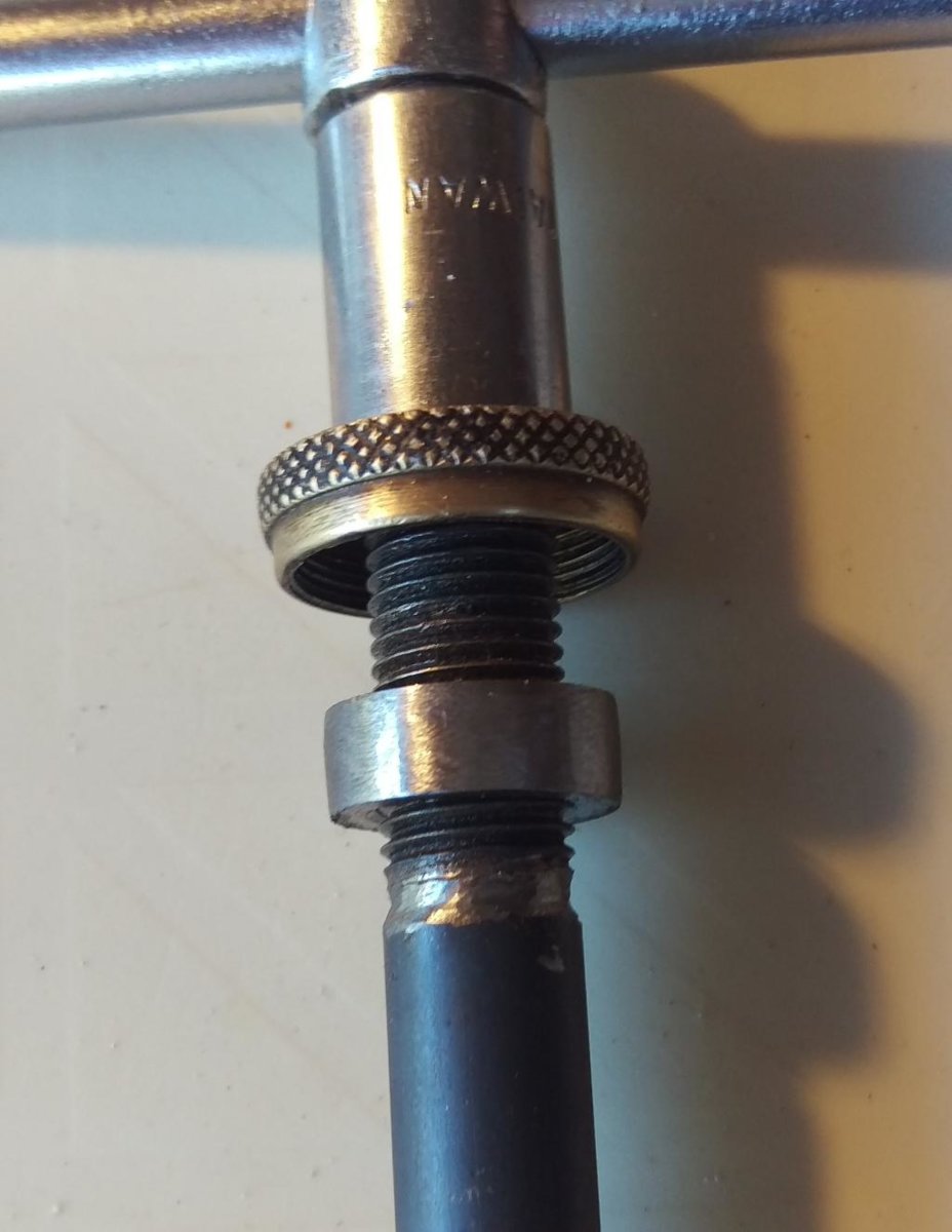

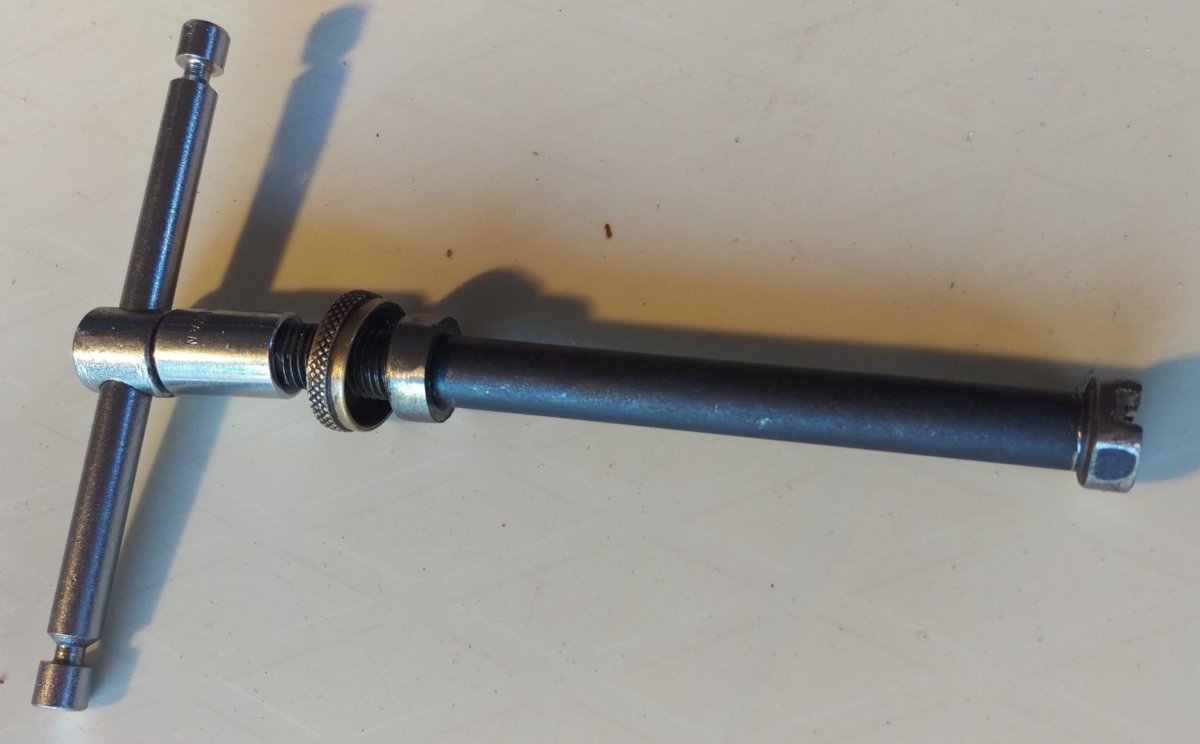

  11. phaedrus42
    phaedrus42 Subscriber
    2,056
    A home-made NRV tool like the original Primus design. A true one-click tool that saves mores time and aggravation than Amazon one-click ever did, trust me!
  12. ColinG United Kingdom
    4,816
    Indeed, I tried to use an NRV extraction tool I bought cheaply and it was worse than useless so I made my own in the end. This was to remove the NRV on a Burmos stove but the principle is the same. Of course, the one I made is for an NRV with a protruding central 'nub' whereas the one in Jean's Coleman is a slot type otherwise I would send Jean mine. As Mackburner says, it's very easy to chew the brass slot up by trying to use the wrong sized screwdriver!
