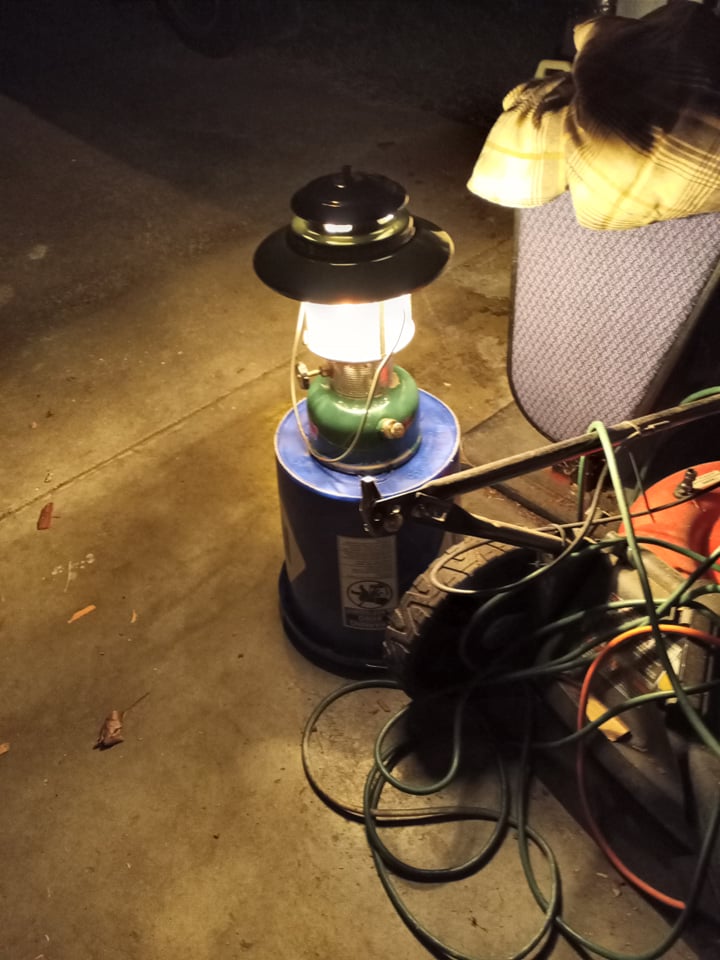

  12. Centurion13
    Centurion13 United States Subscriber
    Oct 16, 2021
    25
    Bremerton, WA
    I lit it up again tonight. No issues - the mantles caught right away and in 30 seconds were putting out bright light. I find I prefer the Petromax thorium mantles due to their brighter wavelength. Immediate ignition, and after rotating the cleaner rod, I noticed the light got brighter. Ran it for about 30 minutes while reading my book. Too cold outside for me to smoke my cigar longer, so I retired to a warm house. 30 seconds after shutting the valve, the light died completely out. Looks like a successful overhaul!
