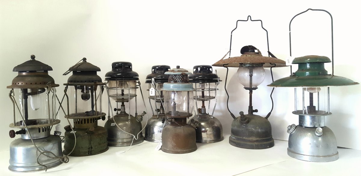

    Stumbled across an obscure auction house the other day.
    Ended up with this lot. All have entact globes.
    Looks like more lockdown fettling on its way.
    Average price per lamp ended up at AU$40.

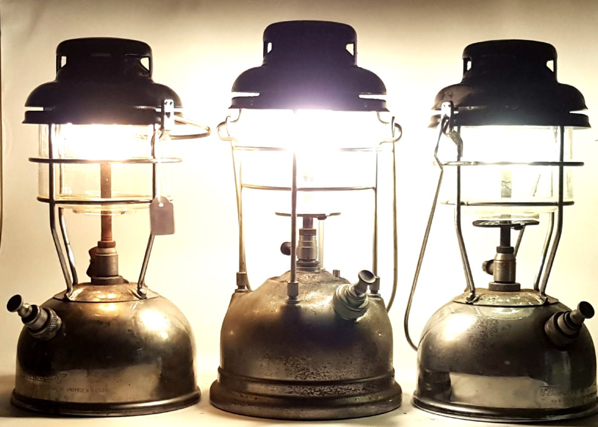

    Just fired up 3 of the Tilleys at the back. No pull down, no cleaning, as found fuel in them. All 3 started no problem. The old Guardsman burned the best. Pretty happy :p 20200421_121440.jpg

    Nice line up there, love the vapalux and original shade

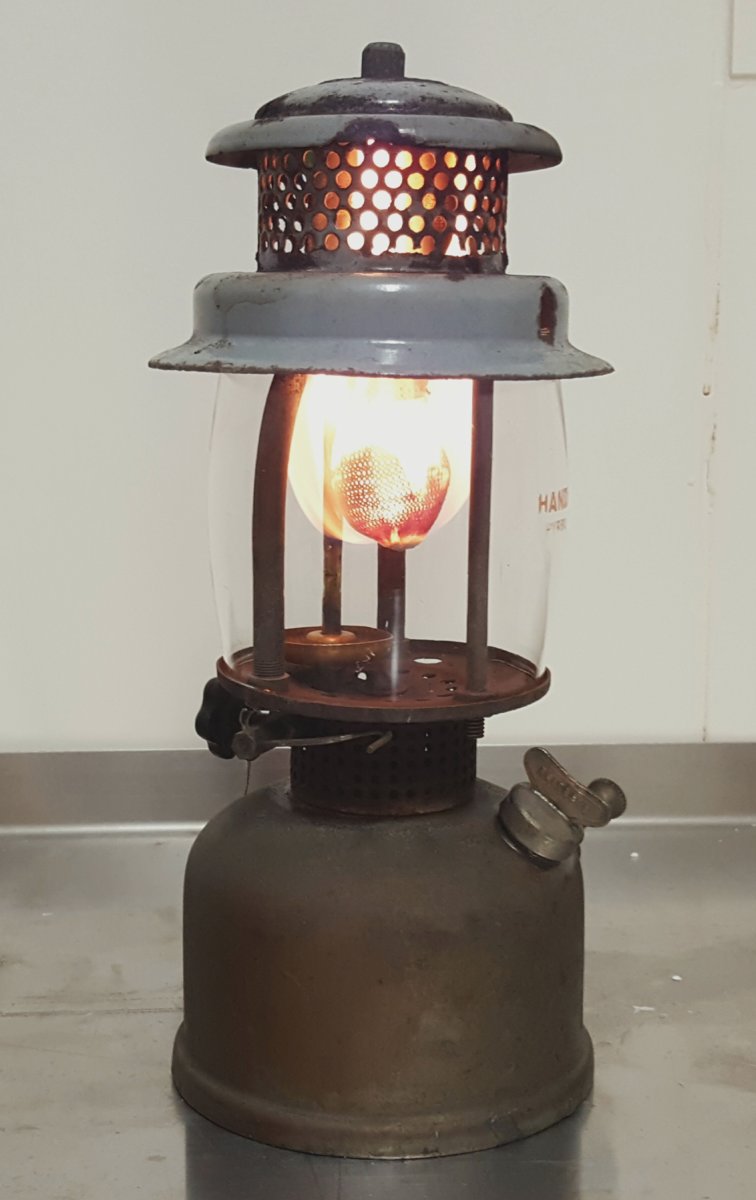

    Fired the Handi Pet up but as you can see, way too rich. I guess the jet has had it, or maybe a wasp nest in one of the intake tubes.

    It's a good idea to check all is in good working order before test firing a lamp (I"ve had 3 wasp plugs in a 242 coleman air tubes)
    [pressure dunk test for leaks, check valve operation, check seals, gaskets jet & pricker
    Then light outside (or in a safe place) without a mantle or globe to check flame pattern
    (Those Handi globes are like hens teeth too)

    handi's are one of the quickest preheater I've come across, you may be right, check out the air tubes for blockage, your jet is more than likely fine, make sure it is screwed in tight firm, if you do pull apart the generator be very careful with the pricker rod/ needle you can not get a replacement, I've been working on making my own with limited success. the badge on the collar is red it is a kerosene lantern, if it is blue it is a shellite lantern, it has a preheater cup like the kero,
    inside the generator there is a curly spring type flow restrictor that is kero, if it is a fine brass mesh that is shellite. if the badge has no colour left on it the generator is what tells them apart,
    although they are known as model type 3 there are many suttle differences , the originated from the AGM style lantern they were know as a swift lite.
    great lanterns, I have quite a lot of them in my collection, I just like them. original globes are hard to come by, you can but replicas from eBay.
    the petrol lantern with the pre heat meth bowl, use it just like a kero lantern , it preheats every thing , just wait until the very end of the bowl evaporation, then turn on the lantern and light the mantle, if you don't preheat I've found that you get a lot of flames and burning and panic and flames and panic and burning and flames and panic, then it gets it act together and of it goes, as mention in above comments , a good practice is to clean up your lantern, test for leaks, and do light up outside in a safe area.

    hi there, the petrol version has a bigger jet this is why you had a rich orange flame around the mantle.
    good score, in the lantern gallery you will find the handi lantern part it will have the information there about the use and care for your petrol handi.

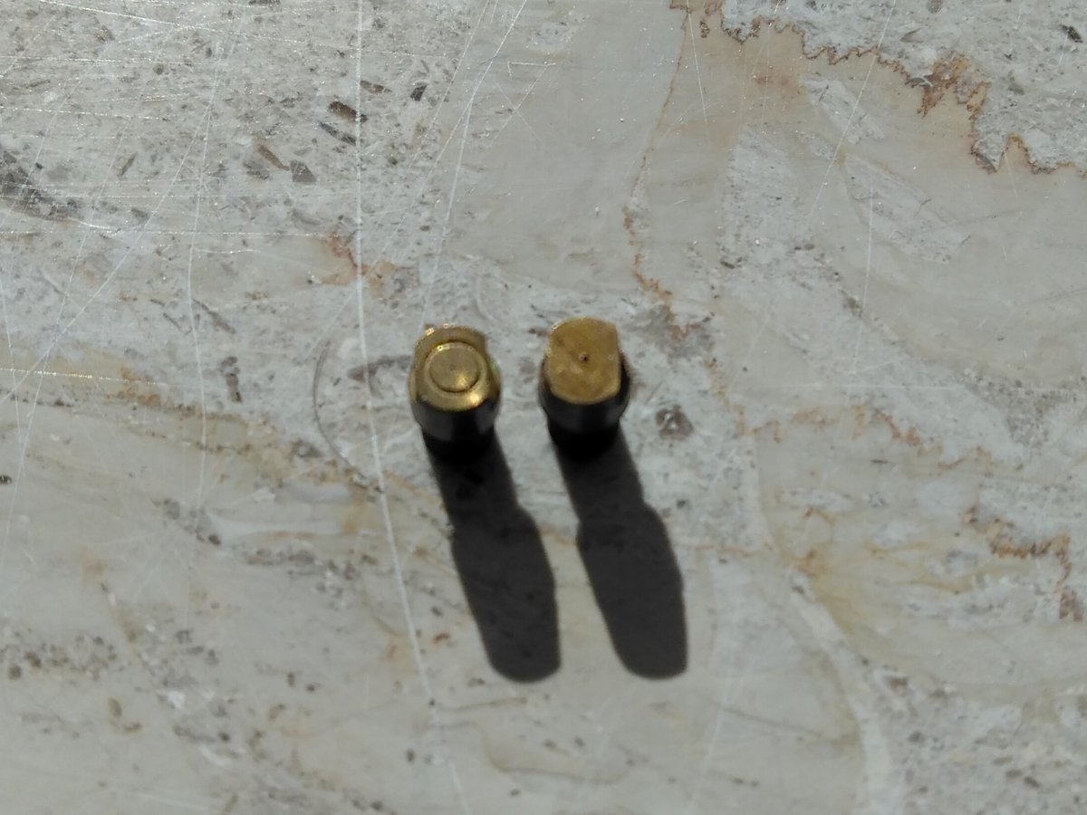

    Here's an image of petrol and kero jets (petrol on the left). A bit out of focus, but you get the idea about the "O". Of course there is no guarantee that all the petrol jets were stamped, just to confuse things. :) The majority of Handis were sold as kero lamps, so it is quite likely that what you have is a kero jet.

    Hi Nils, thanks for the images. Very much appreciated. Yes I had another look at the jet and it is the one on the left with the circle around the orifice. Not as clean as yours though :D

    That confirms it is a petrol jet. The Handi works fine on Shellite. The only issue is that the pump valve is still just a seal held in place by a spring. Not good if it fails. All the rest of the construction is fine for using with petrol. I'd try and find a kero jet from somewhere and convert it.
