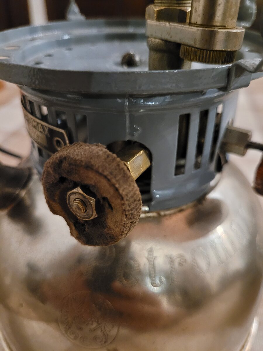

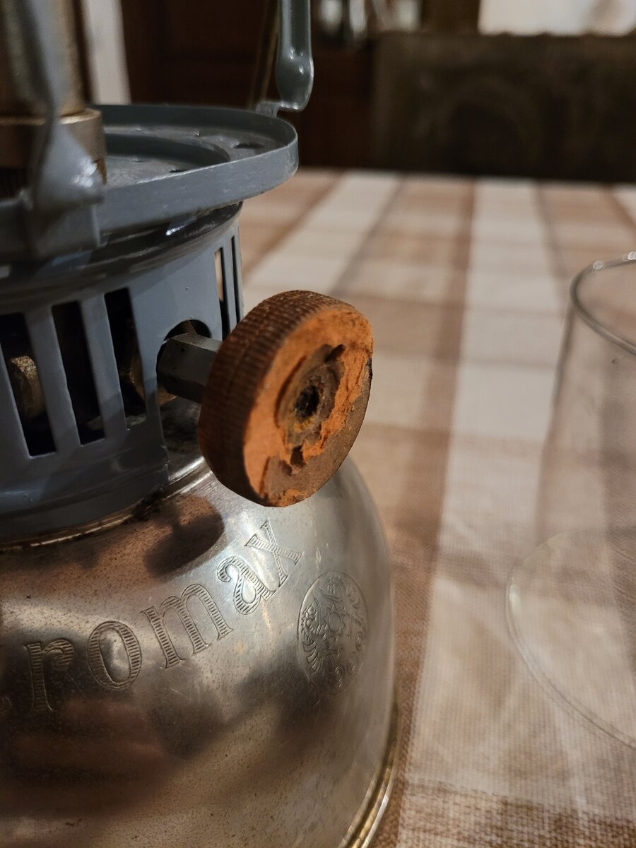

    Good afternoon, colleagues. Does anyone have any idea how to restore these old hardboardknobs? They've been out in the elements for a long time. Perhaps soak them in vinyl glue and press them back together? Any help is welcome. Kind regards.

    These old 'fibre' knobs were made from cellulose/paper, impregnated with some phenolic-formaldehyde resins and pressed molded under pressure and heat. Similar material to Pertinax material:
    Pertinax® - a traditional material with a new future.
    I think there are many ways and methods to restore it. It'll depend a lot on how you want to go about it. Either simpler home DIY styled or elaborate "professional" methods.
    DIY-styled examples:-
    1. It must first be thoroughly cleaned and dried. Ensure no oils or remaining moisture.
    A variety of glues or adhesives can be used.
    Fastest would be the low-viscosity cynoacylates aka "Superglues"(further classed into general purpose to speciallized types):-
    Check if the fibre knob's degradation is just superficial or more extensive into its core.
    The above adhesives are usually very fast acting. Apply carefully to soak the surface. It might penetrate deeper if you immerse the knob completely in an air-tight container, slowing down the curing. Exposing to air and moisture might instantly cure the glue and makes it difficult to clean the mess, especially on the knob's "knurled or toothed" edge.
    Once lifted from immersion, immediately blow away the excess with compressed-air. Do not use a rag or paper towel to wipe (it'll stick to those instantly and cause another mess).
    Leave it to cure naturally. Heating can hasten it a little but not really necessary. You need fast hands to expedite this before the glue hardens.(expect the glue to stick your fingers and hands).
    2. In a more forgiving method, you can also use Gasket Shellacs such as:
    Soak the wheel thoroughly in the shellac. Wipe-off the excess. Allow to dry slowly in the open. Do not heat it immediately(allow all the alcoholic solvents to evaporate first).
    After leaving it to thiroughly dry, for say a couple or so days, you can gently heat it to slightly harden it further. Touch up if necessary.
    3. Using other adhesives like: epoxies, polyester resins for fibreglass repairs, acrylic adhesives, etc.
    Select any available that has:
    - very low viscosities for better penetration.
    - as slow curing as possible to allow more working and clean-up time and reducing the possible mess of cured adhesive on the knob's "knurled/toothed" side.
    "Professional"-styled:
    Might require speciallized equipment, fixtures and bonding agents/adhesives.
    Vacuum-Pressurized-Impregnation gives the most thorough penetration. Heat curing adhesives.
    Best to use phenol or resorcinol-formaldehyde adhesives and resins as used for forming the Pertinax material.
    There are more speciallized adhesives for cellulosic materials like paper, cotton, wood, etc (datasheet attached) such as:
    Once the adhesive/impregnation agent has cure, you can finish and polish the knob to make it look new.
  3. Leonardo Collares Uruguay
    Jul 7, 2023
    54
    Uruguay
    Thank you very much MYN!!! This is not a help, this is a magister class!!
    The degradation is very deep, I will try some of this ideas, showing the results, best regards

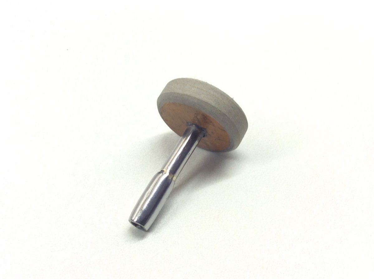

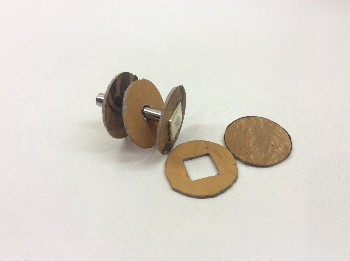

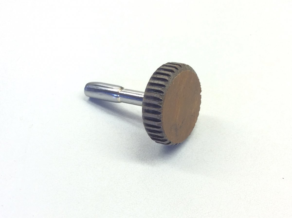

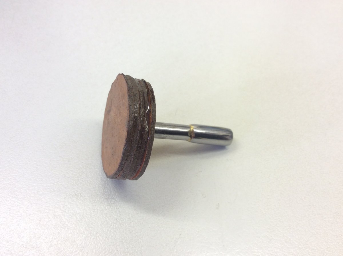

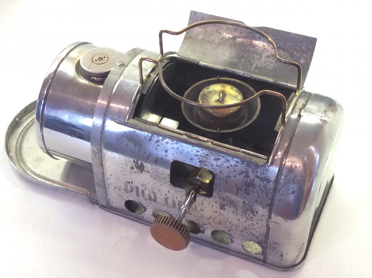

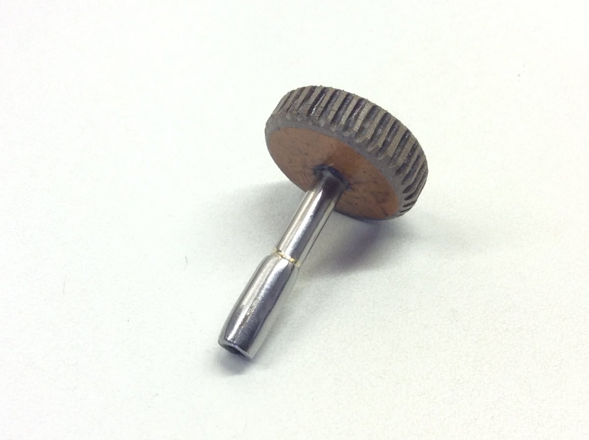

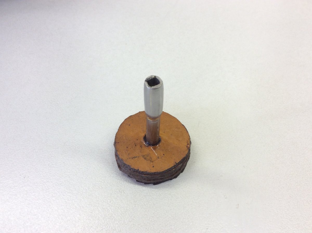

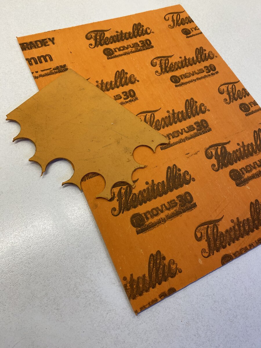

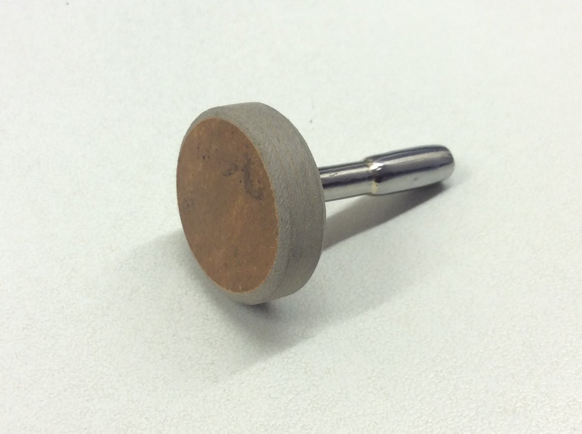

    I had no opportunity to restore the fibre control wheel on this Pigeon Ignus naptha stove, because it was absent, so I’d to make one from scratch.
    I used the flexible sheet (Novus 30) that I punch heat-proof washers from for camp stove burner riser seals.
    Having made a steel spindle to fit the stove burner regulator I punched discs from the Novus sheet and bonded a laminate of them using two-part epoxy adhesive.
    John

    Very ingenious, @presscall
    Fibrous gasket sheets make an excellent substitute. Bonded with epoxies. Epoxy adhesives do not require drying off any solvents, which can be limiting if you have non-porous materials involved.
    Once mixed, they will still cure and harden in enclosed space.
