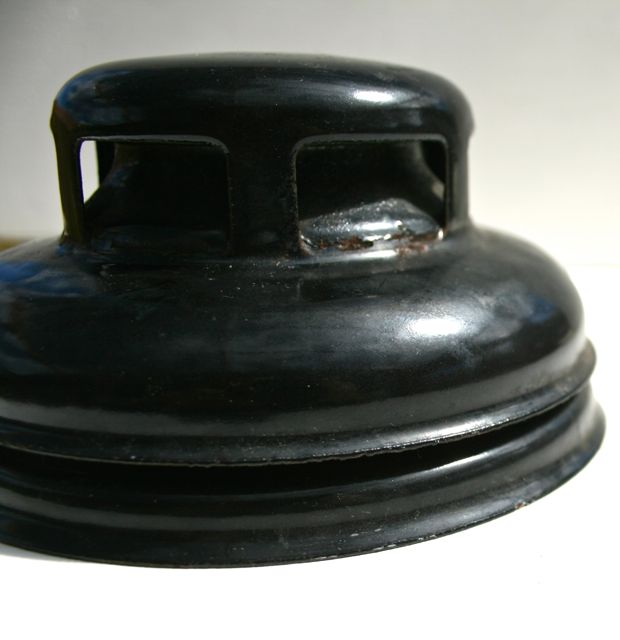

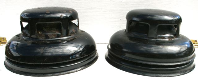

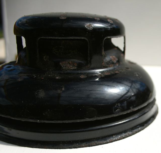

    There are two versions of the shape of the enamelled all steel hood for the Tilley X246 lanterns.
    The first is shown on the left hand side of the photo below; the second on the right hand side (each individually reproduced below). The second is distinguished from the first by a small lip on the skirt of the middle section of the hood. The first lacks this "lip".

    The second shaped hood is first identified in print in the 1950s (date not precisely defined). These also came in brown and black, but eventually only black were made/supplied.

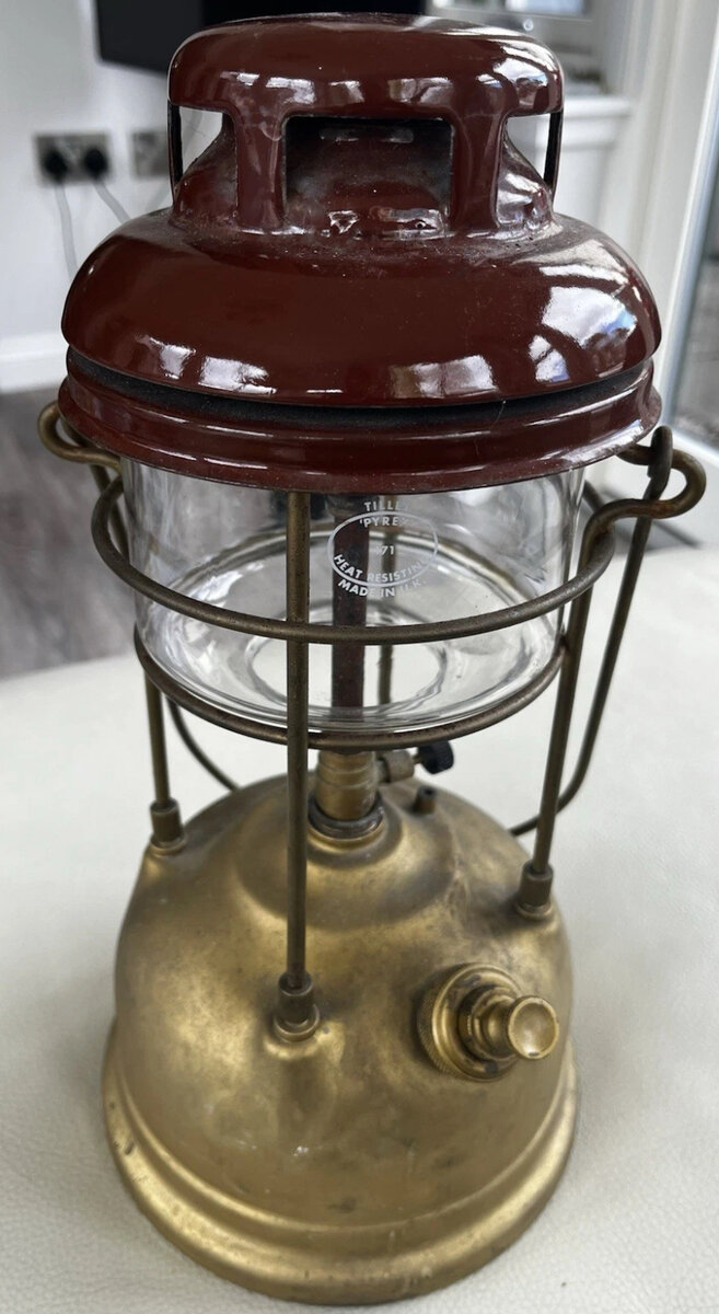

    I have a Guardsman "with ears" that has the early hood without the lip, I'm told this is a rare early hood and likely has a value in excess of that the lamp?
    Either way its a keeper lamp and was bought as such, its the first early Guardsman in my collection
    Will be joining a later "straight bail" X246 once competed and my first lamp, my X246A

    Without doubt, any brown hood in that condition, will considerably outstrip the rest of the lamp in terms of value. Slightly more so being an earlier version. Completely parted out, that lamp would likely fetch over 100 quid if you're lucky. Sold as a complete lamp maybe 60 quid. It's an odd world...
