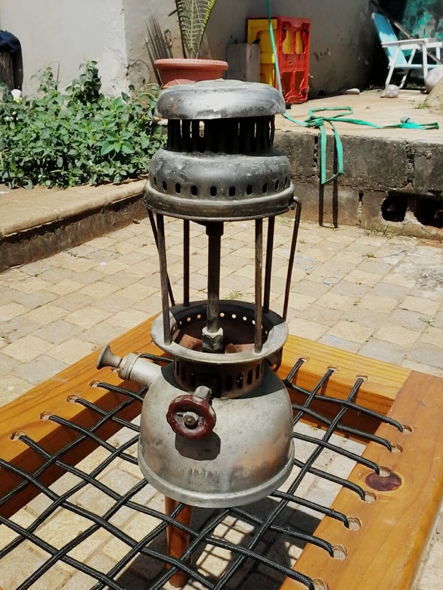

    This week I got a very well used little Optimus 100N, complete except for the globe.

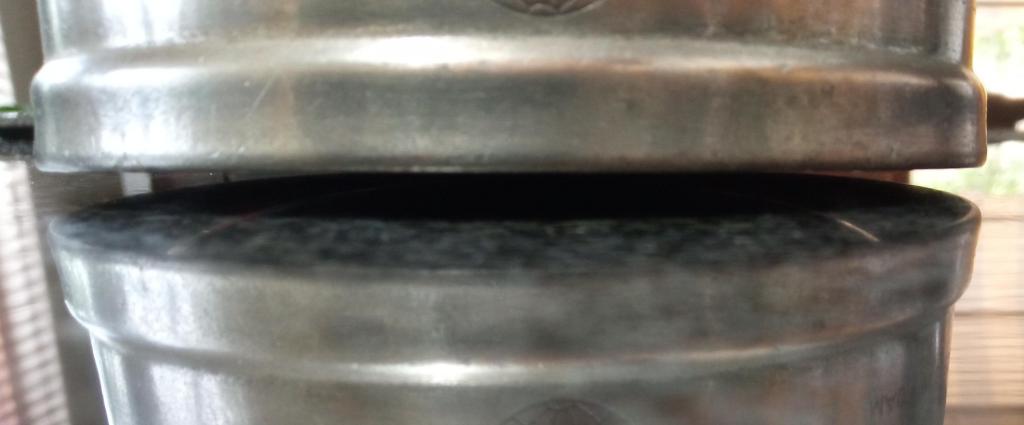

    To my great disappointment, I immediately noticed that the found bottom was bulged out, so much that it wobbles on a flat surface.
    I was not aware that Optimus founts also suffer from this problem.
    My question is: Repair or replace?
    I suspect the best answer would be to replace the fount, in which case I would appreciate it if some kind soul with one for sale or trade would drop me a line.

    @Rustytank , the bottom plate of the fount is designed with a slight outwards bulge, but with this one, the plate is deformed and the lead seam of the bottom plate has torn away all around the side wall. It looks to have been resoldered afterwards. The rim of the fount is made with an inwards curl, which captures the bottom plate.
    I don't think it is feasible to remove & refit or replace the bottom plate without effectively re-manufacturing the whole fount.

    That's pretty unfortunate, @phaedrus42 .
    Even if you do managed to knock it back in a little, it'd re-bulge once its pressurized again. I've got this problem with one of my Petromax as well.
    The cause is what you've already mentioned. Meaning, the solder being partially torn off internally around the bottom rim.
    There had been people who are very skillful at repairing such items but there aren't many of them around these days. They are basically professional sheet metal craftsmen.
    They'd somehow undo the bottom lip around the rim quite effortlessly, re-shape the bottom plate and then resolder it back with near factory-perfect outcomes. They do use some sort of jig for re-folding back the bottom lip neatly. Unfortunately, I don't know any of them.

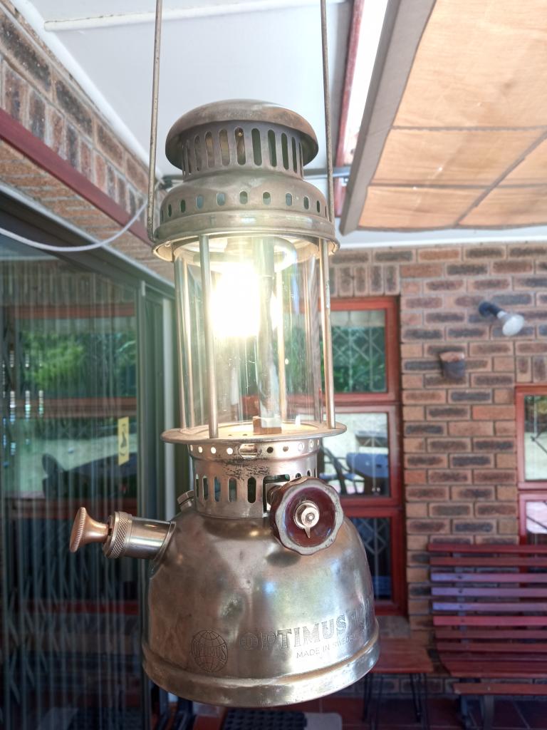

    The plan seems to have worked! I pumped up the fount to 1.5 bar after making the corrugations and the bottom popped into shape and stayed there. Then pumped to 2.5 bar and it stayed put. Reassembled and working:

    Congratulations!! Really glad it worked.

    Congratulations! You had luck on it. It didn't re-bulged when pressurized as mine did.
