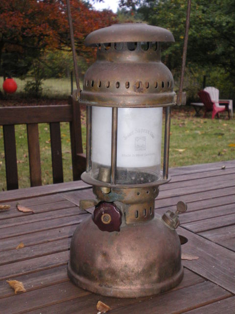

  12. ThosKiwi
    Nov 7, 2011
    67
    Thank you Svenedin,
    I've started with a Coleman USA 200A 1969 and then discovered the brass(top)/steel(base) founts of the Canadian lanterns, my 1969 Canadian 236 has this sort of fount.
    And then I discovered Coleman's backward compatibility with pump leathers etc.
    I've found 242B(1941) from local barns which showed their age with wear and tear, but still worked as found after 70 years.. That's quality in form and function!
    Here's a picture of the wee beastie.
    I've got to get the penetrating oil on it before I strip it down, I'll try and leave the patina, but I'll see if everything is functioning, like seals, cleaning needles, pumps and NRVs before I attempt to light it.
    It has three nuts epoxied onto the base for screwing/bolting down.
    I'll have to find a source of spares, I know MEC(Mountain Equipment Co-Op) carried Optimus products and I'll check there.
    I wonder if any of the current Optimus seals/spares are common to this model range?
    ThomasL
  13. Nils Stephenson
    3,405
    That's a nice find. Especially with the original glass. Those 3/4 frosted glasses are a good idea. This version of the 1200 is from the last half of the 70s and first half of the 80s. The dating is pretty rough, but it gives you an idea. Btw it is called the 1200M where the M stands for "messing" which is the Swedish word for brass.
    Odds on you'll need to change the filler cap gasket and maybe the O-ring in the quick starter. Both parts that are easy to source or make yourself. The NRV is not that old so should be alright. Otherwise it is just to check the jet and needle and oil the pump leather. Happy fettling.
