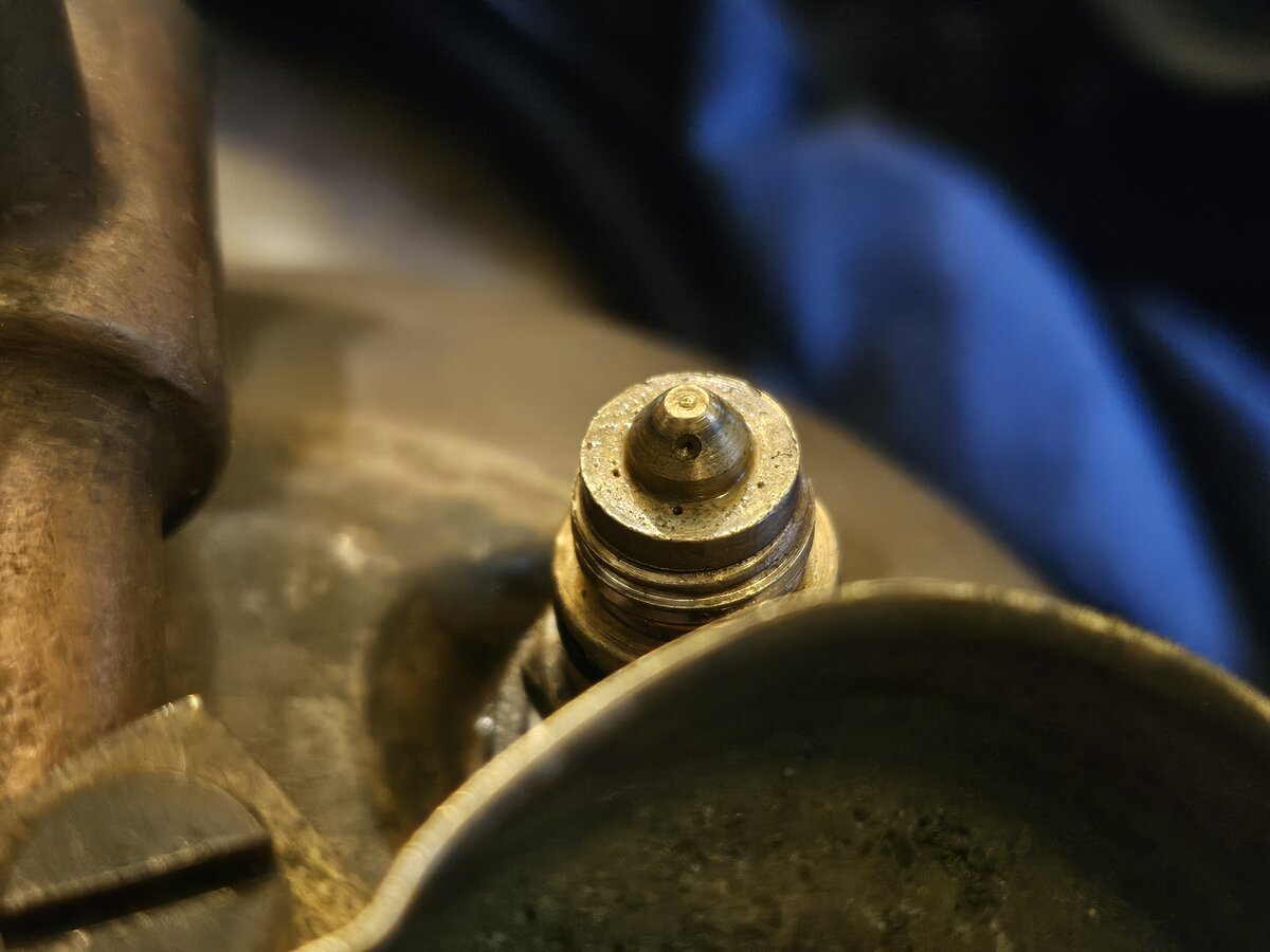

    Whilst the outlet is visible here, it is blocked. You can not see daylight through it. I pressurised the tank with 60 pumps, then opened the valve and only very tiny bubbling occurs. Taking it off completely the fuel and air flow is as per, because I have cleaned the lower part of the valve and fuel feed pipe and gauze, which cleaned up great. Fuel jets out of this as it should
    20260329_144844.jpg I'm assuming that heating it with a blow torch, then quenching will ruin it? I may try high powered compressed air tomorrow at my mate's garage and see how that goes, because the lower powered compressor I have us garbage. Any thoughts?

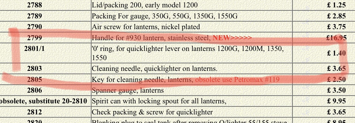

    after looking at some threads on this it looks like there is a cleaning needle available from base camp stoves?
    i have found it on the optimus page
    i would be giving them a ring and explain? hopefully Mike can help with comparability :thumbup:

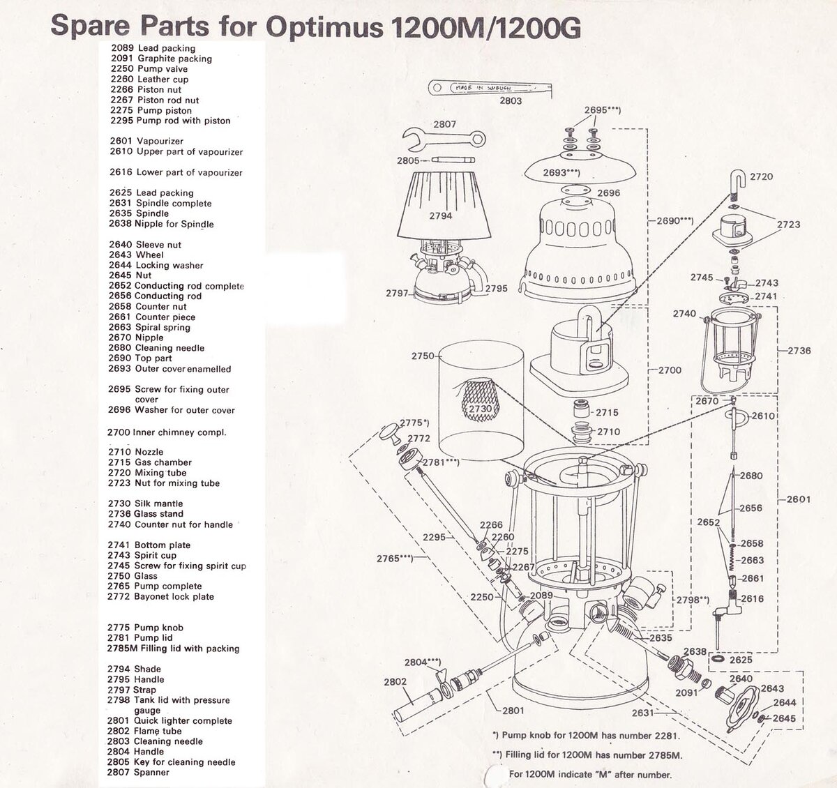

    @podbros Yes, I'd seen on the Optimus parts list the cleaning needle. I'll get one, regardless because it'll probably be good for my pair of 500's, too. 1200.jpg
    Assuming that cleaning needle is for the quick lite, as much as the vapouriser head??

    on the optimus page it specifically mentions the quicklighter, which is why i mentioned speaking to Mike, if possible, as i can’t vouch for the compatibility with different sized lanterns or different sized quicklighters?
    the ‘o’ ring seems to be the same size though

    From memory, the cleaning needle for a 300cp jet is the same size as the quick starter cleaning needle. If you have a spare, you could use one and see.

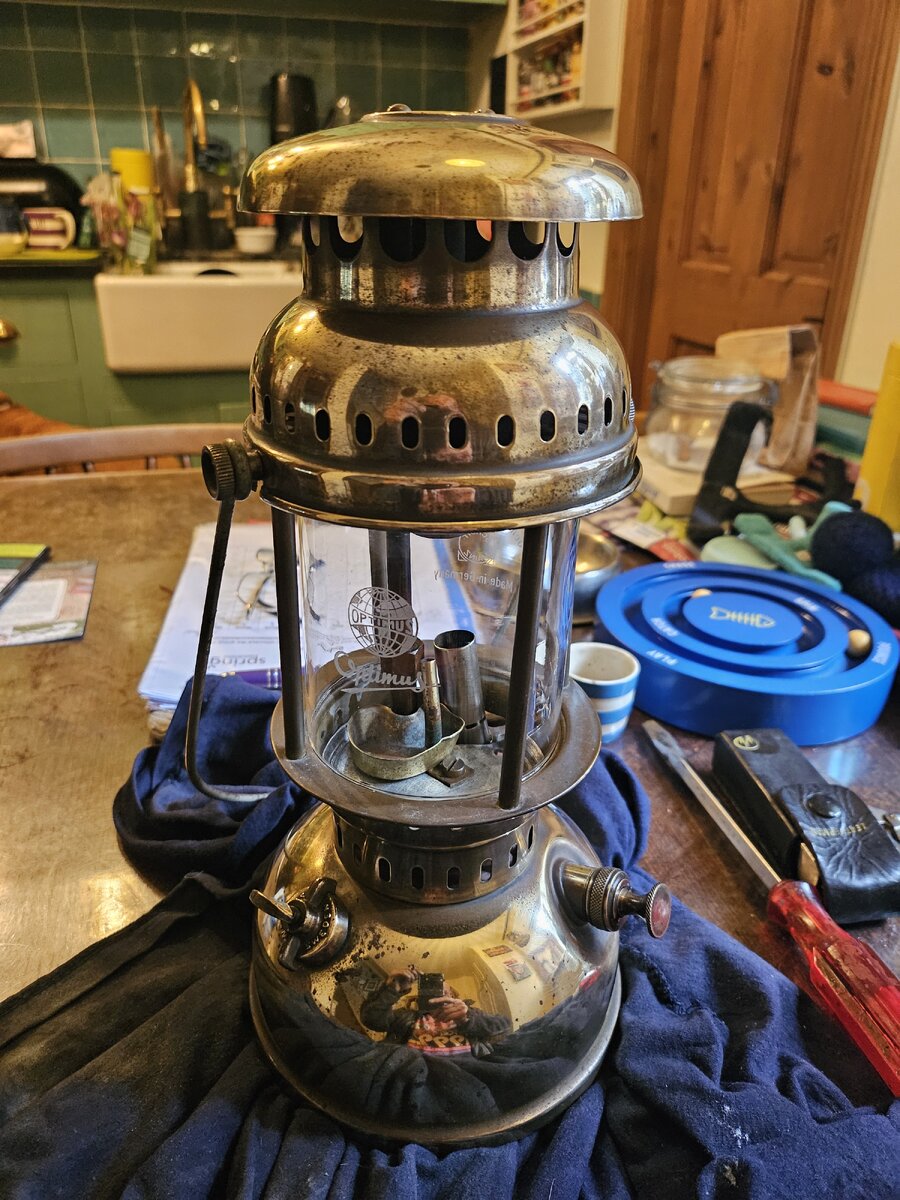

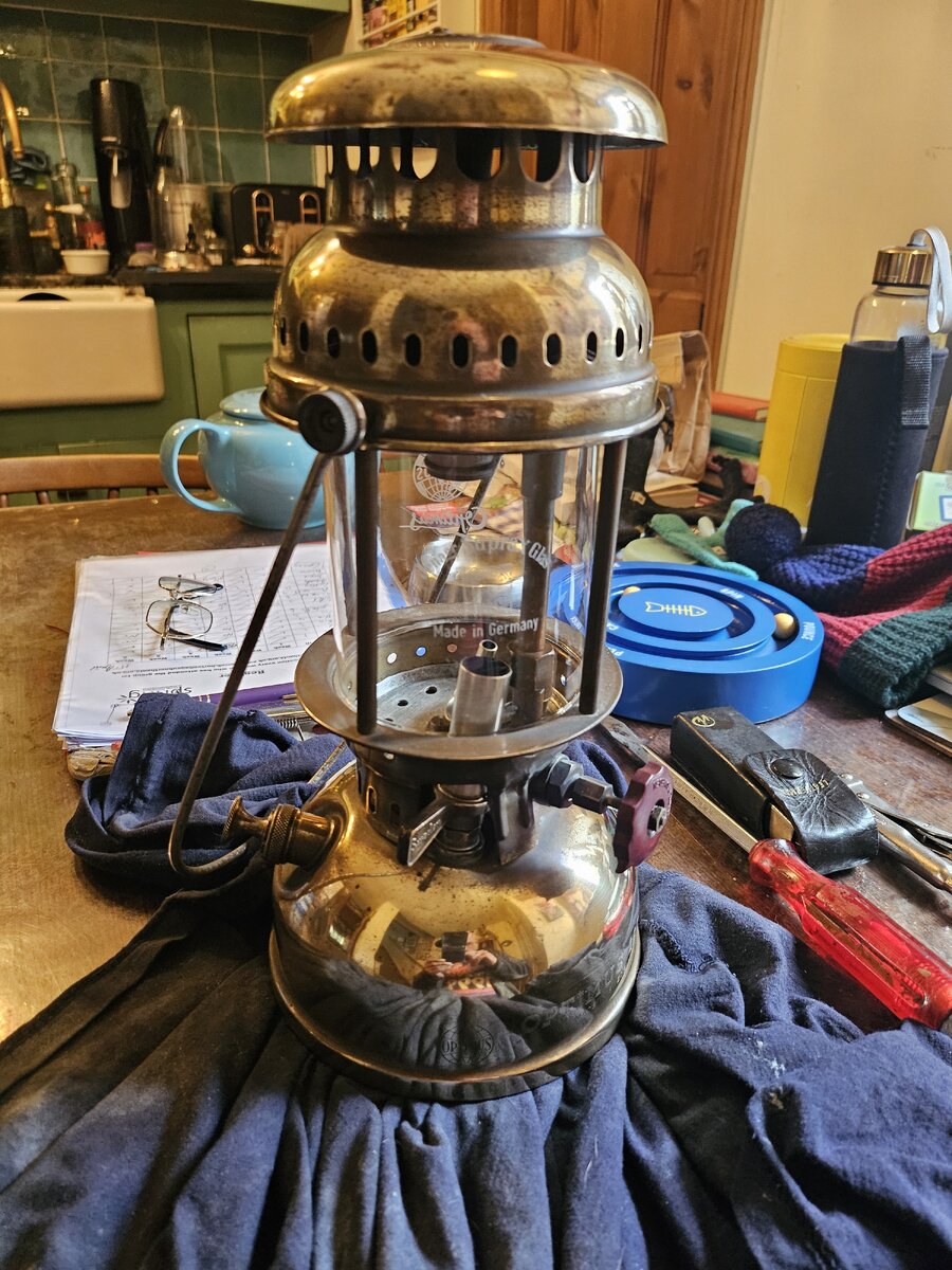

    Thought I'd post a quick couple of basic pictures of the lamp. It was very badly oxidised having sat in a garage untouched for over 25 years. I gave it a quick rub down with Autosol and I'll be leaving it at that, as I don't particularly like highly polished brass. Can't light it yet as it turns out the pump leather I've got is the larger version, but otherwise all good: 20260403_135521.jpg 20260403_135549.jpg

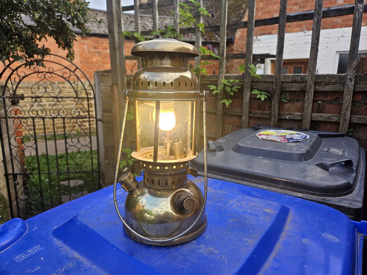

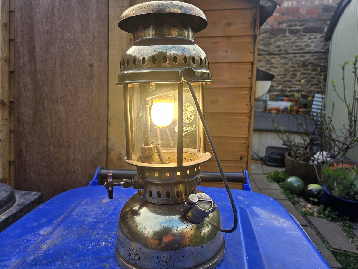

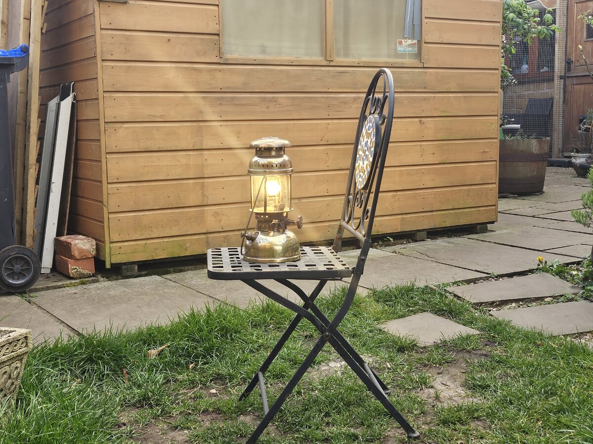

    Here are the money shots. I put a new pump leather in, adjusted the air gap down to 12mm (it was originally 17mm!) and put an Anchor sock mantle on it and filled the spirit dish rim full via a Vapalux spirit can (works great). I had several Anchor sock mantles I got in a job lot of bits a few years ago and have never used them. Not sure what CP they are, but they burnt in and formed very well. It initially flamed considerably when opening the valve fully (after 3 pre-heats), but a bit of back and forth on the valve wheel and wow, what a light! Very impressive and a definite keeper: 20260409_183930.jpg

    Oh and the quick lite works very well, but is absolutely bonkers if you ask me. How on earth the globe doesn't crack when you whack it open is baffling, but brilliant

    There shouldn't be any direct flame on the glass, but maybe the angle of the quick starter is a bit off. Looking at the pump, it looks like the lamp has had a bit of a rough life so maybe it is a bit bent.

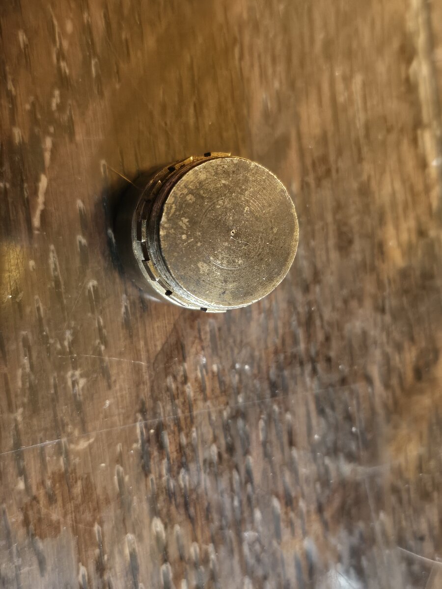

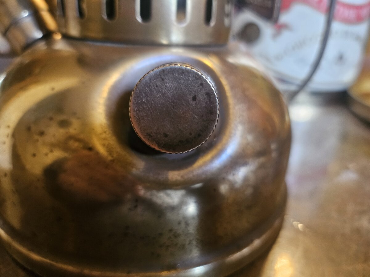

    The pump has been hit at some time and the tank has been pushed in. Not the first Optimus I have seen where this has happened. :)
    You can compare it with this one of Frederik's.
  16. Carlsson
    3,960
    Ouch!
    That poor pump must have been hit very hard to make that kind of indentation to the normally rounded tank.
    It looks like it's been pushed in about a cm, or even more.
    Good quality proof that it all survived, however!
    No big deal as long as everything works. The shape of that indentation is fairly even, so it hasn't really spoiled the look of the lantern too much.
    It almost looks like it was factory made that way. :lol:

    I'd never of guessed - really thought it was manufactured like that! Thanks for pointing it out.
