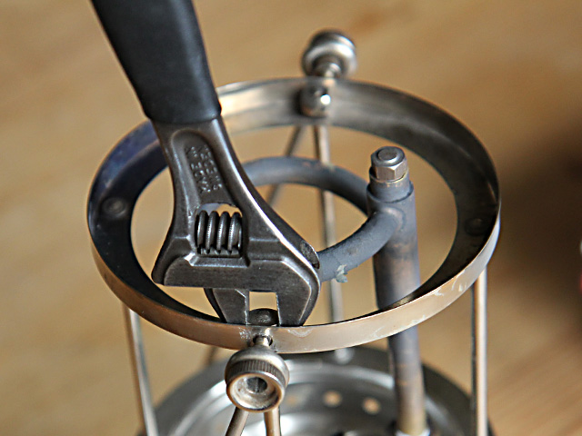

    It is also recommended that you support the cube shaped part where the threaded stud attach to the globe cage.
    It's good to use e.g. a small monkey wrench:

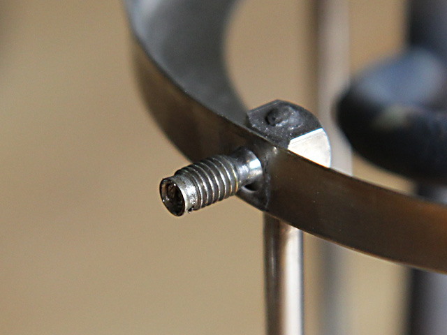

    This is what the stud look like, and you can see that it's still a bit expanded even after the nut has been forced over it.
    The end of the stud is shaped like a sleeve, so to speak, so it's not a solid piece of brass you need to force. Just this widened cylinder.
    Strangely enough, I have atleast one brass 1200 where the stud never was hammered out. The top end is a thin and nice sleeve, and both nuts come off easy.
