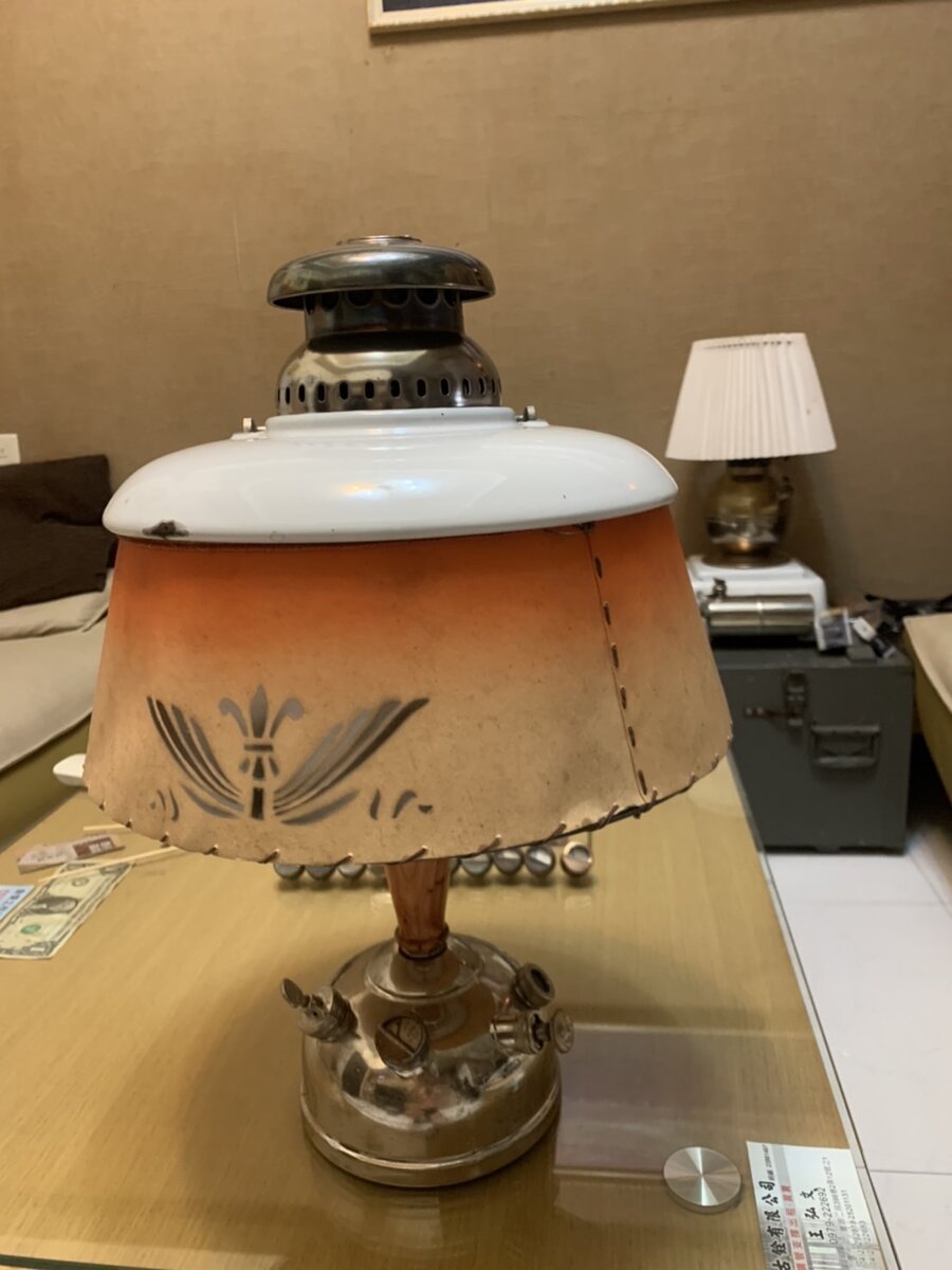

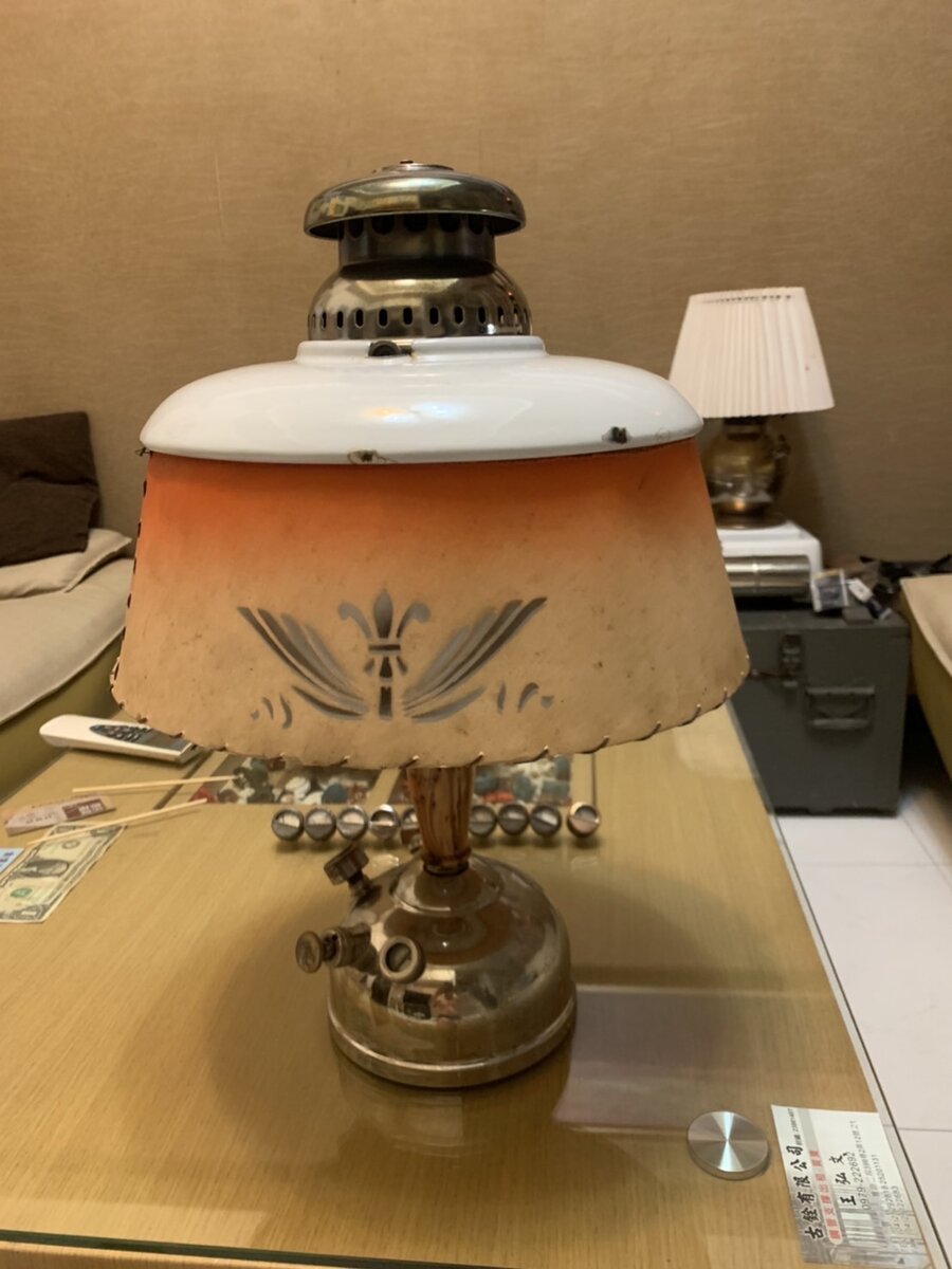

    But my question... Because I originally bought the optimus 200p, this lampshade was given to me by the seller....
    So it can be used directly in optimis 258? Or can it be used on the lamp in the lower left corner?

    I think the shade you have is for either the 207 or 307 (depending on size). It all depends on how it is attached to the enamel reflector. The shade for the 259 fits over the top of the reflector with some sort of frame and the 207 shade clips into the inside edge of the reflector. You can get an idea from these two images.

  9. Chung Taiwan
    Jan 30, 2021
    19
    Taiwan

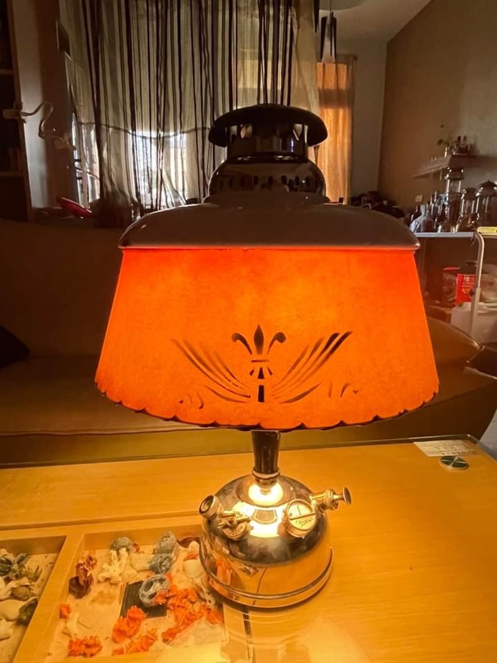

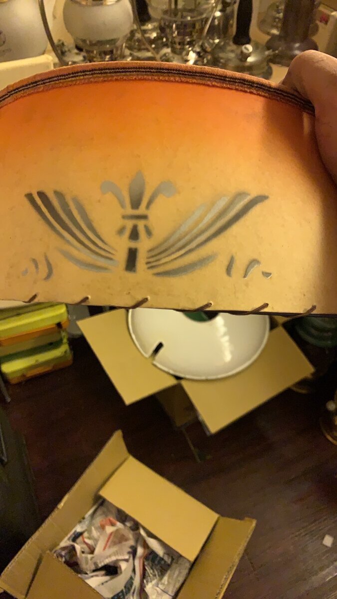

    So is this a Optimus 207 style?
    5F6AE8CE-ACFB-46CD-A1C6-A48C5395DC36.jpeg 82E6994F-3C73-4BDF-8BB8-AFAA2A4F6F51.jpeg
  10. Nils Stephenson
    3,414
    It certainly looks like it. How well does the shade fit in the reflector?
  11. Chung Taiwan
    Jan 30, 2021
    19
    Taiwan
    Pretty decent....

    Seems to be working well :thumbup:
