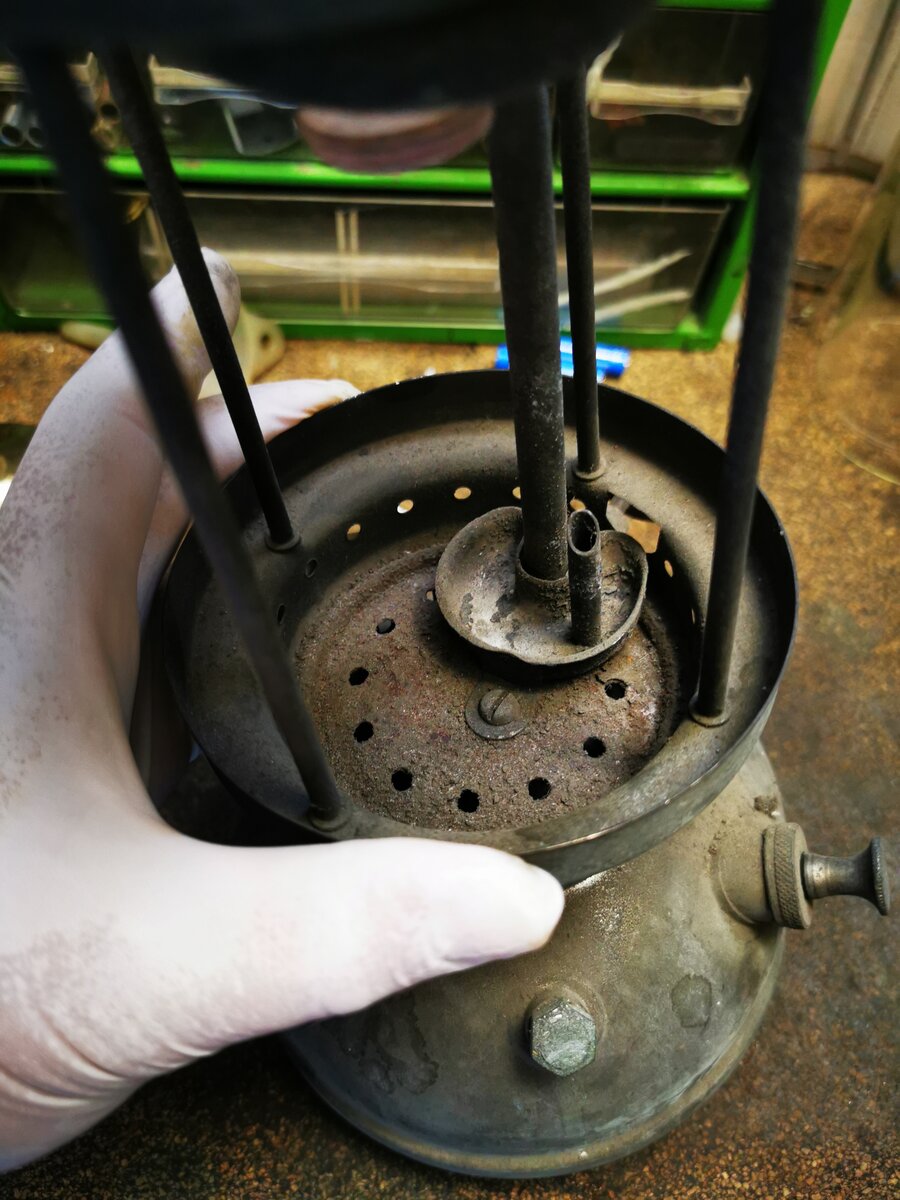

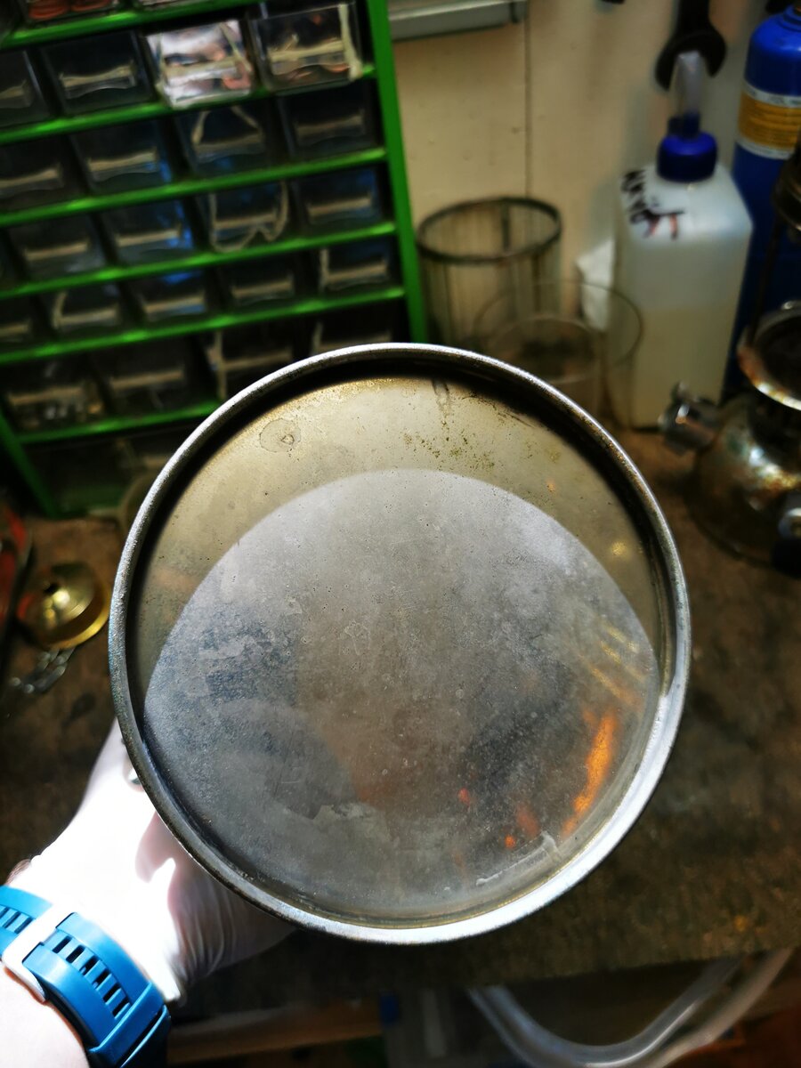

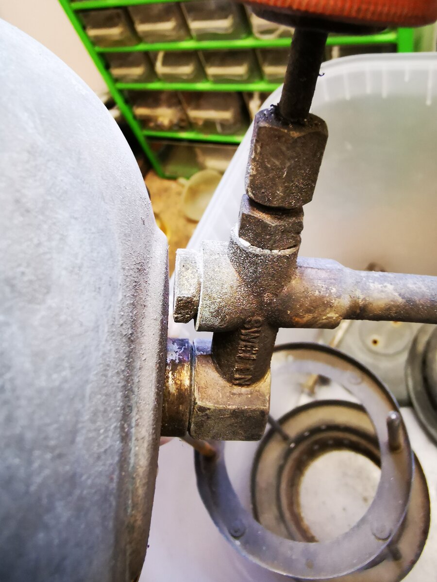

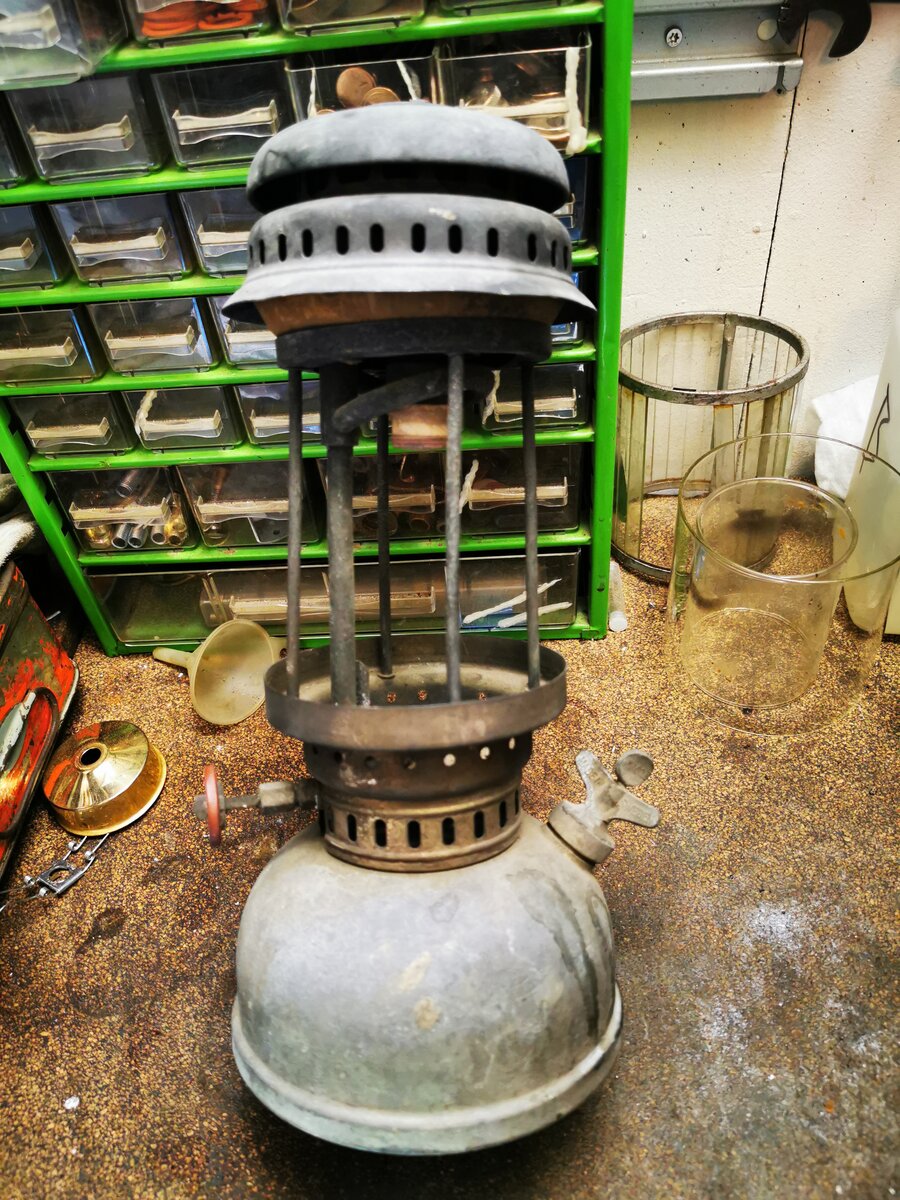

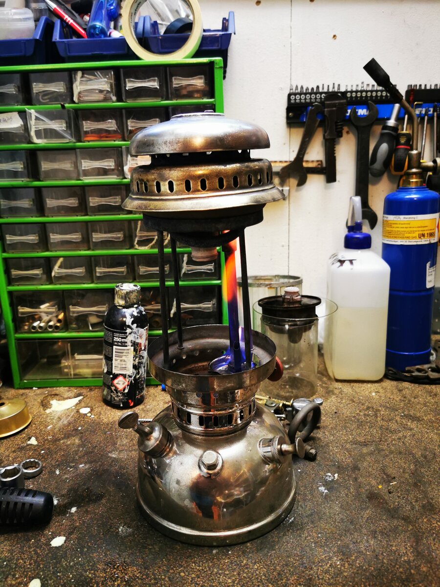

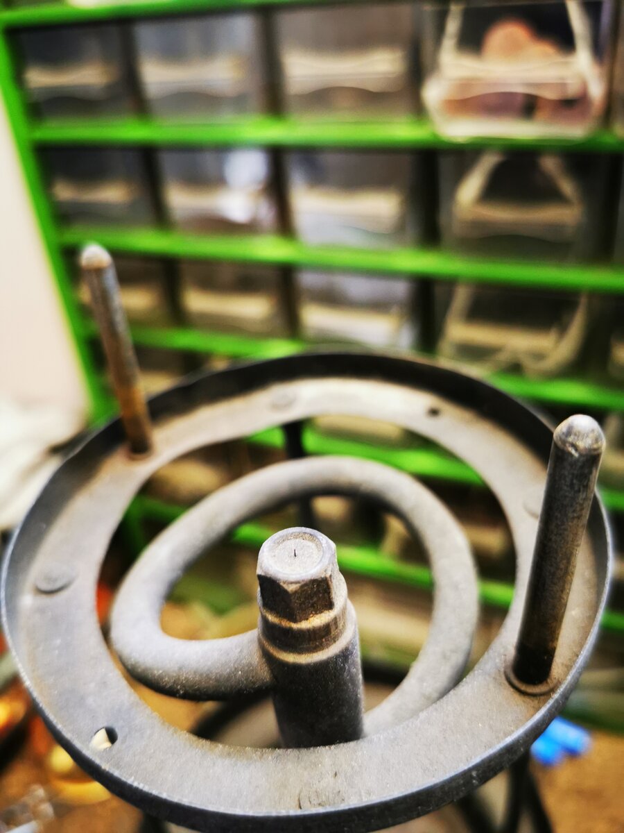

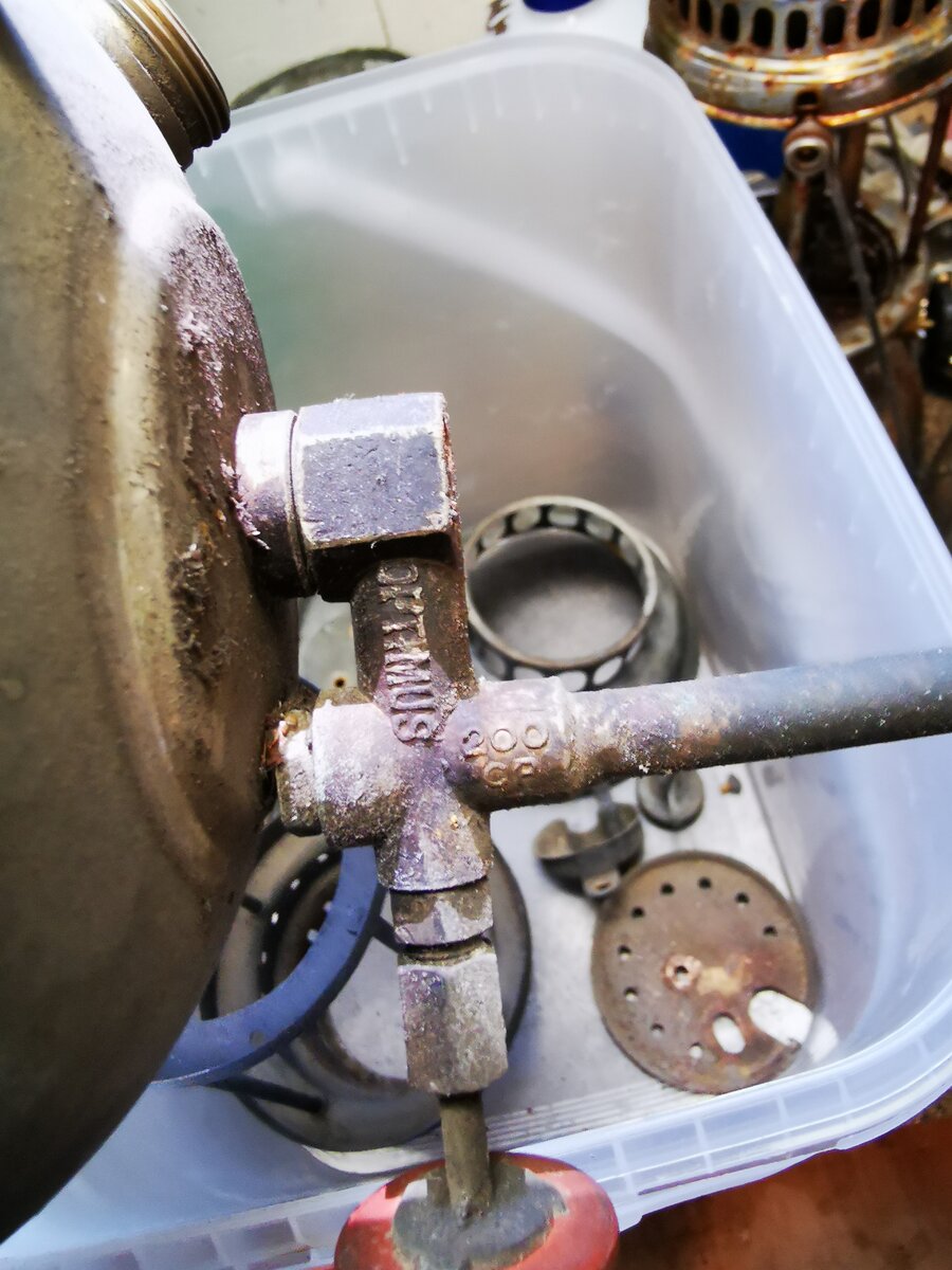

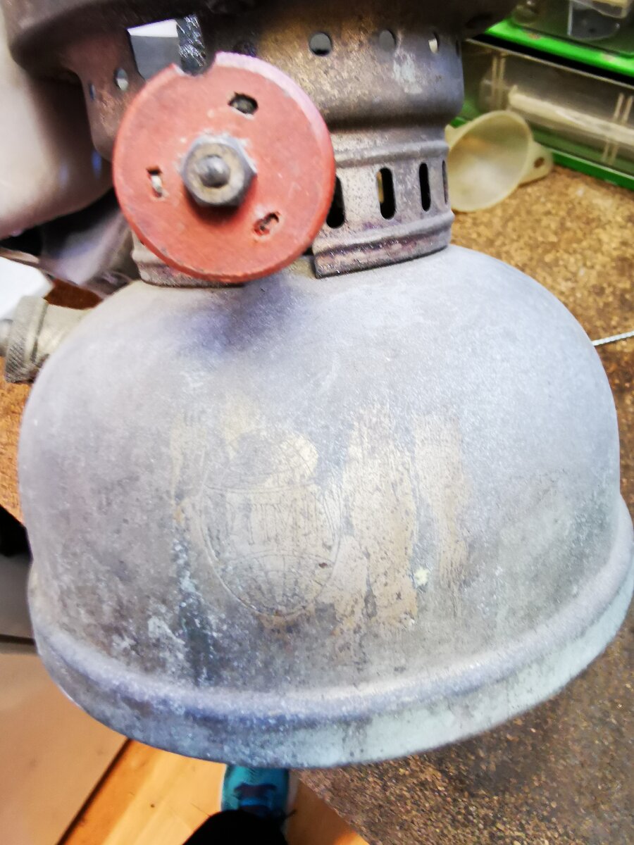

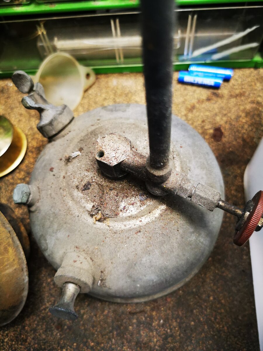

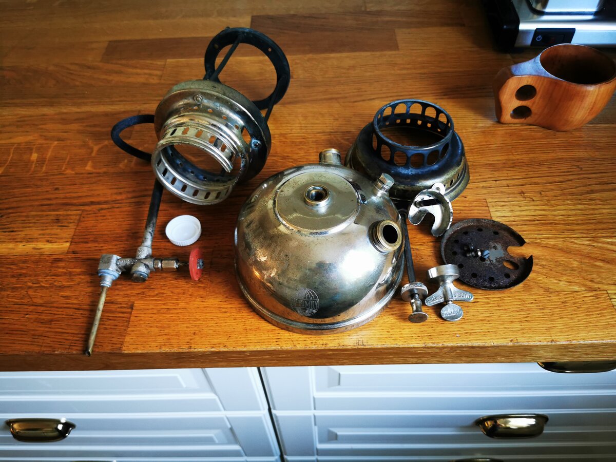

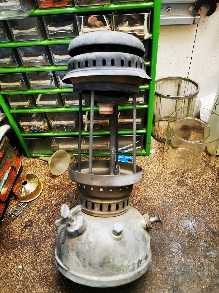

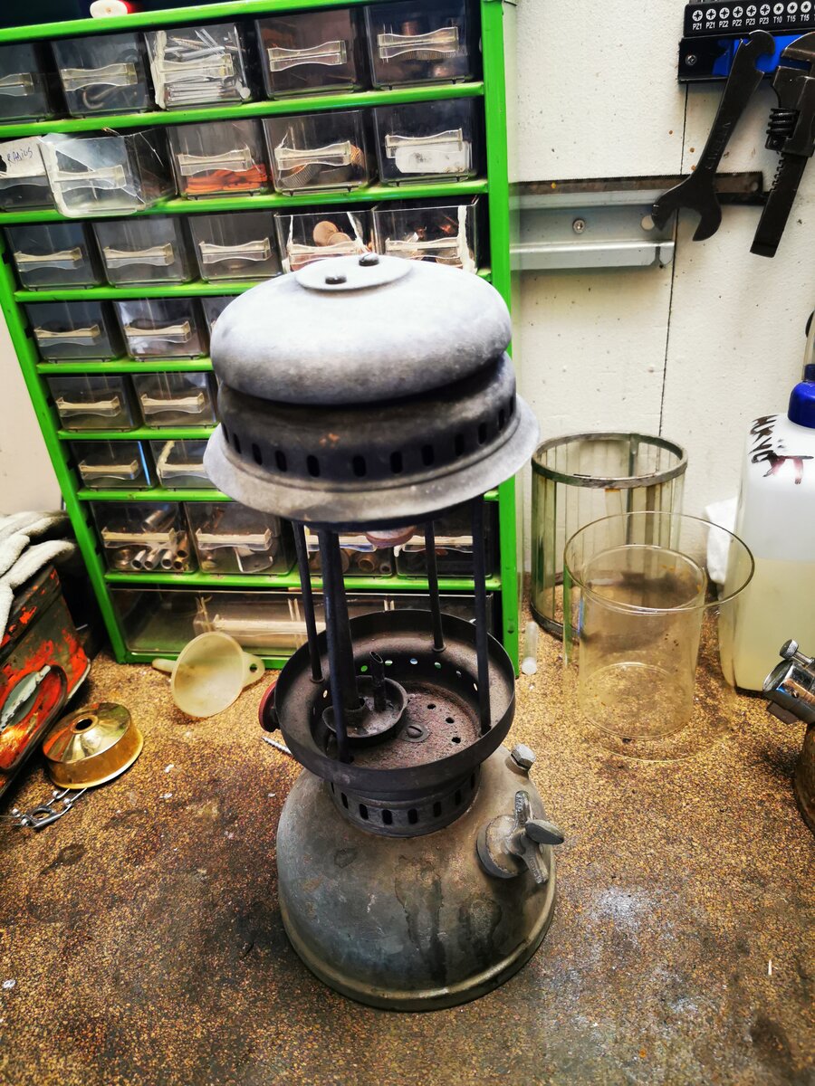

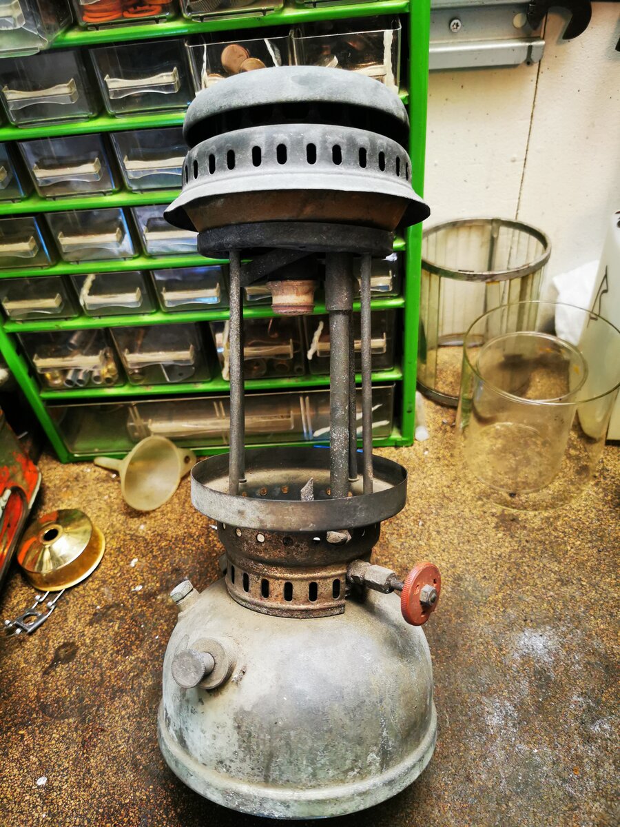

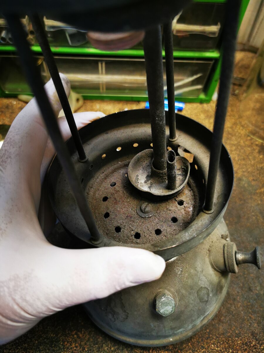

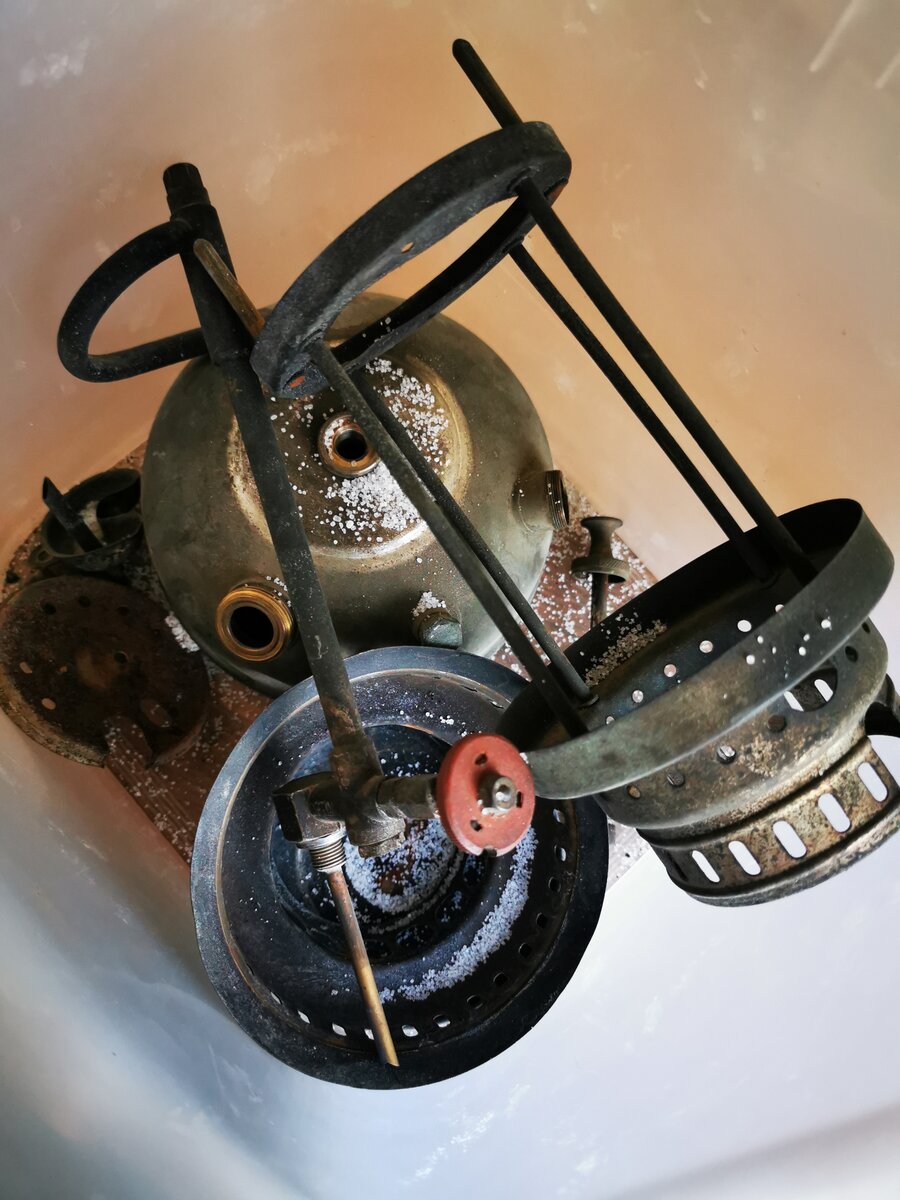

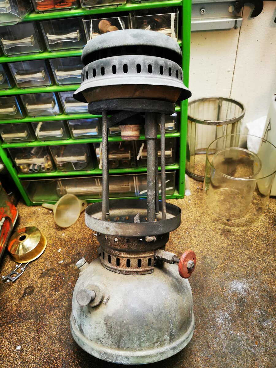

    Hi! I just got this Optimus 25x model. It was black and not easy to see something. The top has lost most of it's plating. The tank lost also a part of the plating. The cleaning process is on it's way.
    The generator i think it's a early one.

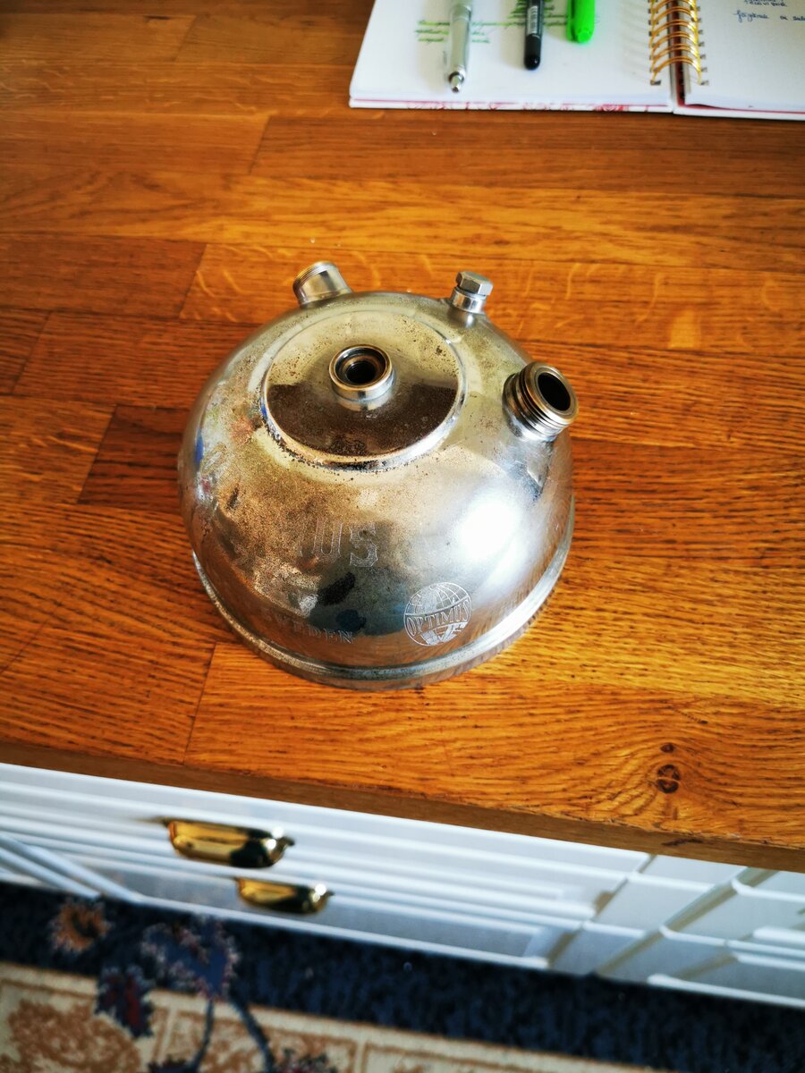

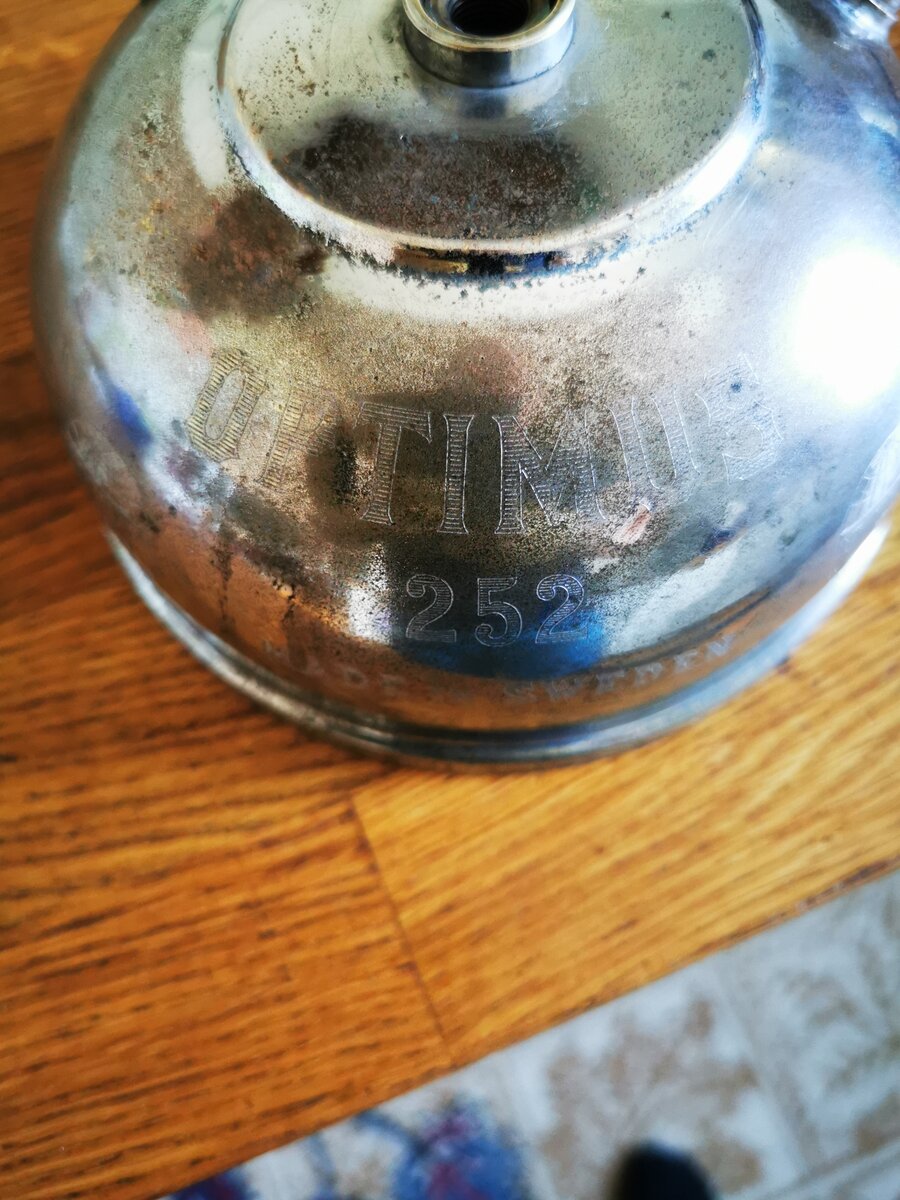

    The big surprise for me was the number on the tank. A 252
    Now i feel obligated to change the tank on my 252 with this one .
    More pics will come.
    Enjoy!
    Cheers,
    Francisc

    Congratulations to this find. It is not often you see the tank stamped 252, most of them has 200 on the tank.
    But it seems like a big challande to get it in working order.
    Bo

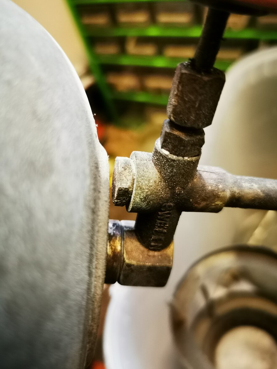

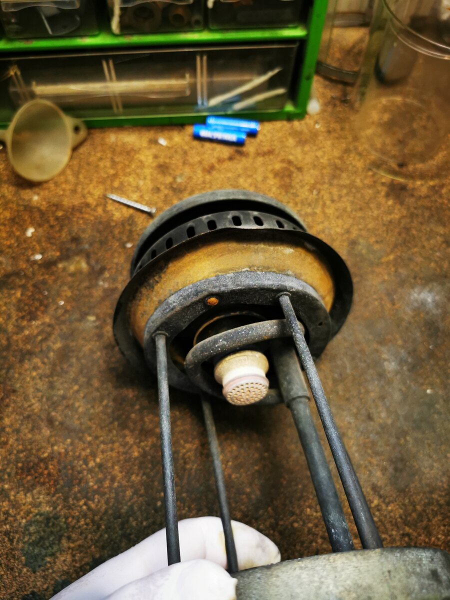

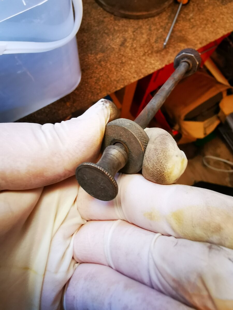

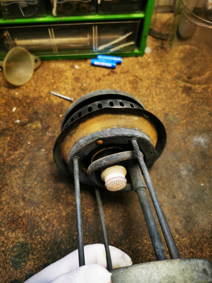

    In working order i don't think it will be so challenging but to make it a nice looking lamp it will be a challenge.

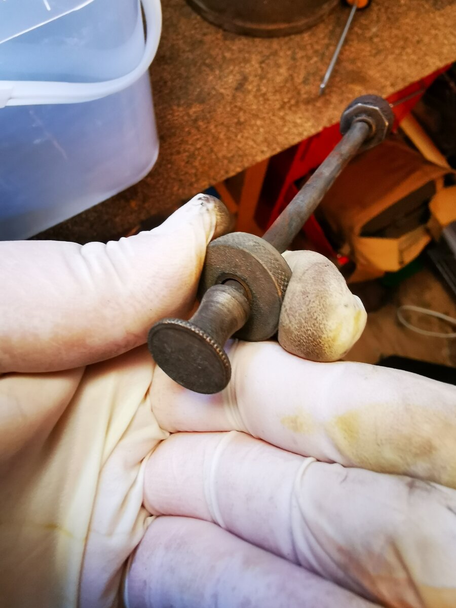

    The cleaning needle is working and the generator is the early model with access from beneath.
    Cheers, Francisc

  6. Nils Stephenson
    3,378
    That's a very interesting find. An early example as seen by the vapouriser. The big question of course is why the tank is stamped 252. In this configuration it should be a 255. the 252 was the tall lamp with wooden handle. It certainly looks like it has always been together like this, so the factory could have made a mistake. Actually the fact that there is a model number on the tank in itself is unusual. All the lamps I have seen from this era don't have any number on at all. As I said before, a very interesting find and an exciting piece of history.
  7. Francisc Masec Netherlands
    Jul 16, 2019
    194
    Sweden
    @Nils Stephenson indeed. I was looking today through gallery to see if the other lamps have a number on the tank (is then i saw yours optimus 265). The only tank with numbers was a "200" stamped on them. On one of @morphia post i wasn't sure about the number but i found the lamp in another post and it was 200 on thst too.
    I have a 252 without number, but as you write, it appears that this combination it was from the beginning. So i will let it be a part of history as it was found.
    Cheers, Francisc

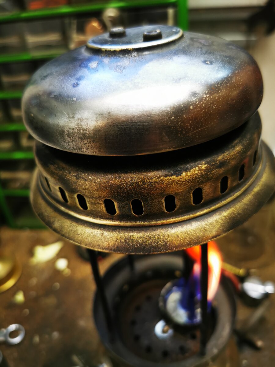

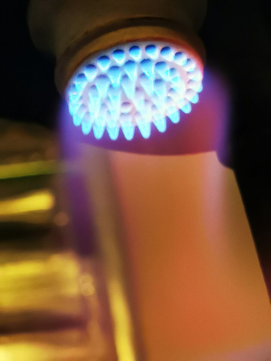

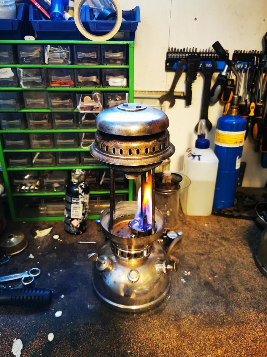

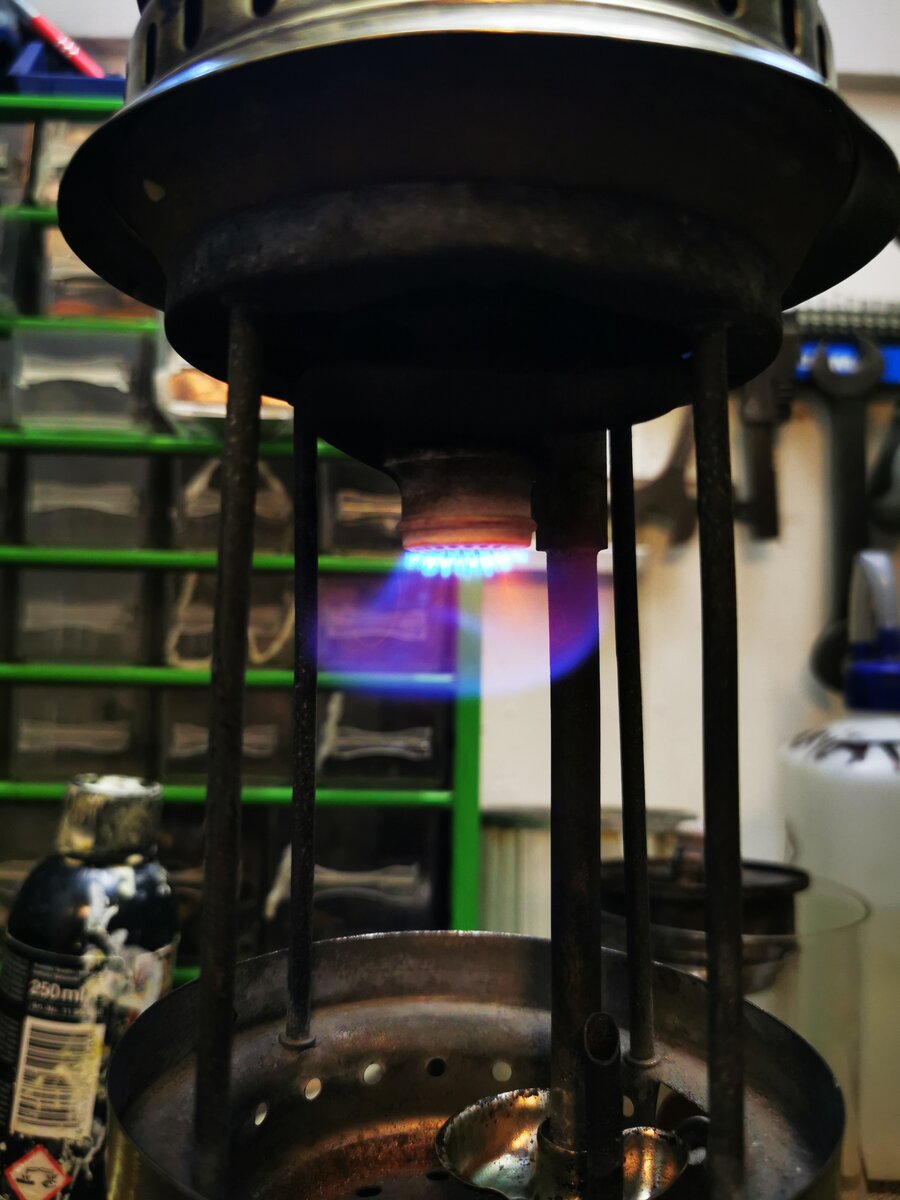

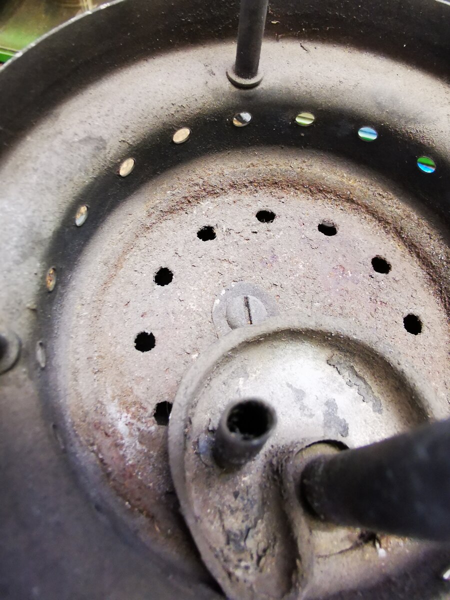

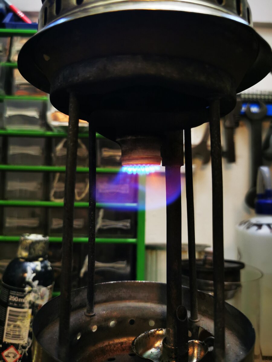

    The cleaning is going further. Today i puted on paus the cleaning to see how the vaporizer (without touching it) works. Is working very well
    /Francisc

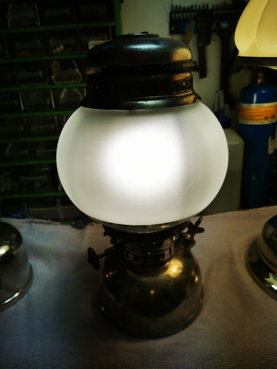

    IMG_20230616_145043.jpg IMG_20230616_152045.jpg IMG_20230616_152108.jpg IMG_20230616_152126.jpg IMG_20230616_152729.jpg IMG_20230616_153016.jpg
  9. Francisc Masec Netherlands
    Jul 16, 2019
    194
    Sweden

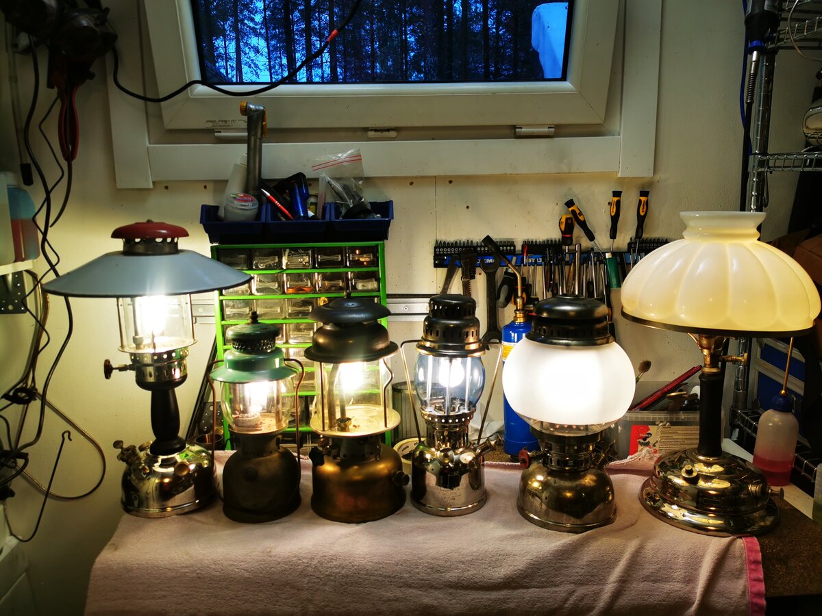

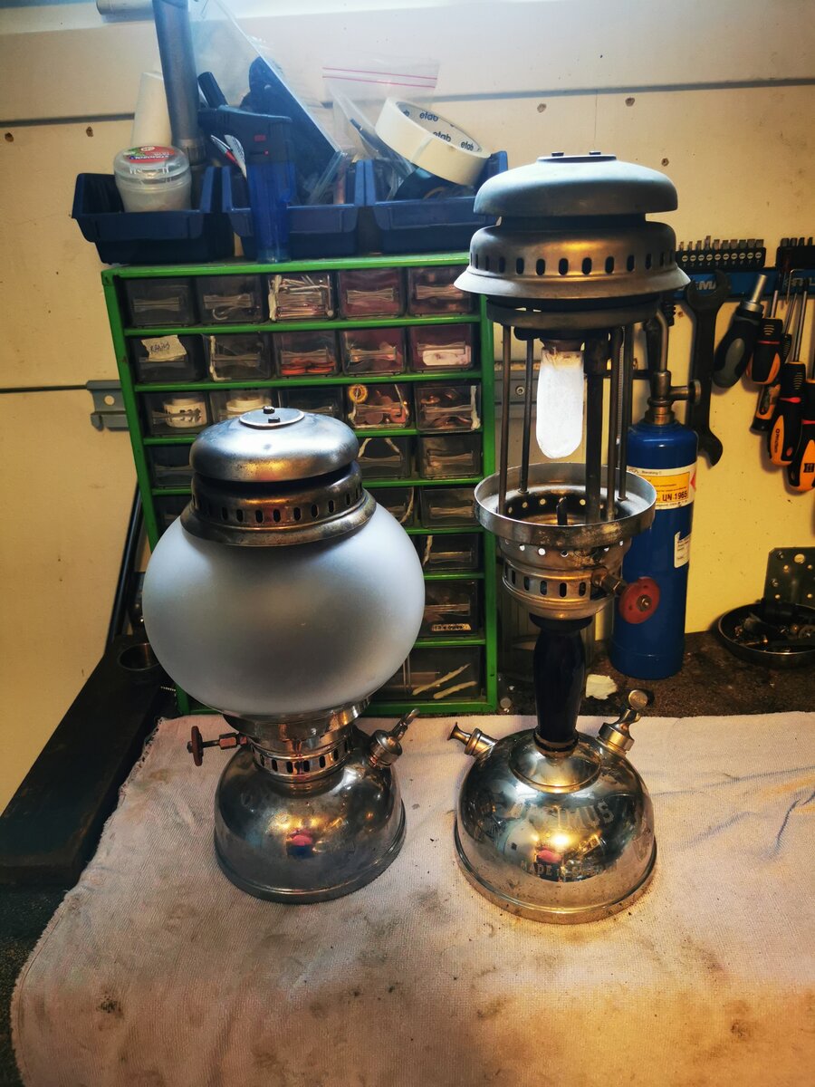

    Here is running together with some friends ❤️

  10. Fireexit1 United Kingdom
    3,518
    A very nice selection of lanterns ! and congratulations on a fine fettle :D/
  11. Francisc Masec Netherlands
    Jul 16, 2019
    194
    Sweden
    Thanks! Sometimes it just feels that they have too mych chat time on the shelf instead of glowing.

    So… are we settling on Optimus 255 as the model number?
  13. Francisc Masec Netherlands
    Jul 16, 2019
    194
    Sweden
    @Tony Press the tank says 252 but the build variant is 255
    So it's fair to say 255.
    Cheers,
    Francisc
  14. MYN
    Optimus 252 is supposed to be a table lamp rather than the lantern style in your pictures.
    No idea if there had be a mistake in the stamping. Anyways, you've got a rare example there.
  15. Francisc Masec Netherlands
    Jul 16, 2019
    194
    Sweden
    @MYN i agree. Here stands next to the lamp type what it should bare that number.
    Probably I'm gonna swap the tanks.
    Maybe the previous owner has removed the handle making it easier to put away?
    Cheers, Francisc
  16. MYN
    I think the founts(your earlier 252 lantern and the standing/pole/ table type 252) aren't exactly identical, particularly at the top sections. I don't think it is necessary to swap. If it is really a factory mistake, I'd just leave it as it is.:)
