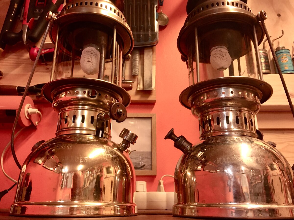

    This lantern gave me so much headache that it became masochistic fun to fix her.
    Part of my struggle is described in this thread: Optimus 300 J-tube replacement
    As post scriptum to that thread I can say that J-tube replacement was only partial success - running lamp was smelling kerosene, even though it was bright. It had also troubles starting.
    I was on a verge of dumping it - I mean selling.
    However - I developed a feeling to this old bugger so it became an object of few experiments.

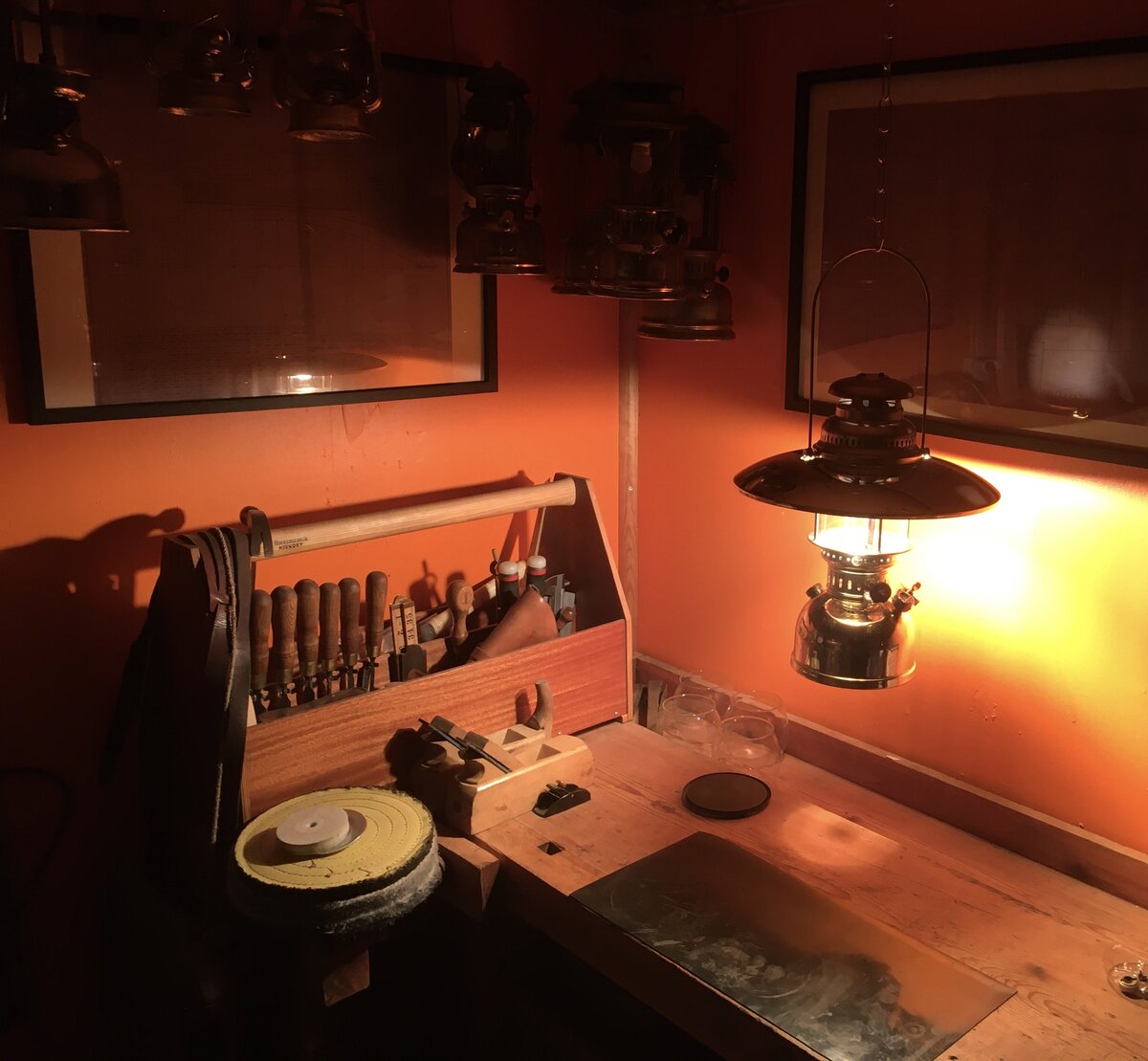

    Below is the effect - "money shot" of fixed lantern in polished brass.

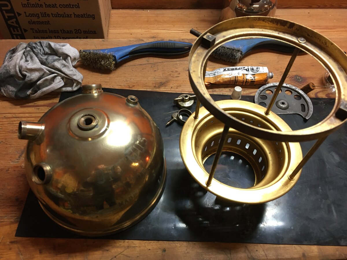

    Below shot shows the fount before the bath. You can see that nickel plating is worn in many places so I felt no regret.
    Other parts in moderate condition, just cleaned properly to avoid contamination.

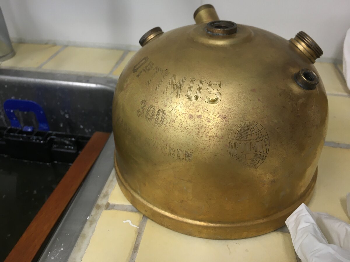

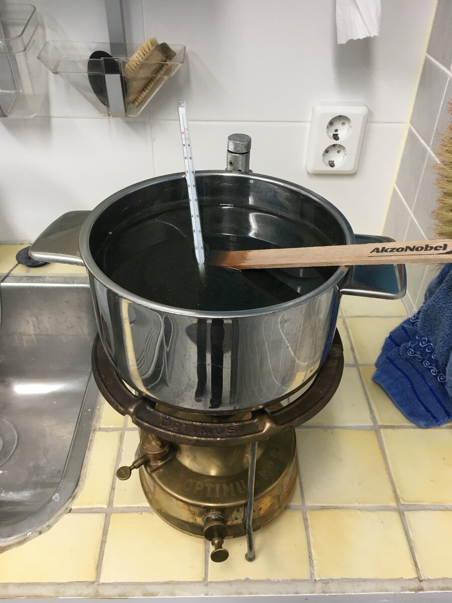

    Process temperature is 50-65 degrees Celsius, I used hot water bath to keep it in that range.
    Fresh solution has lots of sulphur which acts as a catalyst (I think)
    Below is the soup after 20 minutes. Sulphur is gone and I don't have any loose to add to the bath but the process goes further anyway, just slower.

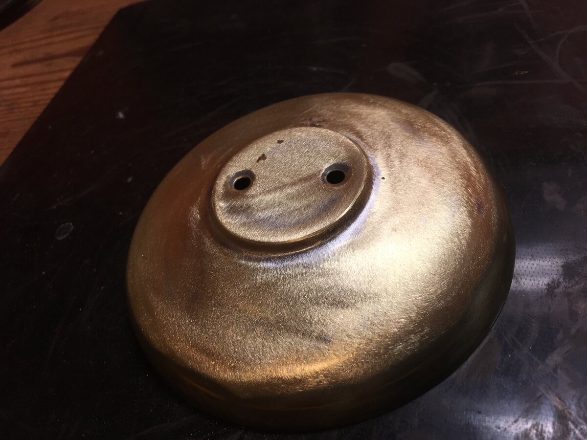

    After the bath nickelled parts are covered with grey slurry. There are few ways described in manual how to get rid of that. One can apply current in fresh bath or use some other (toxic) chemistry to remove slur but I found that hand rubbing (in proper vinyl gloves) takes care of that.

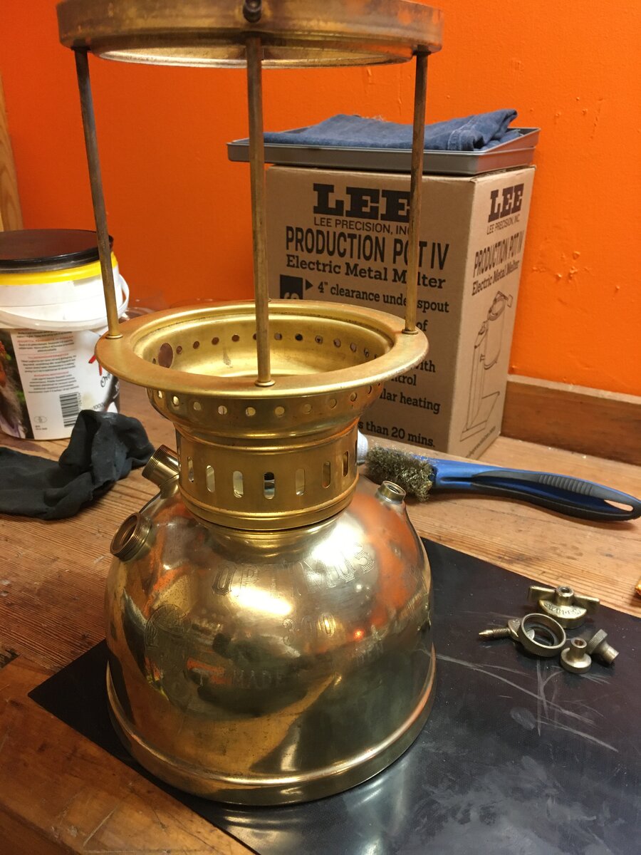

    Emerging parts are free from nickel, exposed brass is dull but clean.
    What is left is rinsing with clean water and proper wash. I use Cif, as you guys discribed in other threads. Then some standard elbow-grease with polishing paste. I use Petromax paste.
    Polished fount as opposed to bare brass cage.

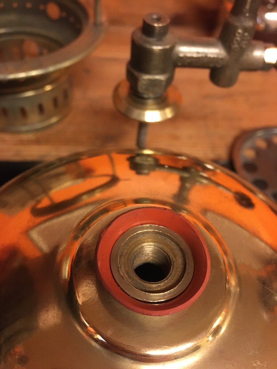

    Now there comes another hack: I had a small leak at vaporiser base, in the fount. It is a tiny puncture on the fount, very close to the solder line. It was repaired by someone before with silver solder but it got loose with time.
    At first I thought about repairing it properly and re-soldering but given the proximity of all vaporiser base and other openings I was afraid that heat will loosen everything around.
    Another option was epoxy - I work with several types of these and use one which can move up to 50% after curing up to 200 degrees C.

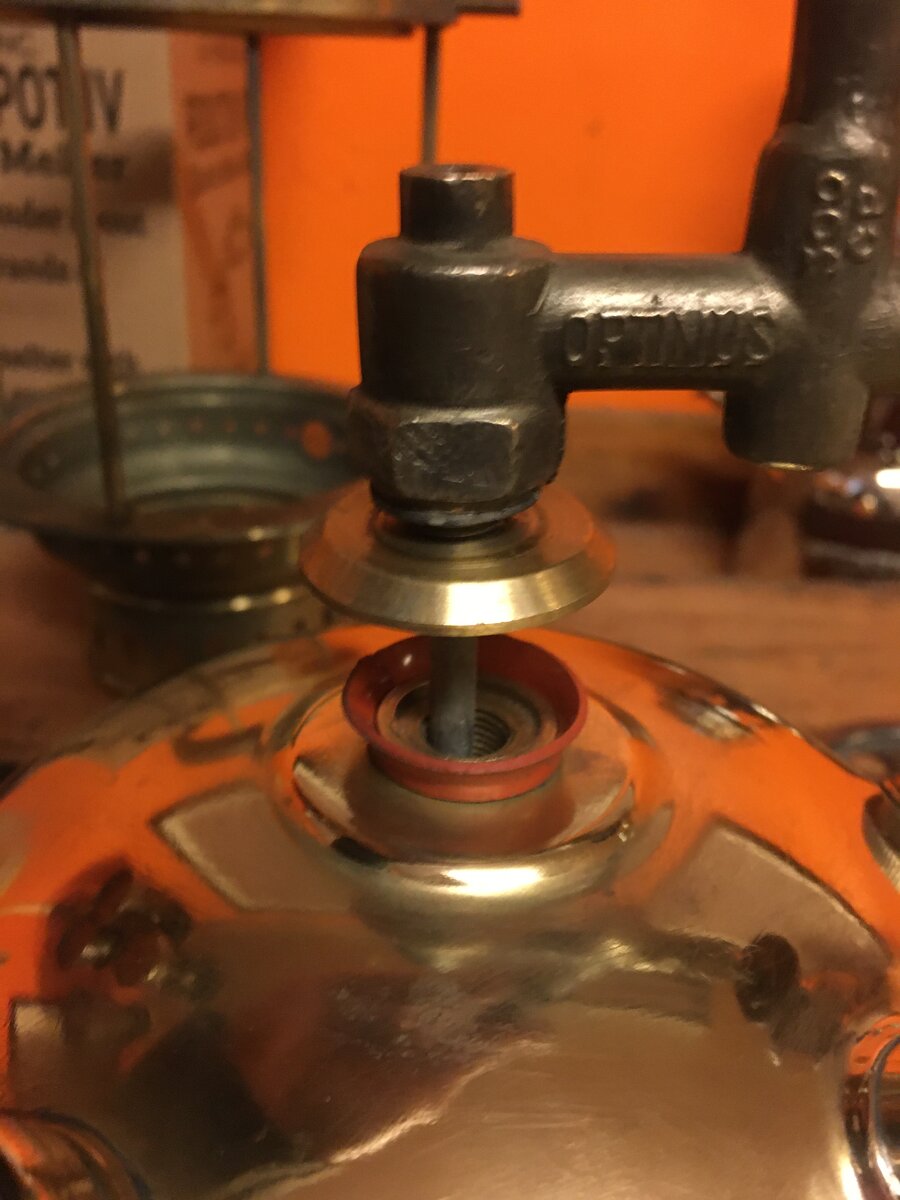

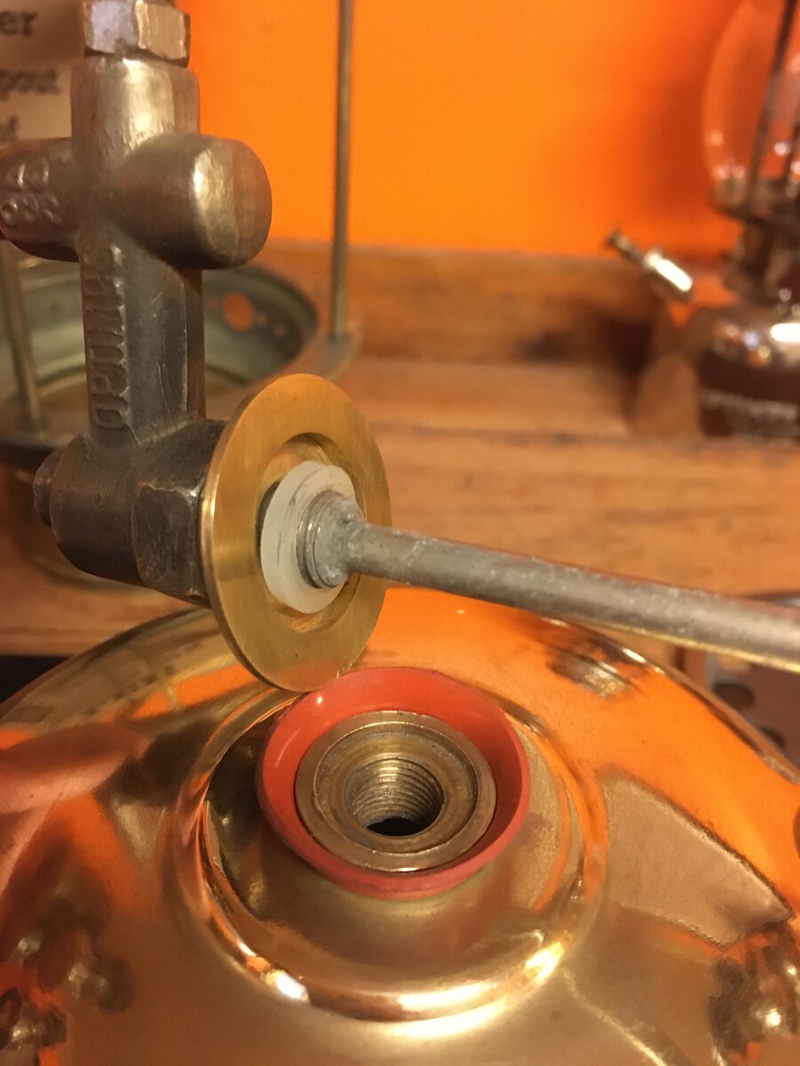

    But - being a lazy person I decided to turn a small brass ring and seal the whole area with temperature-resistant silicone washer.
    Recess in the brass ring accommodates another washer which seals the pick-up tube, instead of traditional lead. I use thick Teflon washer here.

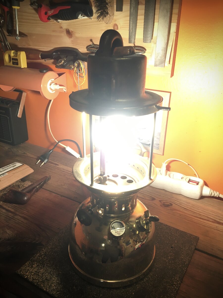

    Assembled components.
    I have a soft spot for pressure gauges so I equipped the lantern with after-market one from hytta.de
    The lantern is now equipped with another vent which I stole from my other Optimus 300. This looks to be a mix of Optimus 350 J-tube assembly with Optimus 300 vent.
    J-tube size is much different from original I had so I was a bit sceptical if it will work with the same jet as before. Turned out it works fantastic!
    With this modification I can fine-tune the amount of mixture - full throttle seems to work best. The lantern is very bright now and there is absolutely no smell of kerosene!
    Vent parts went on separate, smaller bath. I use my darkroom sink to keep the chemistry out of the kitchen. Optimus 5 is doing its job.
    I use water-bath again - this time water is between walls of this old Italian pot.

    Here are Optimus 300 brothers. The right one, plated, is yet to be pimped.

    The lamp is now working for at least 50 hours. No smells, easy ignition, no leaks. Life is good.
