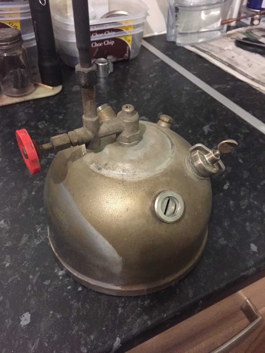

    There have been a couple of variations over the years, so it could either be glass or plastic. A picture would help.

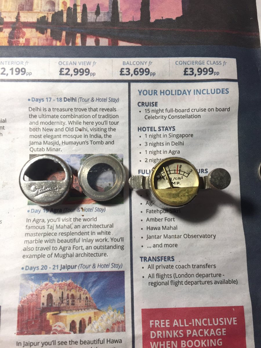

    @Nils Stephenson
    This is the offending article, i expect it probably won't be that easy to replace but hopefully someone will come up with something.

    @MG, that's actually the fuel level gauge but it looks as if the workings are missing. There should be an arm pivoted on the underside of the plate with slot, the arm extends into the tank and should have a cork on the end which will obviously raise the arm according to the level of fuel, the part of the arm which protrudes through the slot is bent over 90 degrees thus providing a visible indication of fuel level. The original window would have been glass.

    Hi Henry, thanks for that, its not the greatest of pictures but it looks like all the workings are there, i didn't check until now, i just thought it was a pressure gauge but can now see the cork on the end of the arm etc, it is sitting a bit high considering there is no fuel in it so more investigations are needed, i don't suppose you'd know where i could get a replacement glass and a new washer from do you?

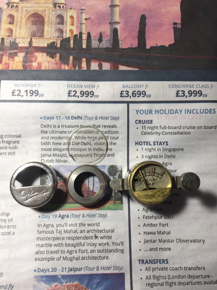

    I don't know if all 1550's have the same sized window but mine is larger than the 300's for sure, if not that clear, the 1550's window is sat over the 300's in the first picture,

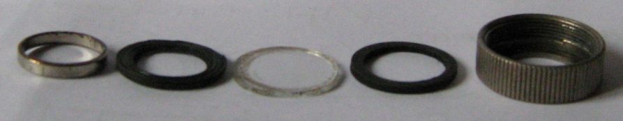

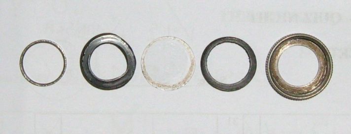

    @MG I should have have logged on here before I started dismantling and measuring. No matter, your question has been answered. Although the rubber washers on my example make a good seal, they are somewhat misshapen which meant a little guesswork with the sizes, so thanks to all who provided accurate measurements.

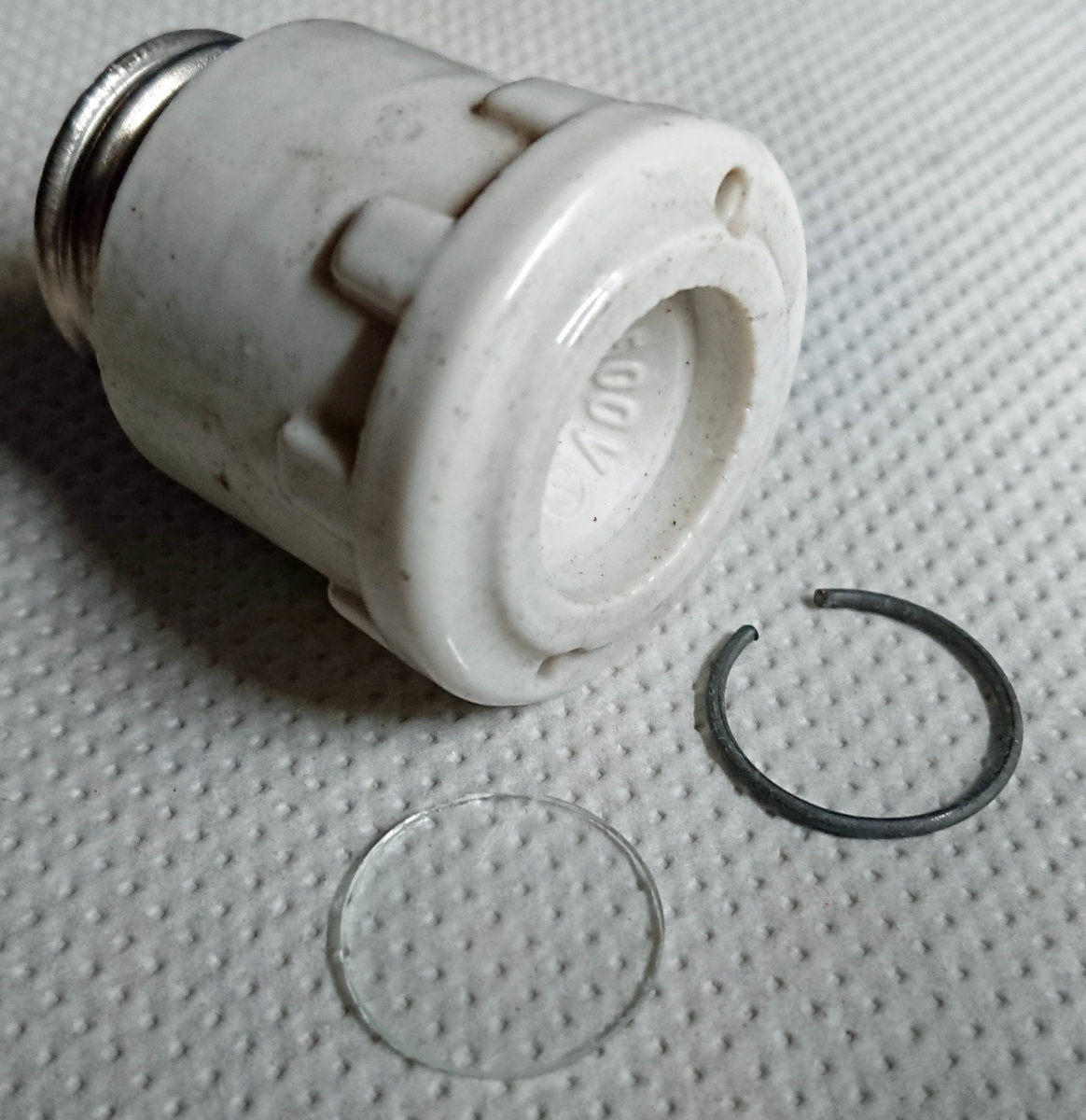

    I have used glasses from the old type of ceramic fuse holders we used to have here. They are still present in many applications, and houses that hasn't been upgraded to more modern circuit-breakers.
    Below is one I grabbed just to show.
    The glass is 19.5-20 mm, and the thickness on this one is 1.3 mm, so they fit right in, and I don't think the slightly thinner glass is an issue. If you're worried, you can always use two.
    I also bet there are variations in thickness depending on manufacturer. I think I will explore this at work tomorrow, because there these are abundant.
    These glasses has worked a treat for me.
