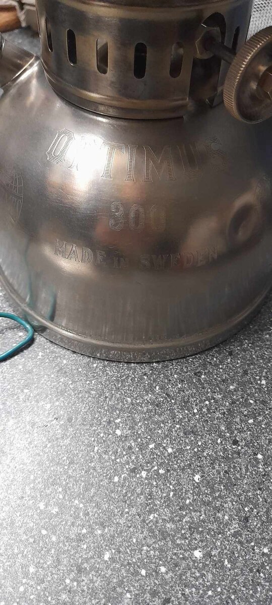

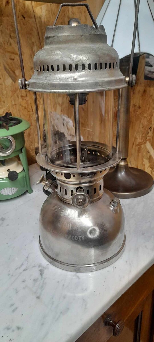

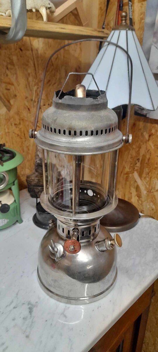

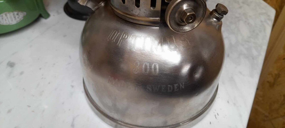

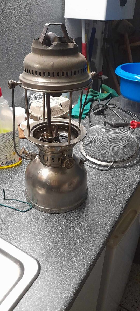

    Last week I could buy this Optimus 300 pressure lamp. ( gasoline)
    It needed attention.
    I cleaned the tank in an ultrsonic bath and cleaned and inspected all the seals.
    The lamp does well ...after a good rub the shine is nice with some patina..the copper underlayer for the chrome can be seen in some places.
    The glass was broken. For this time I have put a glass in with no mark on.

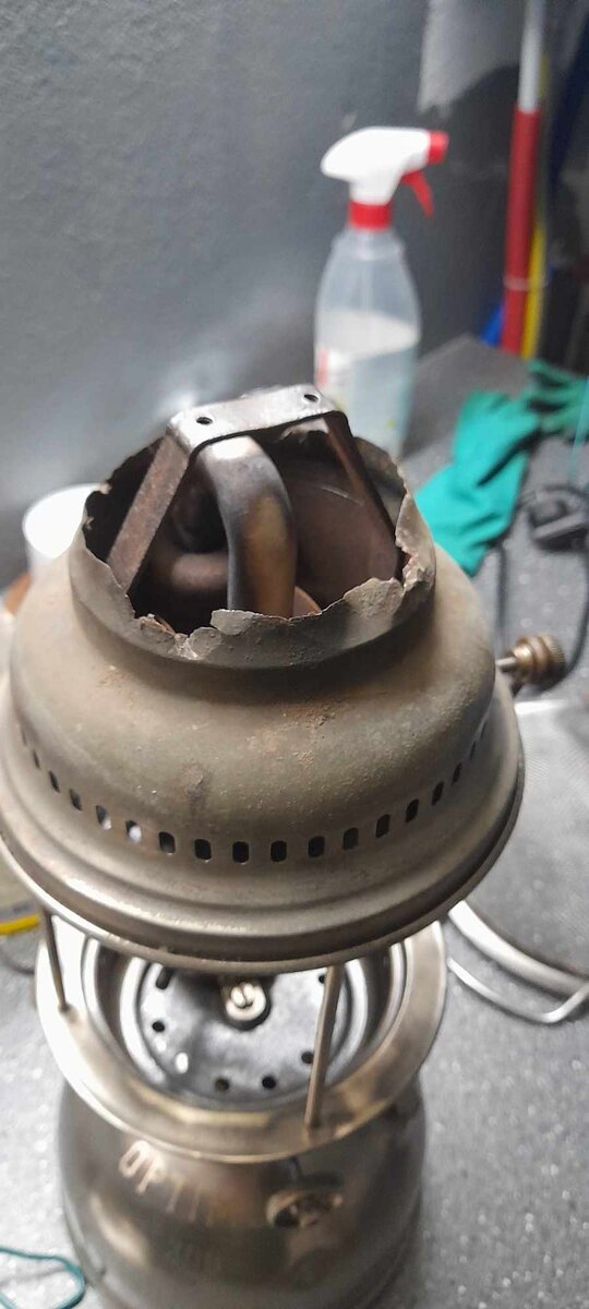

    The top vent cap needs to be replaced. This one is still gonna be a search to find.
    The tank is close , so that is good. An under water test made this clear.
    The leater for the pump I replaced it for now with a leather from a petromax...that leather is a bit too big I think but I will order a kit for this lamp that I could find online but is not cheap.
    Fot the whole thing...after the work I have done this is a nice lamp.

    The 300 is an affordable and well performing lantern.
    I have a later made model.
    Matti

    Nice find. The 300B is not that common.
    The one I have has had a kerosene jet fitted and runs on kerosene. I'm not a fan of the pump not having a positive shut-off when using petrol/gasoline.
    The top from any mid 1930s 300 will fit.
