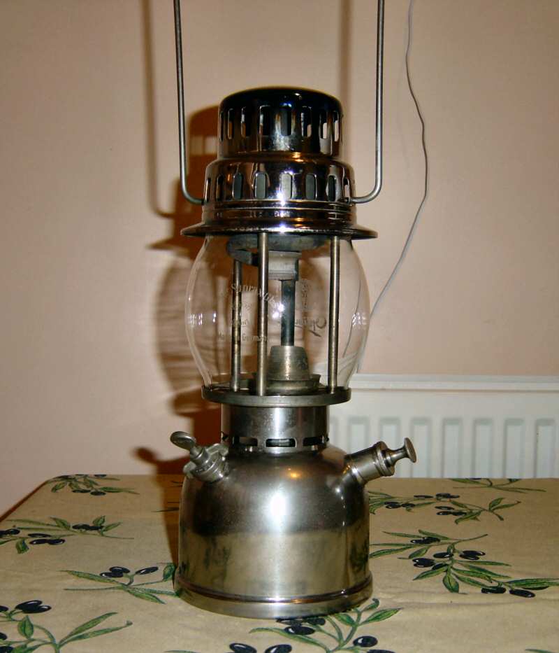

    I've just picked up a rather nice Optimus 930 300CP for £10 so feeling rather pleased with myself, but only having had Bialaddins and Tilleys in the past I think I may need a bit of hand holding here!
    I know exactly what the lamp is as it's printed all over the tank so no prizes for identifying it, but what about dates?
    Also is there anything specific to these lamps that I need to look out for when getting it going that I wouldn't need to on a Tilley/Bialaddin?
    Are they easy to get running?
    What mantles do I use that are easily available in the UK?
    Finally, as you may be able to see from the picture the original globe is sadly cracked from to to bottom. OK for display but I wouldn't want to risk running it with that. So, is there a suitable replacement globe that is available in the UK that I can use for running it?

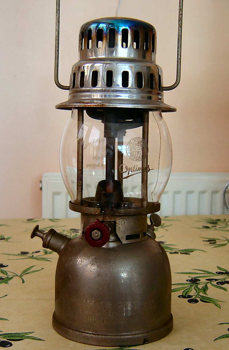

    Thanks for the info...
    Pleased to say the little lamp cleaned up quite nicely.

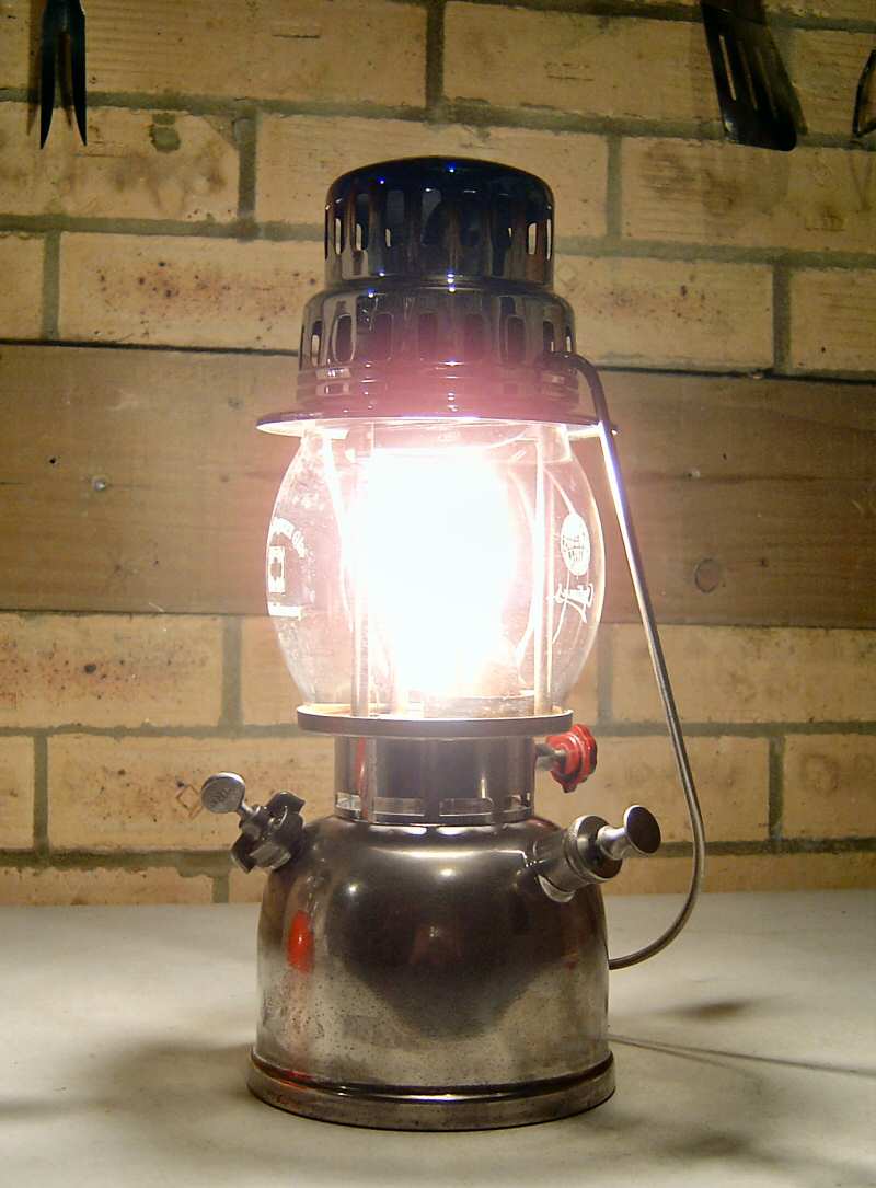

    It lives!! :D/
    Aside from the cracked globe there are two other issues:
    The preheater cup leaks so you have to be pretty quick otherwise you lose all the spirit. I'm not quite sure how to fix this.
    The other is that I need a new washer for the filler cap. Is it the same as used on Optimus stoves?
    Other than that I had it running a fair while with no issues and it is BRIGHT! :thumbup:

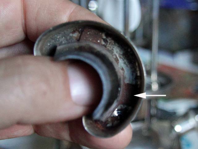

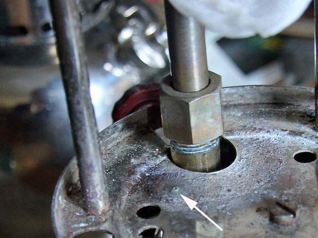

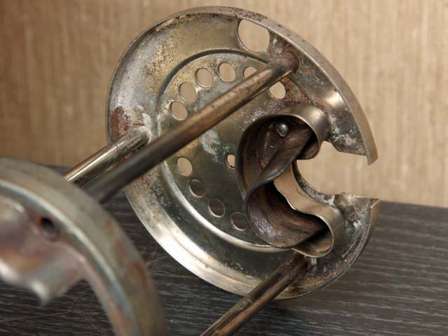

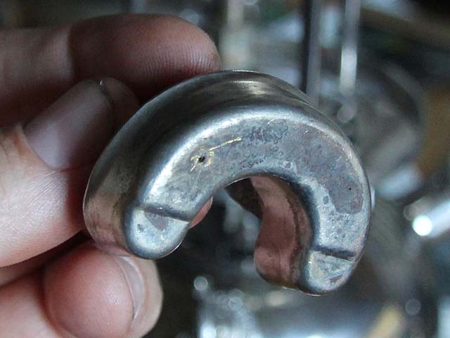

    I dug out another 930, and as it happens, it got the same problem. A little pinhole just where the spot weld used to attach it to the bottom plate of the globe cage.
    Here's the underside of the cup, with the hole clearly visible. It didn't leak any alcohol to speak of, but it did of course seep a little:

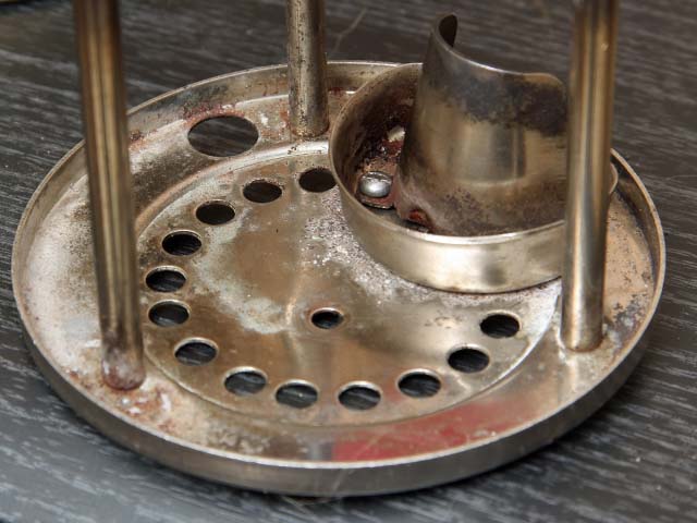

    The inside of the cup. The spot weld is directly under (or probably also through) the small "feet" of the vertical shield:
    And here is a little dimple visible where it used to attach at the bottom plate of the globe cage:
    I will drill a tiny hole through all three parts, and then just simply screw a tiny stainless sheet metal screw through it all.
    Or perhaps I'll go for a small M3 screw with a nut instead. I've not decided yet.

  27. Carlsson
    3,963
    Then you won't have to wait more. :lol:
    I tried it directly after I mentioned it earlier tonight.
    It took less than ten minutes. A very quick fix. And a fix it was because it worked very well.

    I've now done mine too with a slightly modified procedure...
    I used M2.5 countersunk screws and in a preemptive strike did both sides. Before fixing the cup to the frame I rapped a small length of soft solder around each of the screws in the hope that once done up they would form a sort of lead washer sandwiched between the cup and the frame and help seal any leaks.
    I screwed the whole thing to the frame with two M2.5 nuts on the underside and did them up very tightly.
  30. Carlsson
    3,963
    I only used one since it only was one that leaked. To just hold the cup, it's of course enough.
    I also intend to swap the sheet metal screw for a screw with a nut. It will make it much easier to tighten all together good. I will use M3 as I mentioned before.
    Some sort of washer is probably a good idea.
    Like the soft solder Gneiss suggest. It will form nicely, and as long as it don't have a too low melting point, I figure it should work well.
