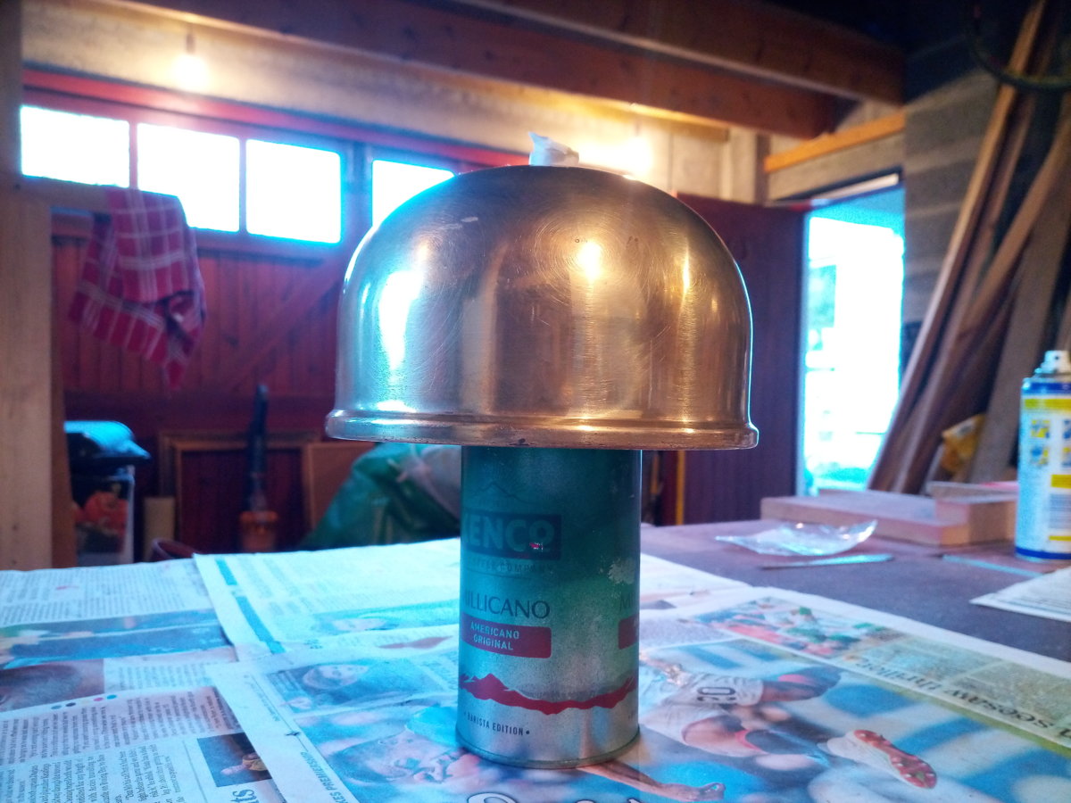

    Having stripped the remains of the original paint I use GSR to clean the surface and then key it in with fine wire wool. After this I wipe it down with acetone to remove any grease or fingerprints. I cover the holes with masking tape as I don't want paint inside the fount or get overspray in the threads.
    I use an old coffee tin to stand the fount on while I'm spraying as this helps in two ways: I can use it to turn the fount round, and secondly it keeps the fount off the work surface. *NOTE* I generally leave the base of the fount the original colour for future reference.

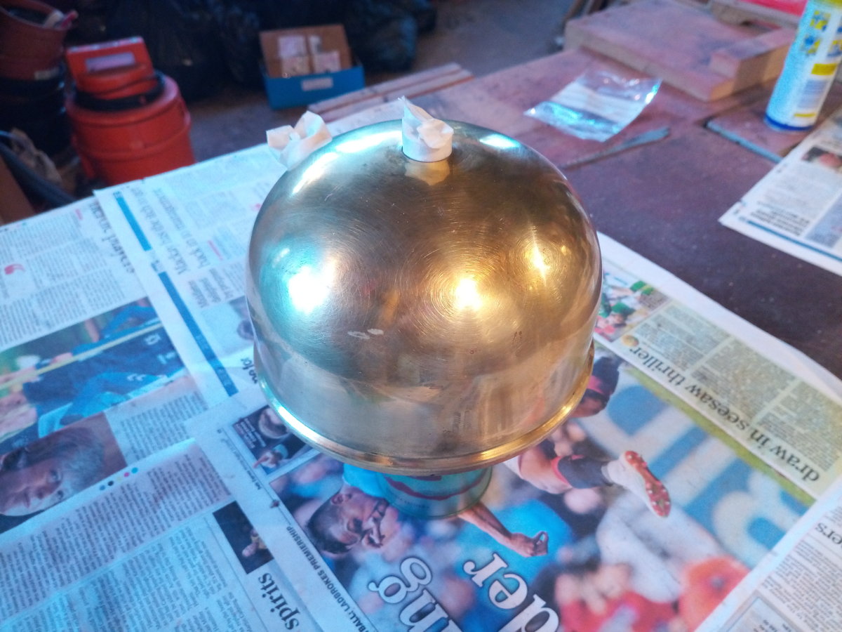

    The next two images show the surface before the paint has built up sufficiently and then afterwards. Often, the orange peel effect is simply lack of sufficient paint to form the liquid layer.
    Hopefully you can see the difference.
    The trick is so keep this smooth liquid pool building until it's covered the entire piece.

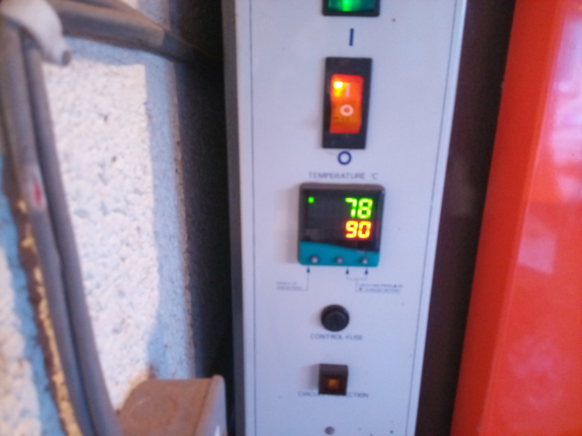

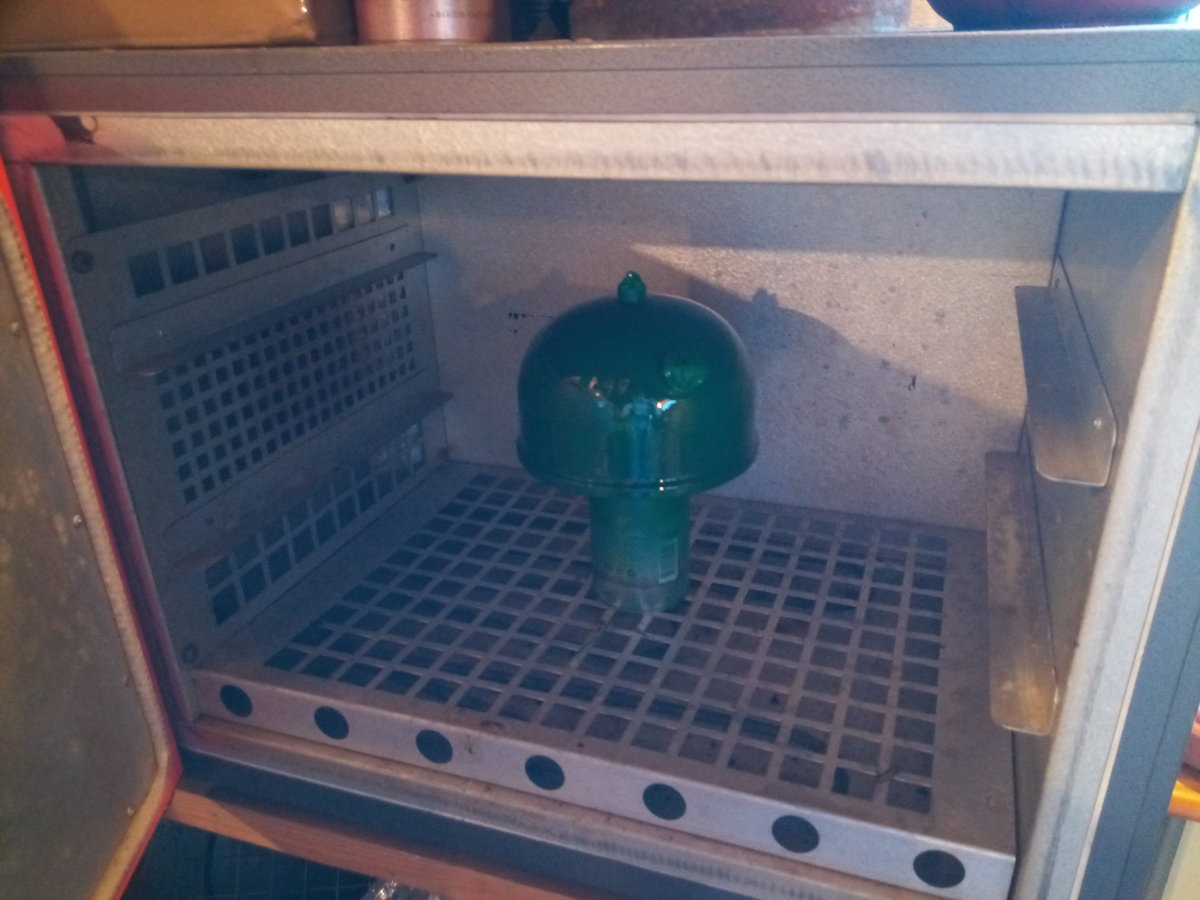

    When I was done it went into my oven for 20 mins at 90 deg. The masking tape doesn't burn in the oven.
    This is my oven but I was given it which is amazing as they cost a small fortune... and it's only a metal box with a heater in it!

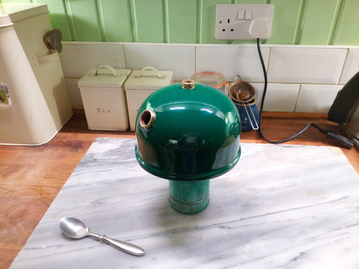

    After a second coat following the same rules it ended up like this...

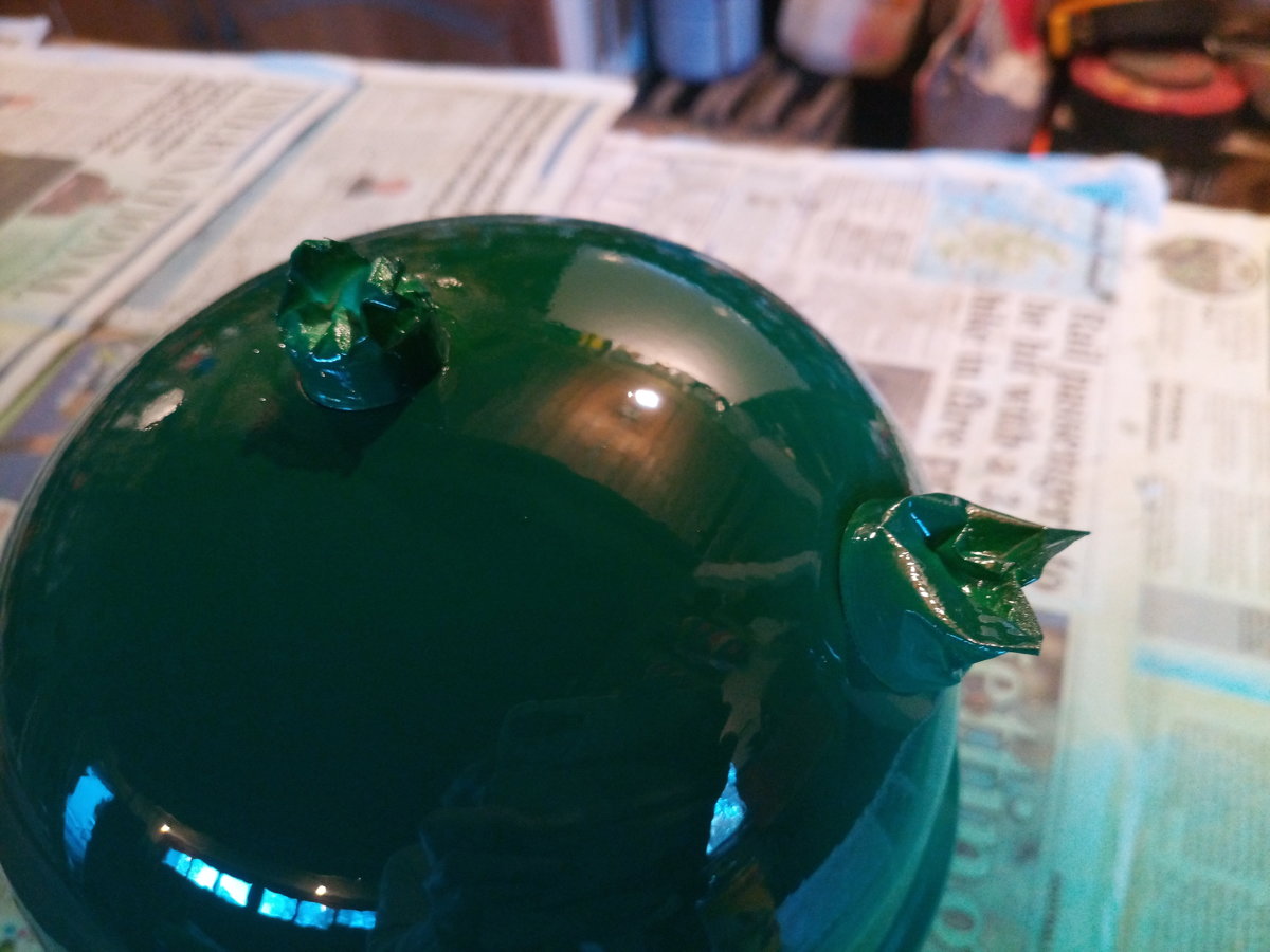

    Runs...
    If you do have a run and you see it happening act quickly and you may be able to save the paint job. If you can, swiftly upend the work so the run is pointing upwards and try to get it to go back the other way. If you're extremely lucky you may be able to rescue the situation. I managed to do it once and after two more coats the run had become invisible!
