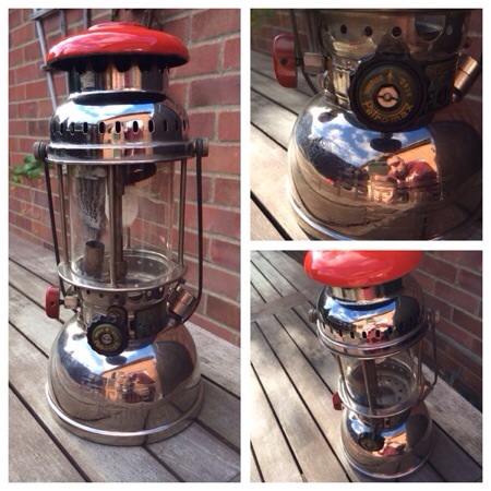

    I was going round a fleamarket today when I came across this absolute beauty! Was marked up at £18 and I haggled it down to £12...
    Just lit it and it all seems to work fine. It's my first pressure lamp so wasn't too sure what I was doing but found some petromax instructions online and it worked a treat!

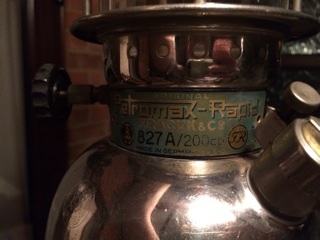

    This is Petromax or maybe an Aladdin Petromax 827 and a better bargain than you know. That lantern dates from 1937 to 1941 and in that condition is seriously rare. It has a label on the collar which will tell us what brand it is and the model number. When found in the UK these are normally labeled as Aladdin-Petromax. They were however sold in the rest of Europe as Petromax. A shot of the label will be good if you can please. ::Neil::

    Hi Neil,
    Here's a picture of the label for you.
    Thanks for the extra info :)
    Kevin
  6. Mackburner
    Now that I did not expect. A Racek Petromax with a model number, 827A, that I have not heard of before. This one gets added to the record and so far is a unique example. I could do with some bigger images of this one if possible please. I will PM you with my email. ::Neil::

  8. Mackburner
    I no whave some better images of this and it is a 1939 type 827. It seems to be a pretty standard 827 and the model number is probably just a Racek number rather than a Petromax factory number. Still an interesting lamp and from that period you don't often see them in such nice condition. ::Neil::
