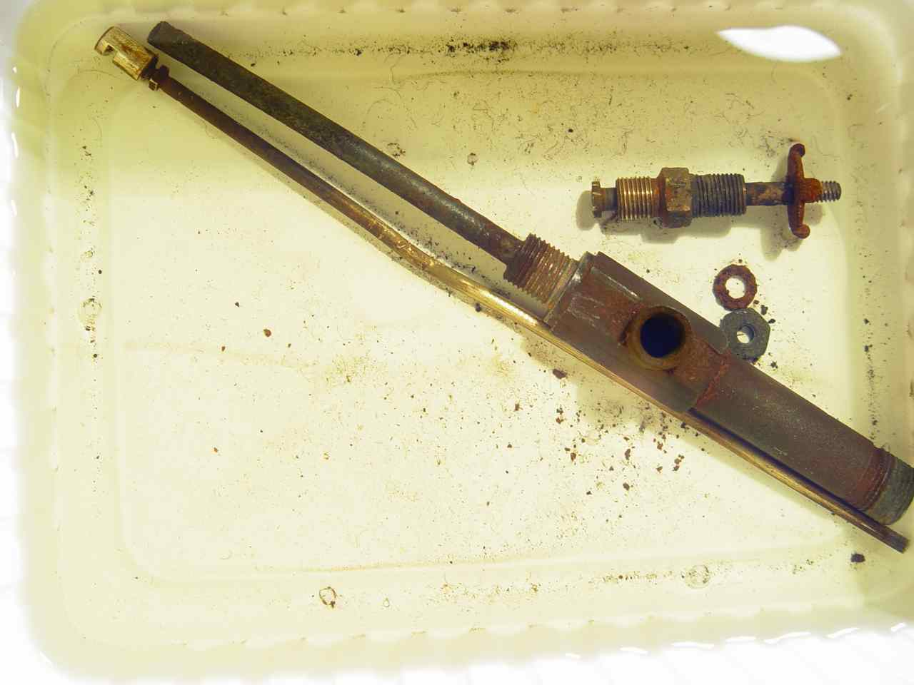

    I started renovating, and fixing a Petromax 2826.
    I'ts bad condition, but i'd like to save.
    When i dismantle the vaporizer, i saw the rod is missing the neddle, and another end is broken.. the vaporizer's material isn't brass, it's steel of course full of rust :(
    I het up and drop the water some times, after is pulled out the stuck part. So the tube is clear, but i dont know, not missing nothing?
    Can you help me fix my 2826 with some pictures?
    I'd like to see what the originally vaporizer, all parts.
    What do you think, if missing some parts, can i change it complete for this?
    http://www.pelam.de/product_info.php?cPath=30_50_87&products_id=181

    Hello Roy
    Many people used acid to clean generator, acid will remove the rust. Perhaps you can buy these small round steel brushes, they are very usefull in cleaning Pmax generators. You can also heat a generator up till it's glowing red and then put it in cold water, this will loosen the dirt in the generator.
    I hope some other can place pictures of a Pmax 2826.
    regards Henk

    Hi Roy
    Its possible to remove corrosion another way, but I have only knowlegde with ironstuff.
    1. Take a plastbuckett (10 l) and fill with water.
    2. Fill in and stirr out a cup of salt.
    3. Putt 1 or 3 pieces of scrap-iron in the water and connect them with wire.
    4. Take a plast-bar, ex. a cloth-hanger and put it across on top of the buckett. Tie your rusty subject to the bar so it is covered with water.
    5. Take a battery-charger, not a battery, and connect the minus (black) beak to your subject and the red to the scrap-metal and switch on the power.
    You will now see the rust/corrosion starts bubbeling and it is transported to scrap-metal through the water.
    CAUTION:
    1. The bubbles in the water is hydrogen and they can explode - so no smoking and do it in a ventilated place.
    2. Do not dip the red (plus) beak under water - it will disappear the same way as the rust.
    3. The red and black, plus and minus must NOT touch each other - it will cause short circuit.
    4. Dont leave the constellation - keep an eye and away from children.
    Remember this is a amateur-advice and you have to think about what you are doing.
    I hope it comes in usefull for your work.
    Claus C.
