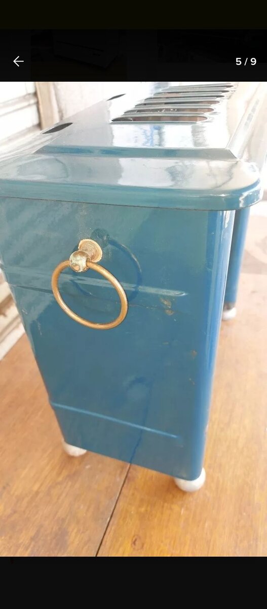

    The image of the nr 60 heater is very similar to the heater I bought.
    Here are some pictures taken from the seller's post. When it arrives I'll post some more
    Juan
    compressed_1685884928622.jpg compressed_1685884971514.jpg compressed_1685885009457.jpg compressed_1685885027081.jpg compressed_1685885040502.jpg compressed_1685885050597.jpg compressed_1685885067896.jpg

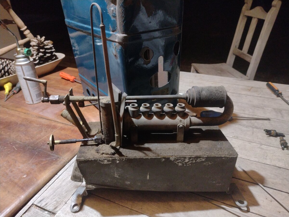

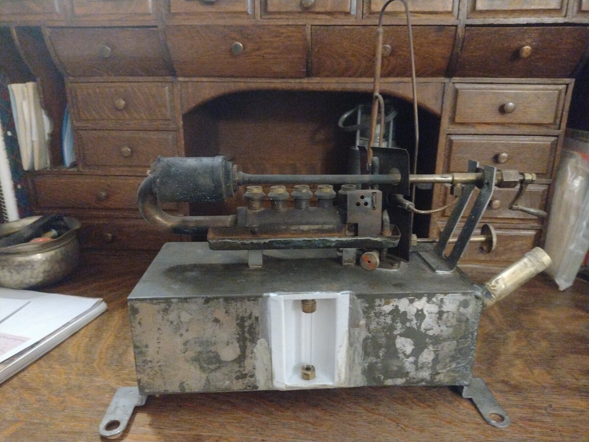

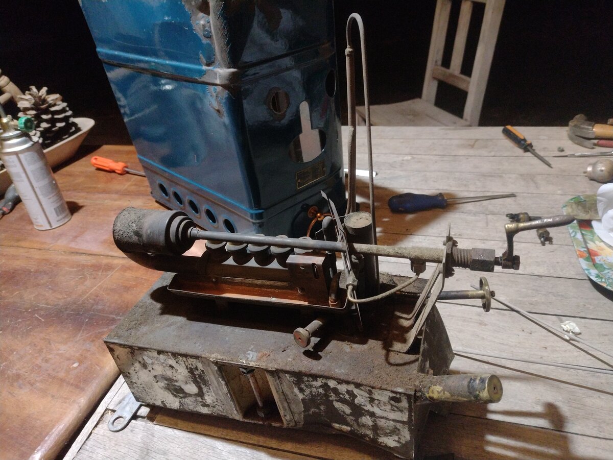

    Well, the heater is finally at home.
    I took it apart and by now is enough. Weird device, let's see how does it work and what fuel. It seems it would be dangerous to light it with gasoline and there is a preheating cuvette, so I assume is kerosene.
    Juan

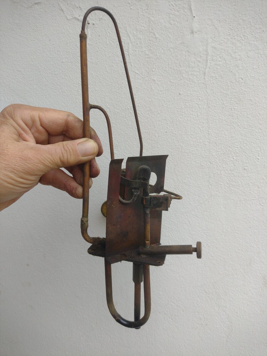

    Well, this is the automatic pump.
    Would see how it works. If it still works ...
    Except for the damage on the tank, everything seems to be in very good condition.
    Juan

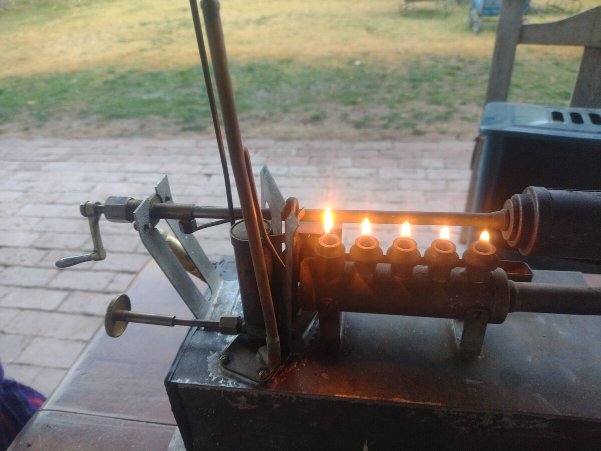

    Ok. I repaired the tank, fixed a couple of broken pipes, cleaned a ball valve and reassembled everything.
    Now I have to figure out how to fill the pump as I guess that if there is no fuel within it, it won't work.
    Tomorrow's task ...
  16. Juan
    Dec 2, 2010
    975
    Mmmmmhhhhhh. Not very good
