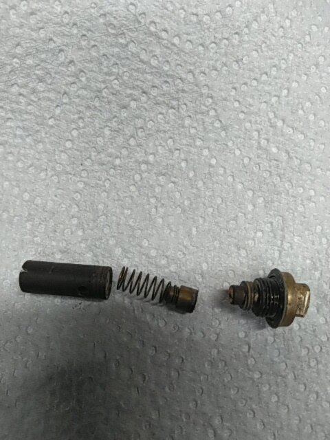

    Hello everyone ..
    So I managed to get the NRV out of the lantern with a piece of square stock I made a slot in and it worked great .
    Here is what I have ..it looks like the old seal is cork so I assume that's original to the lantern .
    Im thinking all I have to do is order a new pip and I'm good to go ..correct ??
    Thanks very much...Ernie
  9. WimVe
    3,544
    You can but you also can make a new seal yourself.
  10. MYN
    Good to hear you've home-made something that works.
    Cork pips were often found in older NRVs. Cork is pretty resistant to a wide variety of solvents and fuels. Not all 'rubbers' are fuel-resistant.
    Viton wasn't available yet in those days.
    Some Buna-N or Nitrile might work ok.
  11. WimVe
    3,544
    Edit: for a fast fix: turn the cork pip over, use the backside.
    This also works for rubbers pips/seals, as long as they are intact. The continues indentation by the spring pressure makes them leak in combination with drying out.
    Or completely wrong: pull the spring further out a little...
    This doesn't work for cork but may for rubber.
    Off coarse all besides cleaning the seal.
