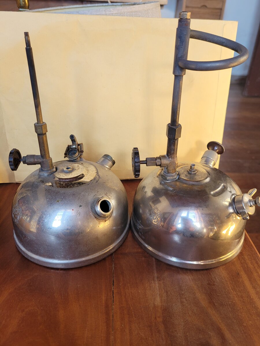

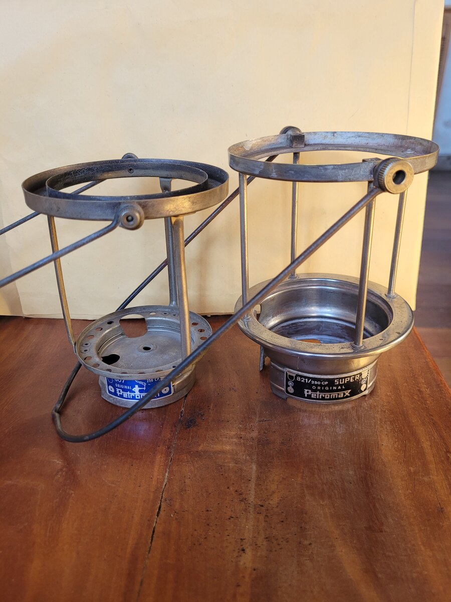

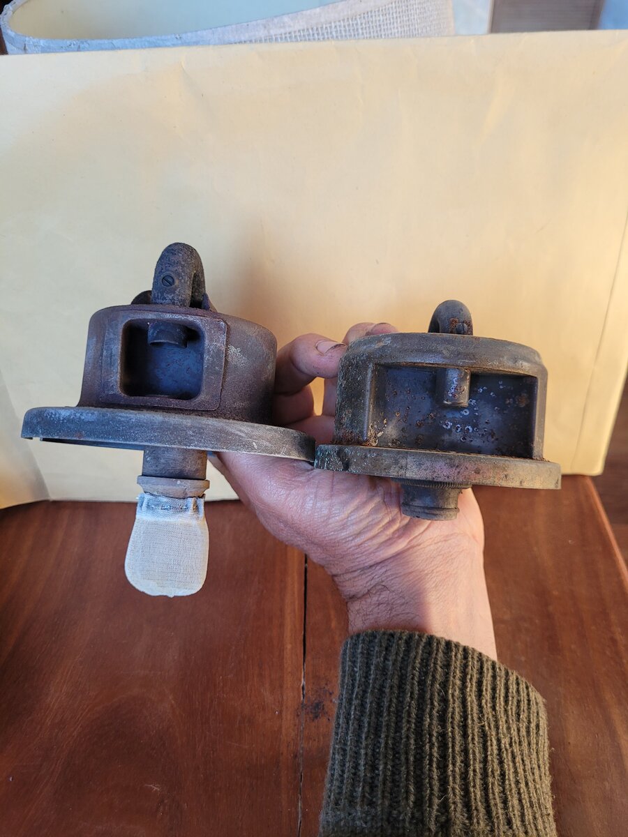

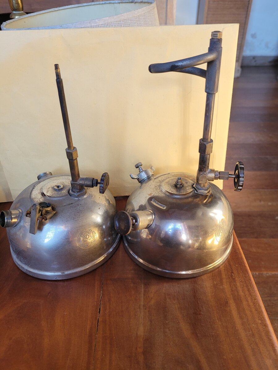

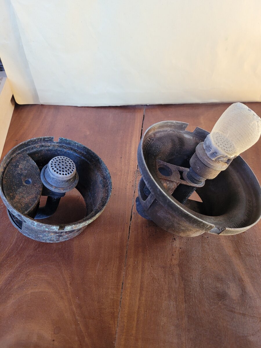

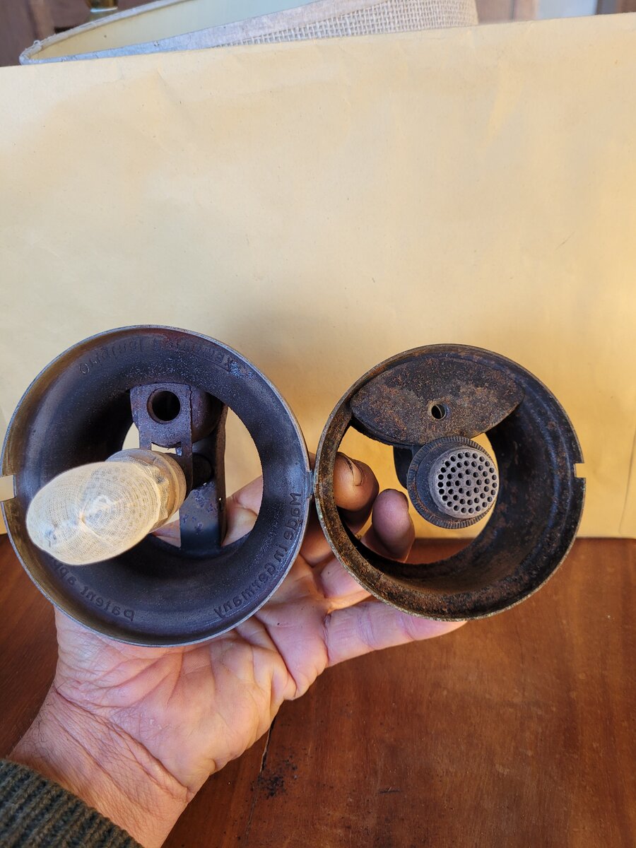

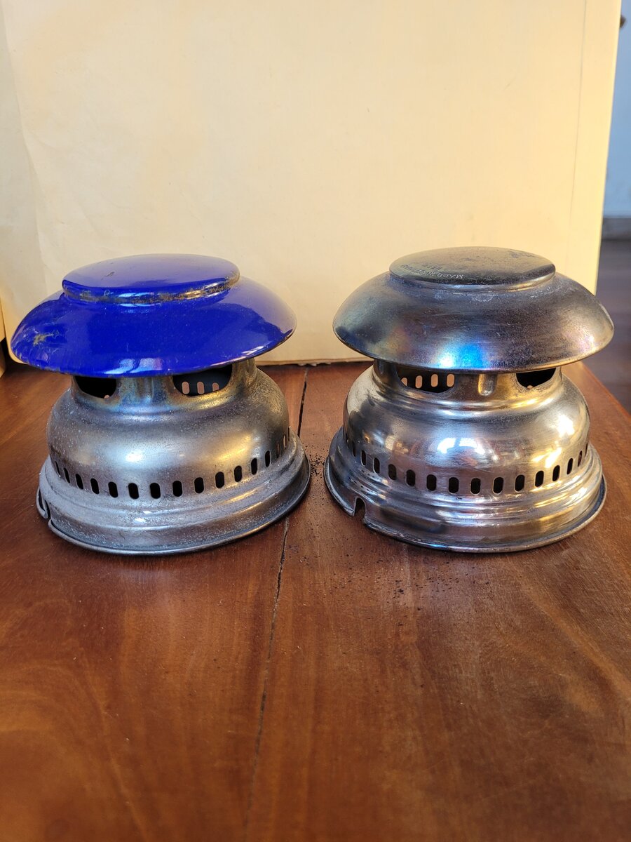

    Hi, everyone. Some days ago I bought a Petroman 807. For my surprise it is very different than his brother Petromax, I send some photos, regards.
    20241003_081312.jpg 20241003_081345.jpg 20241003_081448.jpg 20241003_081535.jpg 20241003_081555.jpg 20241003_081657.jpg 20241003_081749.jpg

    The straight vaporiser with the small tip/jet should be used with petrol/gasoline in my opinion.
    If you try to search for Petroman images, you should be able to identify the features of your lantern.

    Martin, I find a page where is excelent information about these lanterns. The vaporiser is the only one, to be used with gasoline you must use a protector in order to reduce de temperature in the vaporiser, regards.
    Infoseite: Petroman - Vergleich zur Petromax

    Interesting that it seem to use the same size jet/nipple for either fuel. Do you have one of the heatsheilds ?

    Hi Fireexit, no, but I use kerosene. Im trying to fix the torch of the petroman but is difficult there are not spare parts for that
