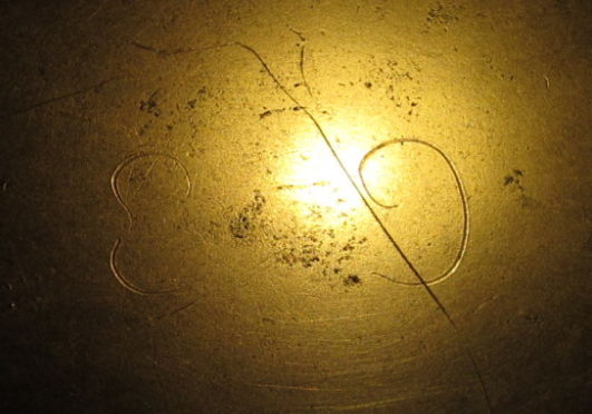

    The bottom of the tank says:
    so it must be august 1939.

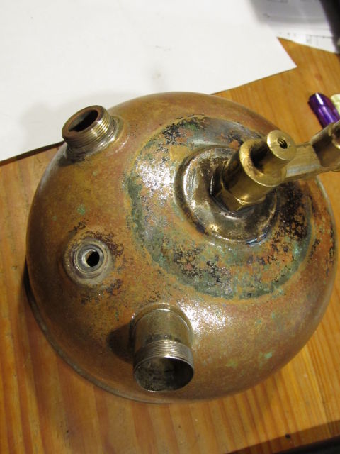

    The lamp looks unfettled to me and the lamp is stamped 826 on the fount and marked 8 9 in the bottom (august 1939).
    The fount carries a hole for a pressuregauge - blinded by a screw - but prepared. It has the "new" tanklid with airrelease inbuild and the more moderne 2 coloured controlhandle in 2 parts. Nothing of this is to be seen on any of my other pure Petromax-made 826-lamps from the 1930's.

    I thought it was a bit of a frankenlamp when I found it because of the pressure-gauge-tank-lid and I still dont get why they put a exstra hole in tank:
    on a 826 tank?
