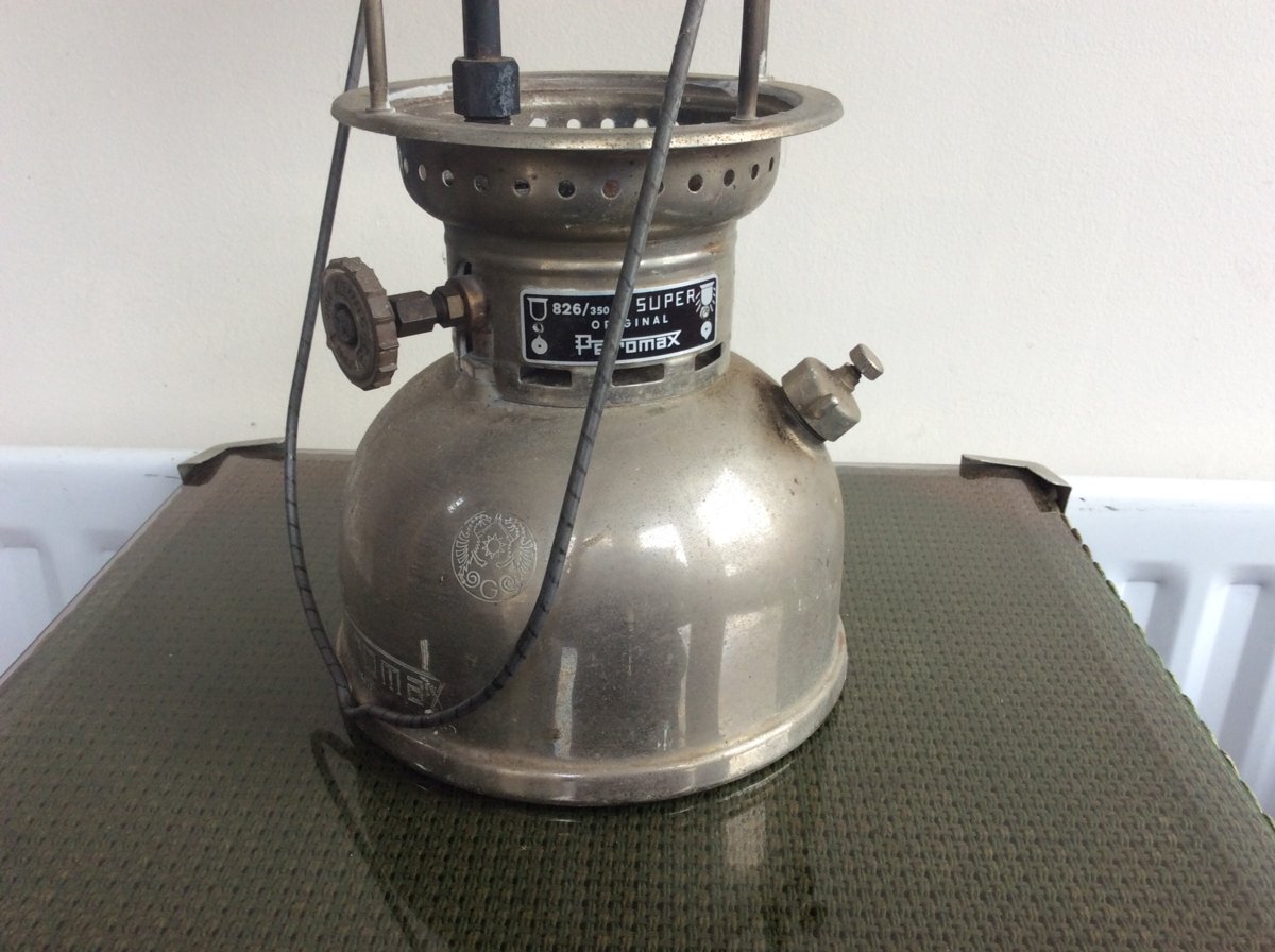

    In a matter of 30 days I went from zero Petromax to three. This one was bought online and I am wondering the era this may be from? I cannot see any numbers on the bottom as it has some sort of bare brass color with a thin silvery coating. It came with a great reflector, but the glass arrived cracked. The seller however compensated for the glass and I am overall happy with my purchase.

    I have often seen such Petromax lamps with a smooth carrying frame without any date marking.
    They were made in my opinion from December 1956 to perhaps 1958.
    Attention,collecting Petromax can be addictive.:lol:

    Hi, for what I know that style of collar was on production from 1954 to 1956, so the production date is within this timeframe.
    Obviously I can be wrong
    Nicola

    The application for the German Patent DE-1023431 with the ribbed collar dates from August 1956.
    So this lantern should have been produced before that date. Maybe this can be proven by investigating whether there are scratched numbers on the bottom.

    The Patent for the ribbed collar ist from 1956.
    In fact,the ribbed collar was introduced in 1958.
    The smooth collar was a temporary solution between the "Sicken"(4 beading grooves,1954-1956)and the actual introduction of the ribbed collar.
    Tomorrow I will take pictures.
    I have several Petromax from each vintage with date here.
    Regards Reinhard

    WOW, thanks for all the information! I really like this lantern, just the right amount of age to it, cleaned some of the age off it, but chose to just leave it look well used.

    As far as I know and have, there are basically four different frame collar variants for the 300/350...500cp Petromax lanterns.
    1. Early longitudinal oblong slotted.
    2. Smooth and 'beaded' sicken with 4 indentitations at the fount to accomodate the 4 'legs' of the frame.
    3. Smooth without the 'sicken' beads like the one on yours here.
    4. Horizontally ribbed as for later ones.
    I'd say the smooth ones are from the 50s, when there were new developments/patents as well as some overlap between the variants.

    Oh ok, I didn’t notice that the collar was without the beading grooves, so my dating was wrong.

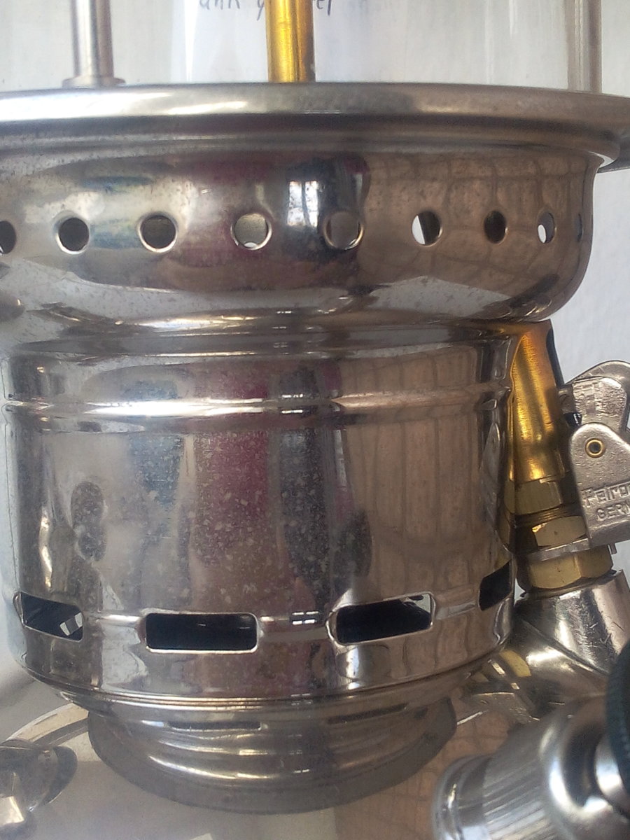

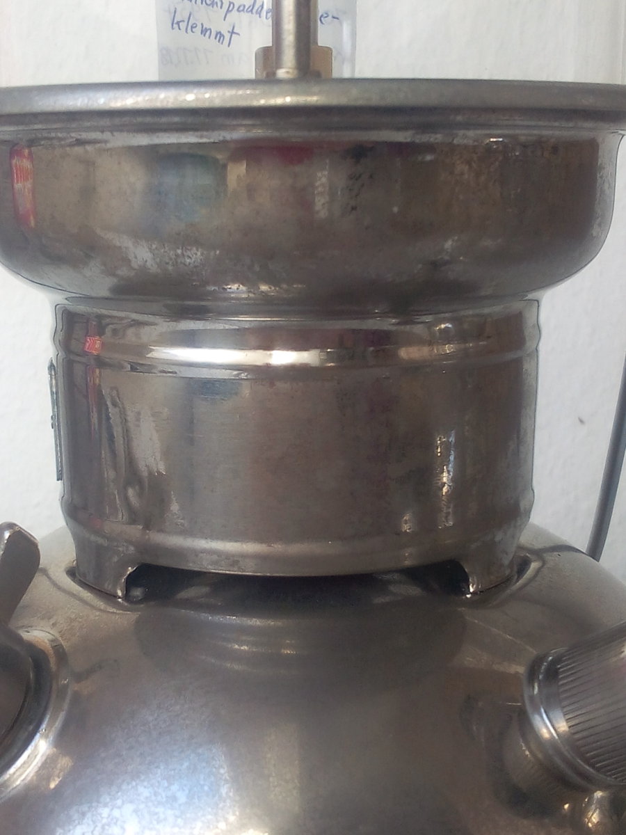

  12. Reinhard
    Reinhard Germany Subscriber
    Oct 15, 2018
    1,091
    Picture 1 is a "Sicke" 1954-1956
    Picture 2 is the smooth frame collar.
    12/1956 -1958 ?

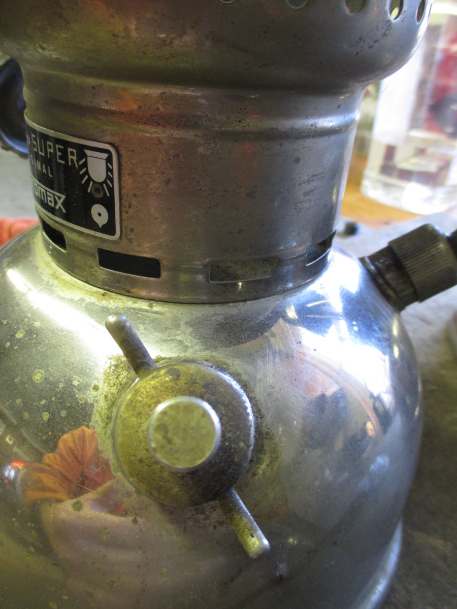

    image.jpg image.jpg Here is the Petromax 826 I brought home recently, looks like the same collar as on Reinhard’s lamp. Letter ‘G’ on the logo and I don’t see anything on base.
  15. WimVe
    3,531
    Nice example.
    Why is tehre a spiral patern on the bail ?
  16. Jean J
    2,984
    I hadn’t noticed that Wim and have no idea why it’s marked like that.
  17. Nils Stephenson
    3,384
    It's possible they had some of that plastic spiral wrap on the handle to avoid burning fingers. The zinc has oxidised more where the cracks were giving the spiral pattern.

    @Nils, that was my idea too but most collectors use the spiral wrap only to avoid scratches by the point where the bail touches the fount.

    @Jean J I'll get a pic or two of the glass soon, Im sorry I have not done it sooner. Thats a nice lantern! And for the spiral, as others have said, i wonder if the handle had some sort of plastic wire/chafe guard wrapped on it at one time as they use around electrical wiring and other things.
  20. MYN
    I don't think its caused by a spiral electrical plastic chafe. It looks like some tape being tightly wrapped on the handle earlier. If the handle could be detached from the frame, a protection sleeve would have been slid over it instead.
