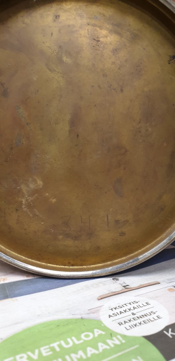

    beginner here hey. i bought a petromax 826 light and would like to know if this is how old and rare. the bottom is labeled 341.
    I thought the price was good when I paid 40euro.

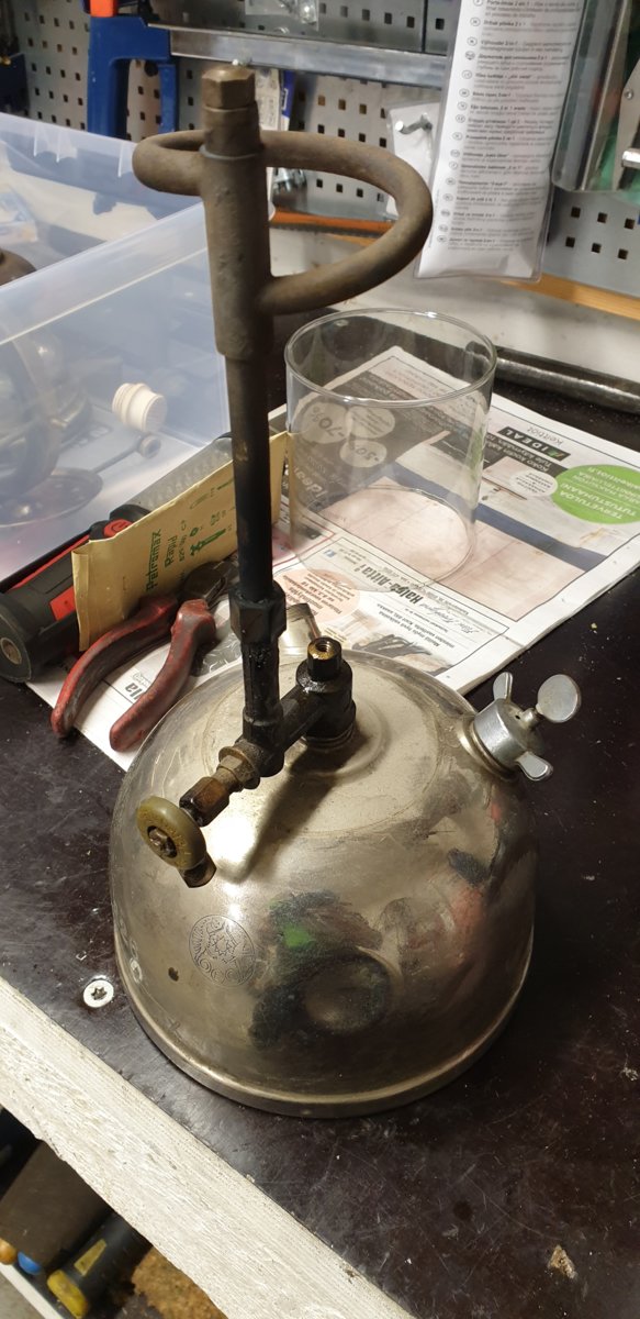

    Moro fotos

  3. george
    Maybe made in 1964? There should be four digits on the bottom of the tank. The globe is a later replacement, and the control knob is strange looking. It appears someone did some modification or repair to it.
    Nice find!

  5. WimVe
    3,522
    Welcome, I wuldn't have bought it. But at the same time, I don't know how rare these are in Finland.
    The knob, @george, is referring too looks to be the insert of the old double style knob.
    More starnge is the spare (?) glad nut hanging there.
    All in all it works great, like it should, so good lantern.

    But with 826 on tank for sure no lantern with four digit on base. Only lantern from sixties have the well known 4digit code

    @bp4willi Thanks, Willi! I screwed that one up!](*,) I should have mentioned those from the 1960's are "stamped" and the "E" would not be present in the "G", either. I see the " 3 7 1", hand scratched.

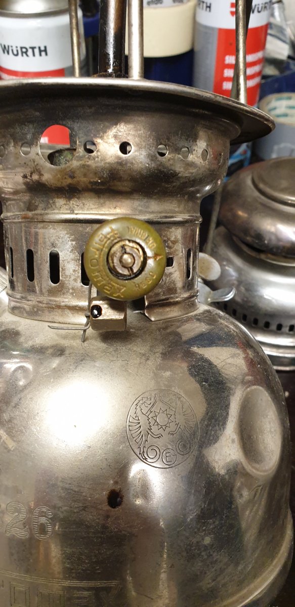

  10. MYN
    That's an old one. Probably 1930s or 40s but early 50s is still a possibility. Not from the 60s. I don't know about the pricker knob but it appears somewhat special/different, with some numbers on it.
    The vaporizer gland nut area appears to have some leak?
    What's the roundish depression on the fount? Is that a reflection or am I seeing things? Looks too uniformly round to be just a dent.

    Finland
    there are a few dents and scratches in the lamp, and there were leaks.
    I unzipped it into pieces and polishing and sealants exchange. I'll put new pictures when I get it done.

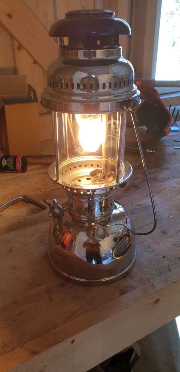

  15. Anssi Niemi Finland
    Mar 11, 2020
    13
    Finland
    Old lady is now ready.

  18. ROBBO55
    4,332
    Congratulations, @Anssi Niemi it's cleaned up nicely and giving a good light. :thumbup:
