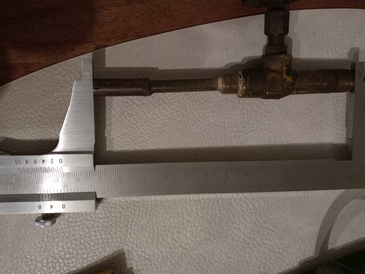

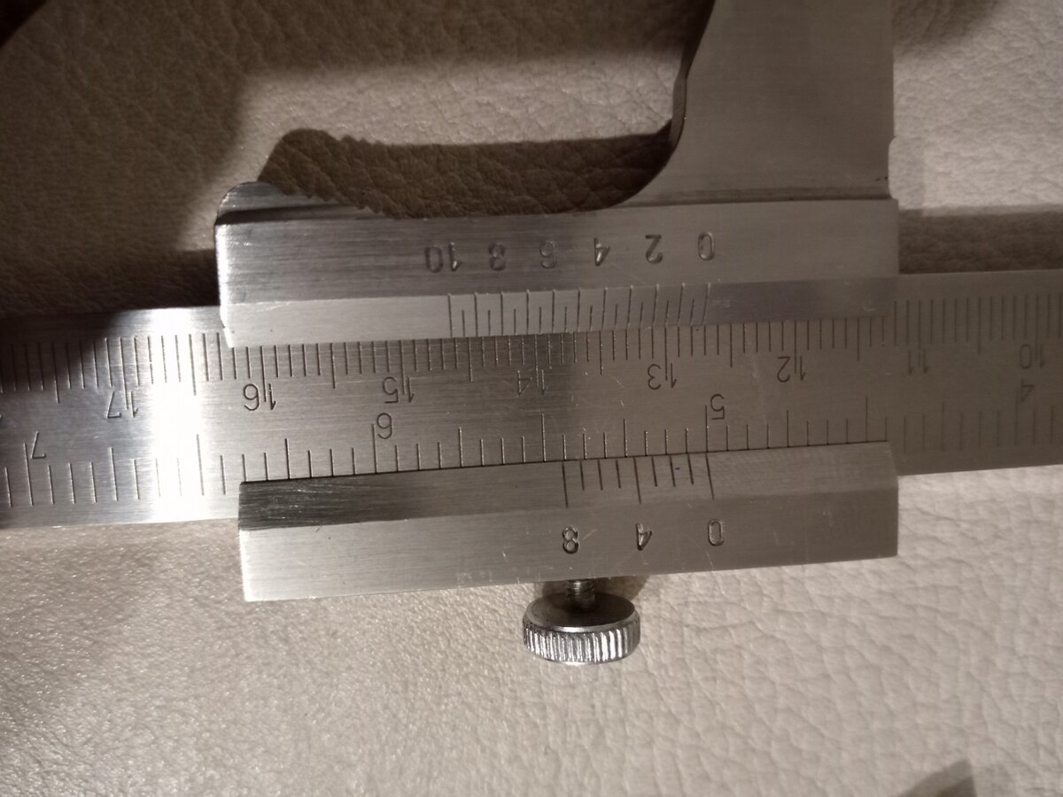

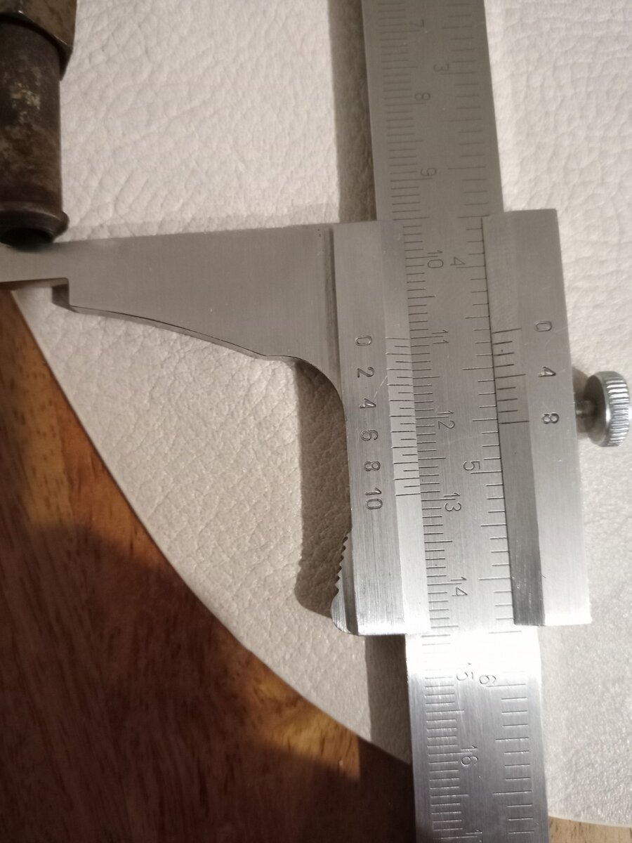

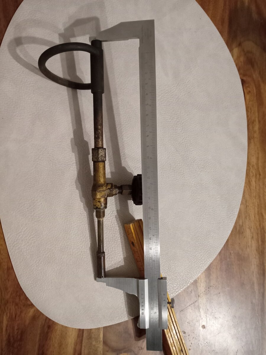

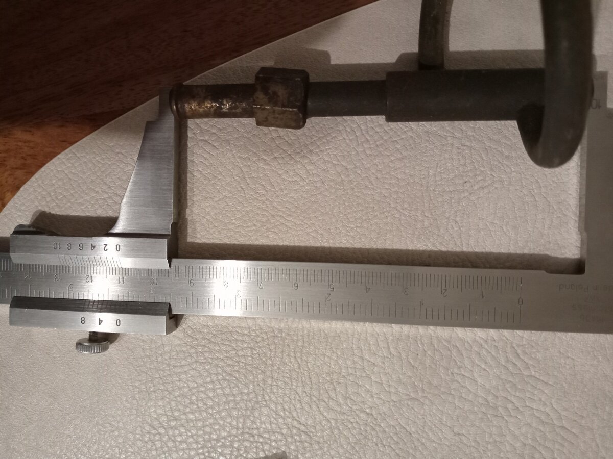

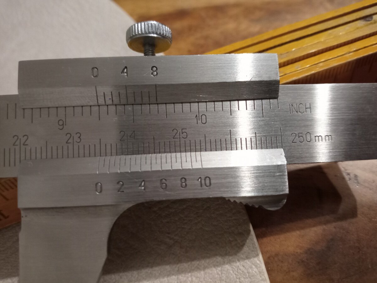

    @Alexandre Freddi
    I am late, but here are dimensions of my 827 (made during WWII).
    I thought that the whole generator was missing so measured both parts...
    Total – 23,5 cm
    upper part – 12,7 cm
    lower part – 11 cm
    Good luck!
    Piotrek
