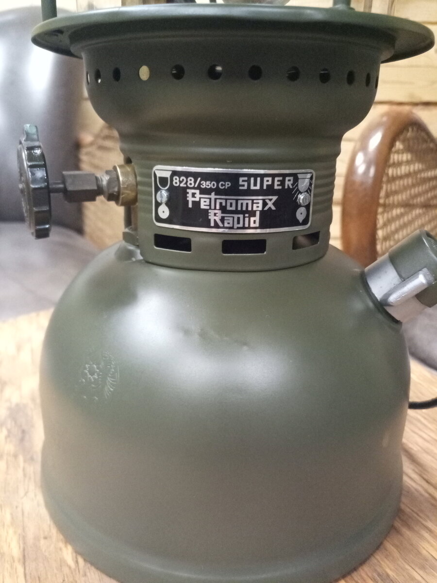

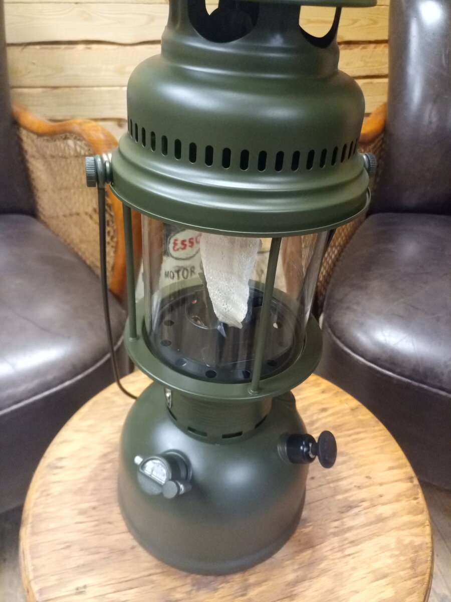

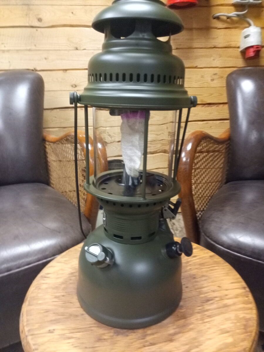

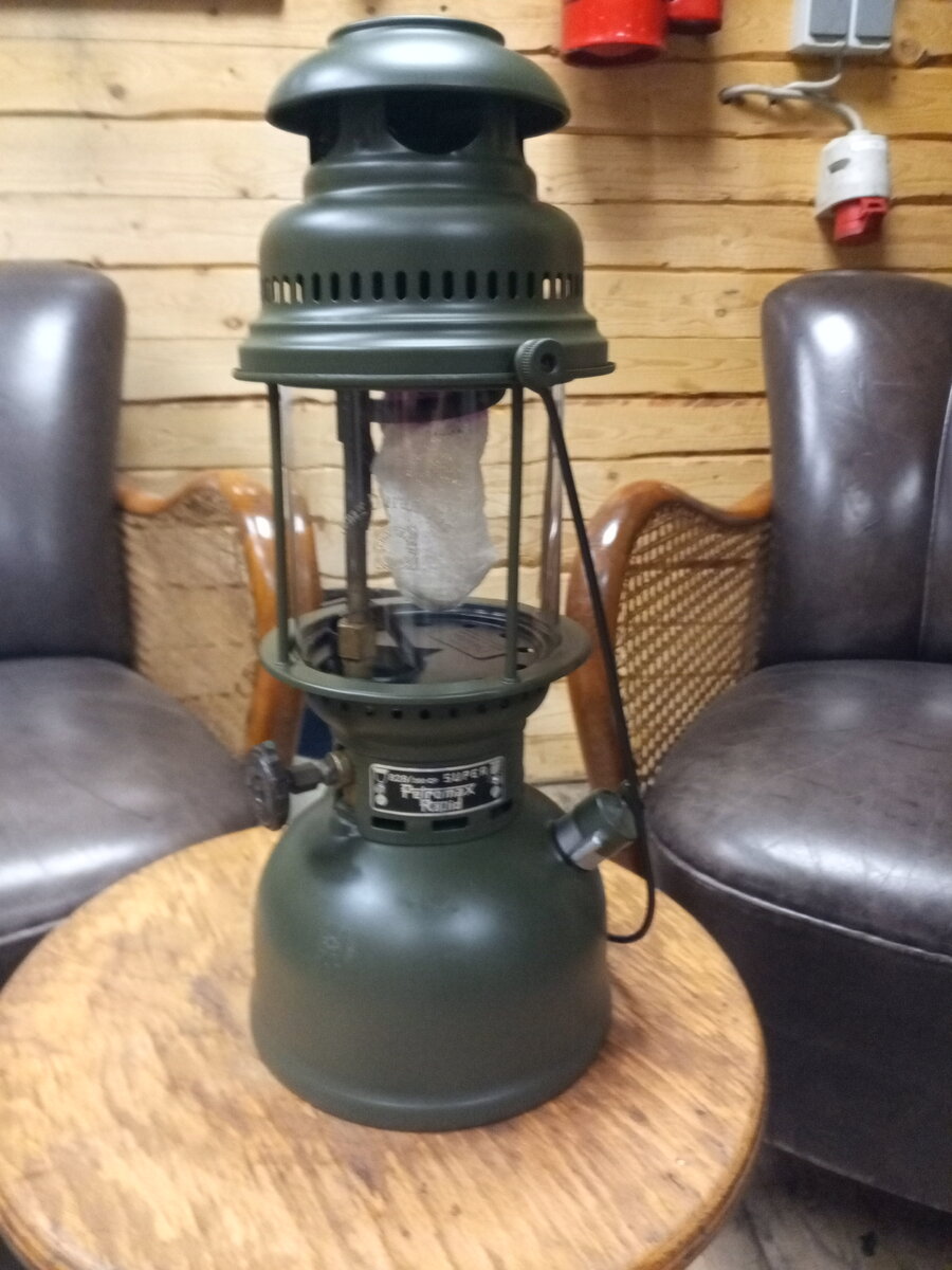

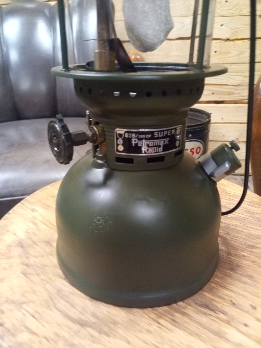

    Moin,
    my newest lamp was finished today!
    I got my hands on a completely weathered Petromax HK 350 and built it all over again.
    Unfortunately, the surface was very bad, but the technology was in good shape.
    I have enough original lamps, I finished the new old Lamp in an alternative personel Style military look.
    I'm curious how the lamp will behave during the test run.
    The 350 Models should run quieter than the 500 Models of the same size.
