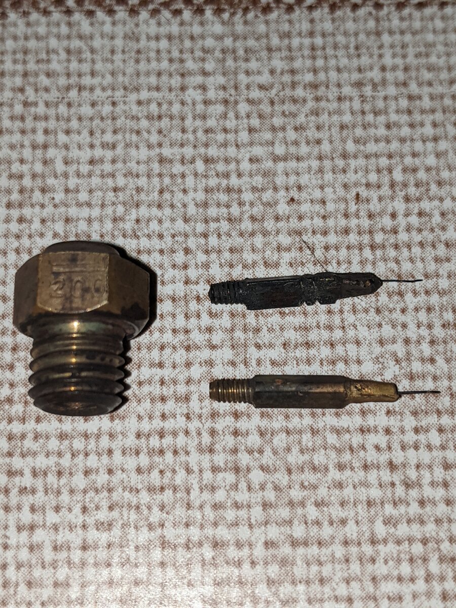

    I have it recently, and now I am triyng to make it work
    PXL_20230707_144821726.jpg PXL_20230707_144724439.jpg PXL_20230707_144715097.jpg PXL_20230707_144754456.jpg
  4. WimVe
    3,544
    Ok, so change the nozzle and needle and make sure they fit well. Check and adjust the air cap between the jet and air intake and do a rapid check (does it work) and check (cold) if the fuel spray is straight out of the (350cp) jet.

    Looks like you've got Petromax 828 that could possibly been made in the late 1950s. Does it have any numbers at the bottom of the fount/tank baseplate?
    The jet('nozzle') orifice or hole for this 350cp lantern should be 0.2mm in diameter and the cleaning needle would be 0.19mm diametre.
    If the cleaning needle of your Petromax is around 0.19mm, then the 200cp jet's orifice would have been already enlarged to just about the right size:).
    In addition to all the advice already given, you also need to make sure that the jet is not slightly leaking at the threaded areas. That will also make the burn too rich and sooty.

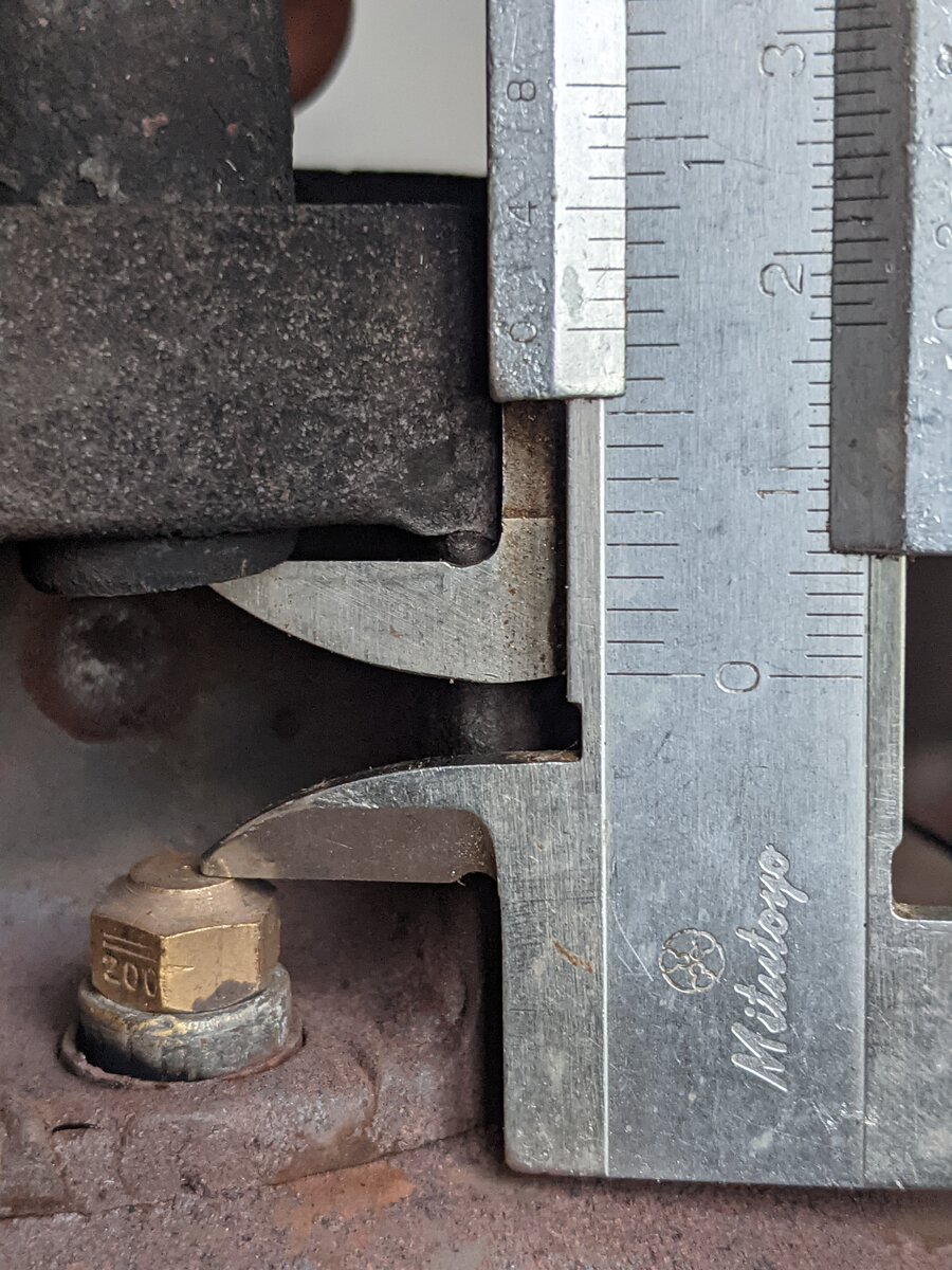

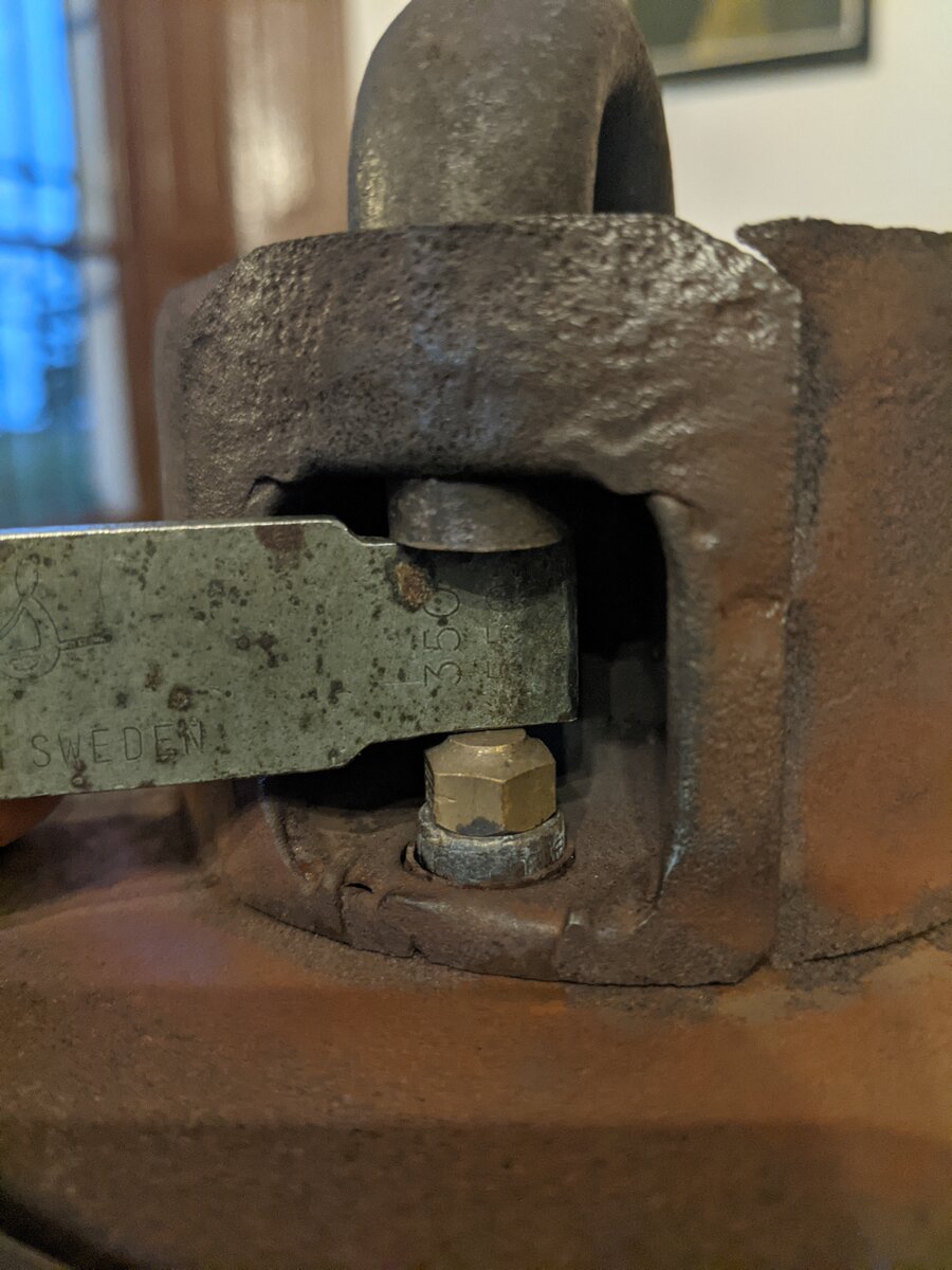

    Good afternoon, after regulation of the air gap with this optimus key, measuring 9/16", the problem is solved. The combustion is clean, thank you all for the help.

    The increased mixing tube distance can never have been the cause of the smoke and soot.You had everything prepared in advance,including the pictures?

    The px will operate at any air gap between 14 and 18 mm.
    Is the jet worn out, rather approach 18 mm gap for correct gas mix.
    Either a 200cp jet combined with 200cp needle was mounted. Such 200cp jet will not work satisfactory in 350cp lantern. As mixing tube and nozzle are too large.

    First I dismantle and clean the carburetor. Because I find a needle in my father desk I change it because the old one apears to be very
    worn and crooked. I cant see any marquings in the needle so I suposed were equal. Here I supouse could happen what MYN said first time, looking the photo, not in direct sight I can see the second needle is thicker than the first one.
    when I put the needle in the nozzle I find some resistence but I think it was because the dirt. Probably I was rectifying the nozzle to a bigger measure.
    Then I mount the carburetor, I corrected the mixing tube (it had a crooked mouth) and the (famous) distance. Then I mount a 300-400 cp mantle and everything works fine.
    Best regards, Leonardo

    The two grooves on the thinner needle indicate a 200 CP size. The older 300 CP needles have three grooves. Unfortunately, this marking no longer exists on the newer needles, but the thicker needle looks more like 500 CP to me. You could verify this by measuring the wire gauge. For the different dimensions you could look at this table. Please note that the differences in jet & needle sizes are quite important, and only a small enlargement will already cause the lantern burn rich.

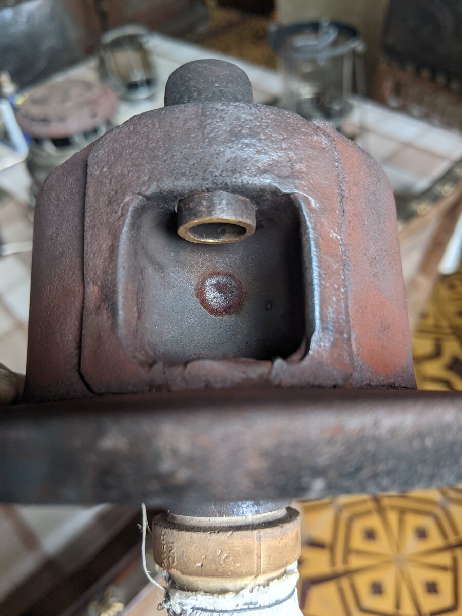

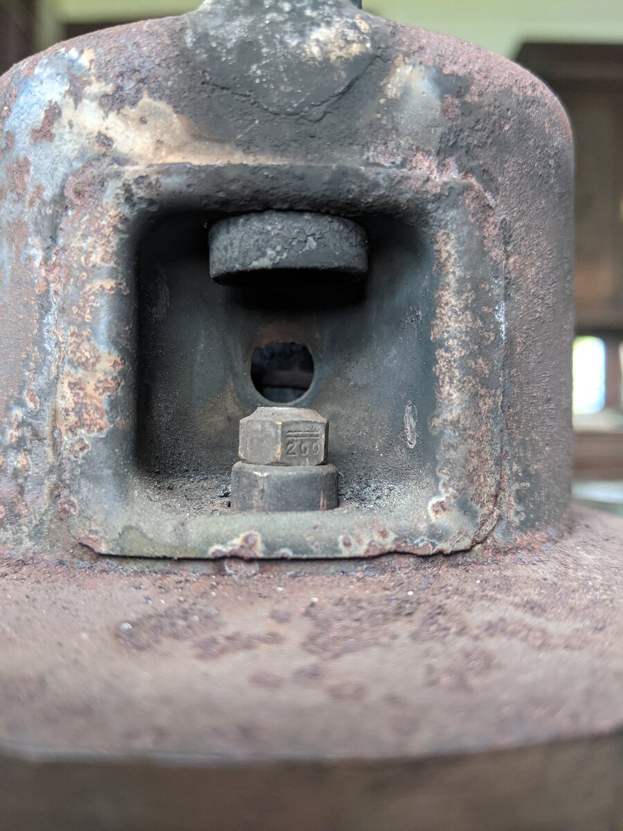

    There is a mark behind the gap between the nozzle and the mixing tube that apears caused for some malfunction, maybe can guide you
    I have another lamp, an Optimus that have this piece completly holed. This Optimus lamp after some time creates a spot of coal on the mantle

    The marking in the first picture must have been caused by fuel escaping from a completely worn jet.
    Re picture two: Hot combustion air is sucked into the mixing tube through the hole,which very quickly leads to the mixing tube glowing with all the consequences.

    In 2nd picture, You definitely should close the hole with a patch!

    There should not be any burn or shoot marks in the "air chamber".
    It means the jet, new or old, doesn't fit correctly on the vaporiser.
