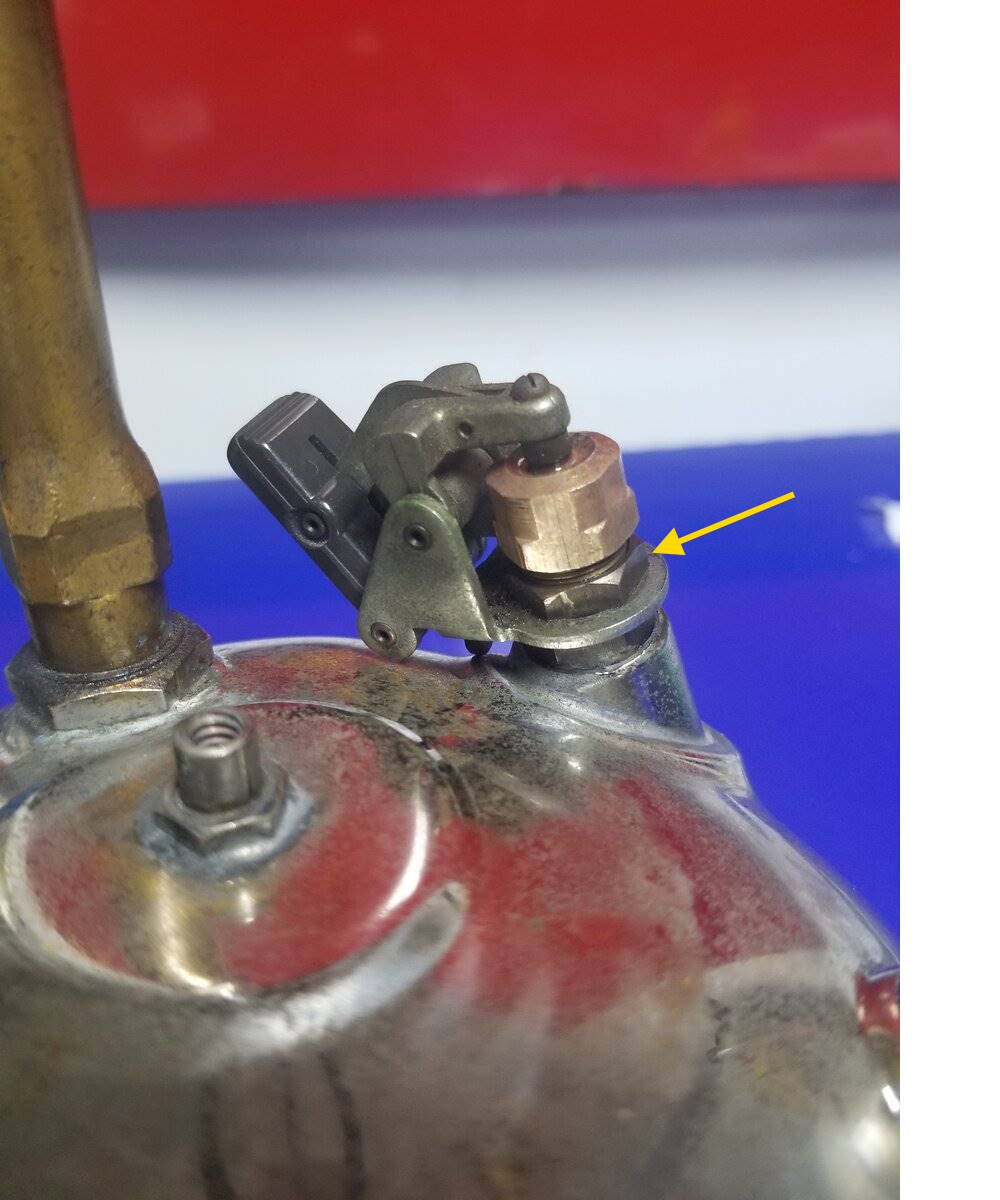

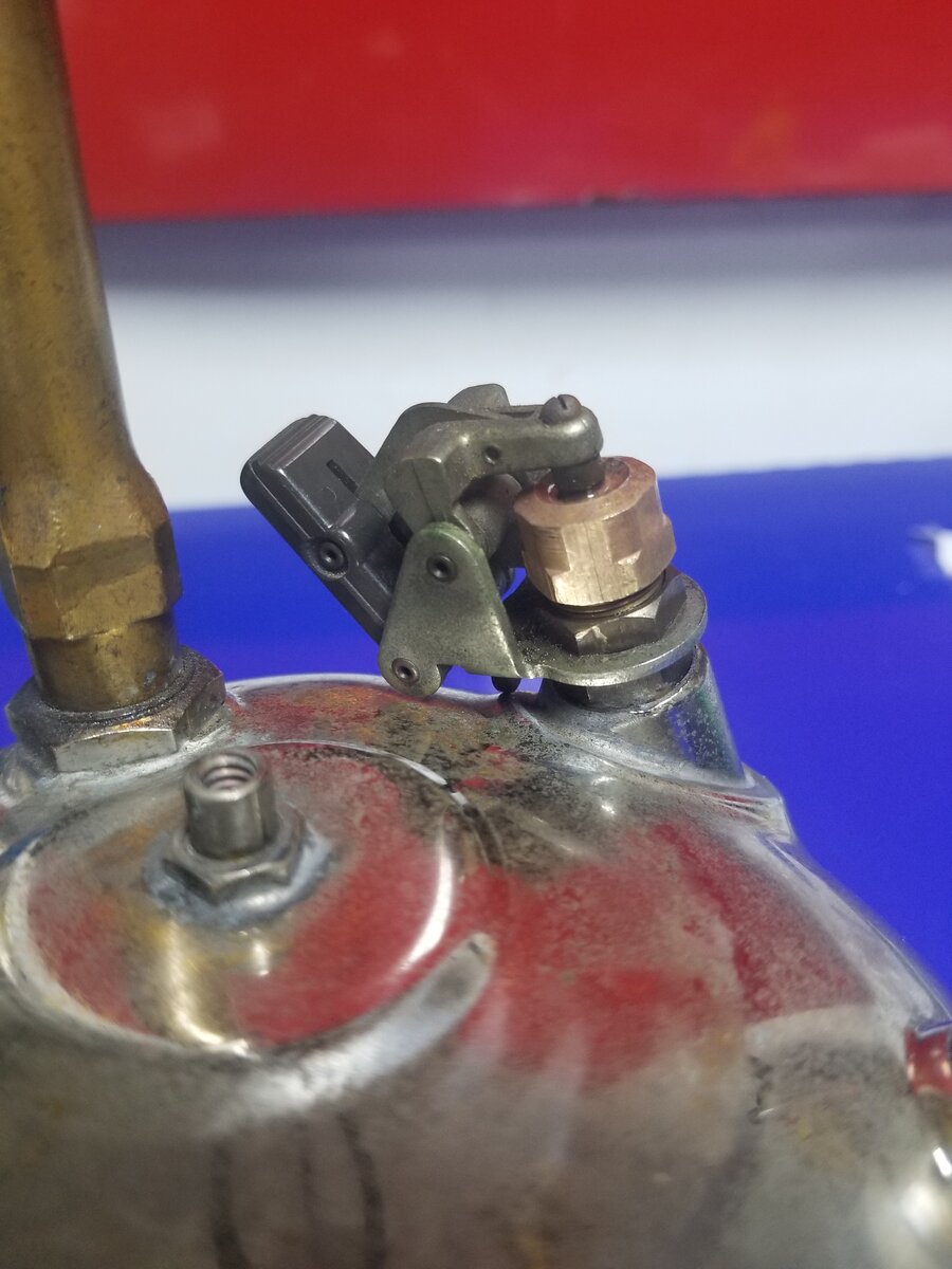

    So I picked up my first Petromax last week, but I've hit a snag in getting the preheater working properly.

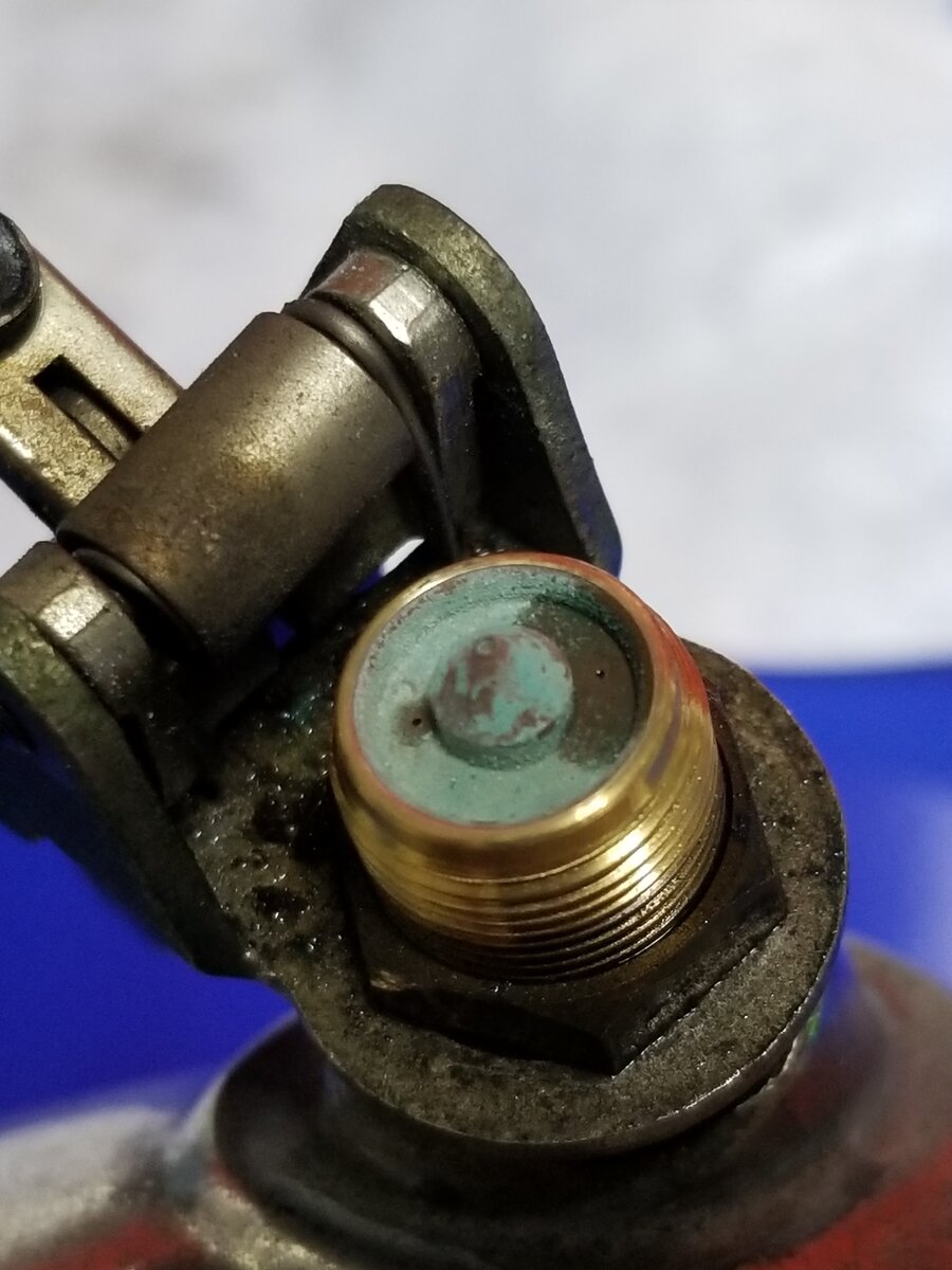

    Both side orifices will pass air if the lantern is sitting still and will pass fuel if the lantern is gently shaken. As you can see though, the center jet (if it actually has one) seems to be blocked. So naturally, I tried to unscrew the rapid preheater from the fount, so I could clean everything.
    But when I went to unscrew it, I found that the shutoff mechanism wouldn't clear the fount and seems to be press fit onto the preheater. I can't seem to find any info on how (if it's even possible) to disassemble it. The question is, is there a good way to disassemble it, or should I leave it alone and try to clean it another way? Any help is greatly appreciated.

    All parts can be dismantled with the help of two well-fitting wrench. The parts are not pressed.
    You have to completely disassemble and clean the parts because the riser pipe and the intake filter are often clogged.Mechanically with wire or with an ultrasonic bath,if you have one.
    It often happens that the small holes are worn out and the mixture of fuel and air is no longer correct.Then you have to replace part 224 or the entire connector 225.

    Parts 223 and 224 are definitely pressed together on my example. I can provide more pictures if it would help I'm just trying to figure out a good way to separate 223 from 224 so I can unscrew the whole assembly from the fount.

    Your photograph seems to show a nut...?
    Part 222

    That was it, thanks. The nut on top was lined up so well with the bottom, that it just looked like one solid piece.

    When cleaning the rapid make sure the tiny holes in the body part are clear.

    I once had to grind down a wrench so that it is thin enough to fit into the bottom hex:
    You need to hold the bottom hex in place with a thin wrench while you work loose the top nut with another wrench.
    Otherwise, the whole preheater bracket will turn together until it forces against the fount's side as in the picture.
