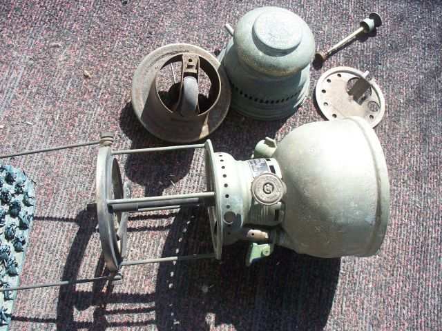

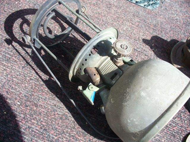

    crusty but soon to be trusty i hope :shock:

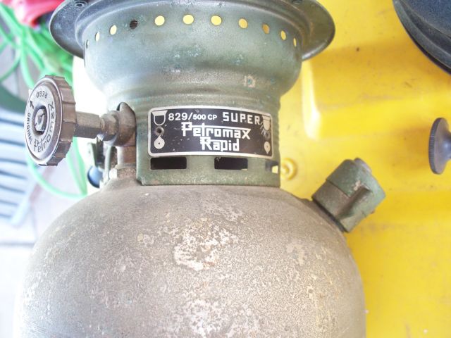

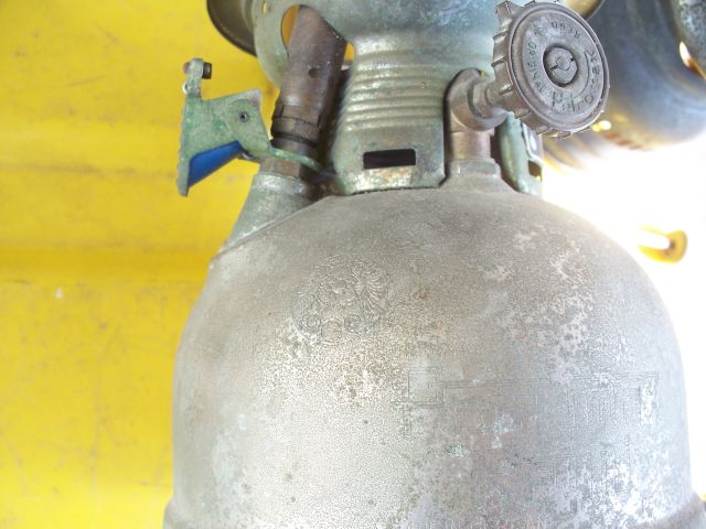

    Good old salt water corrosion! anyway can you tell if its a good lantern? valve works well and cleaning needle too. has eagles on fount and petromax stamped everywhere. blue paint on priming torch lever if that means anything. 167 stamped in center of bottom and has brown valve wheel and pump knob.

    Eagles???? Not hardly; if it is a Petromax then them is sea horses. Apparently these were a favourite of Petro Max's. ::Neil::

    I'm a stovie :-$ Even if i knew they were seahorses i'd probably call them eagles its so rough! got the pump nrv out and apart but the spring and pip are still stuck in the barrel. Pip is in a cup i think. i can get a tiny screw driver in the screwdriver slot in the end of the barrel but cant push the spring/pip out. I have some spare optimus stove type spring and pips. so i might have to heat the nrv up to get everything apart.

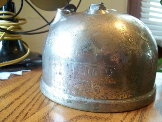

    Igot the nrv apart. also sent Ross a order last night. curious as to date, has 167 on bottom. January 1967?

    the inside was coated with sludge so i threw in a handful of tiny brass tacks. swirled it around with some paint thinner and it should be good. Generator foot valve is soaking along with rapid torch bottom. I made tool out of an old radio antenna to make nrv pips and they fit the pump and rapid preheater great! just put the antenna tube in my drill and it zips right through my rubber gasket material. have to make a larger one for the generator valve though. and the no. on bottom is 1671 so 1967?

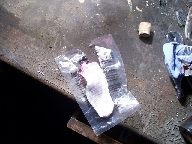

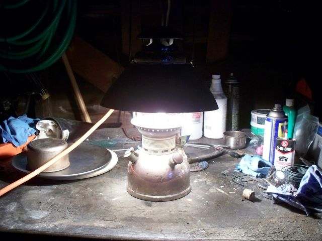

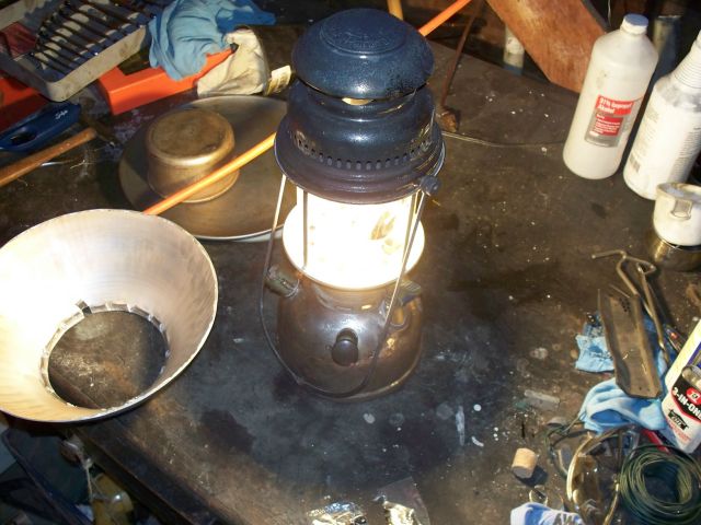

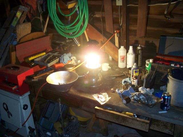

    Thanks for the link Jeff,fast shipping and easy ordering. and thanks to this site for all the help also! Got it lit today and it ran with no problems! My shed is a mess since it's a car repair/scrap metal/storage area. 1304219697-000_0544_opt.jpg I used these mantles i had locally 1304219804-000_0543_opt.jpg and i cobbled a shade for it from an industrial light i had. it's just a rough thing that took 10 minutes with a grinder, but easier on my eyes :) 1304219939-000_0542_opt.jpg thanks again everyone!! 1304220289-000_0545_opt.jpg

    Thanks! a case would be nice, and a real shade. this seems much brighter than a coleman 200 i had.
