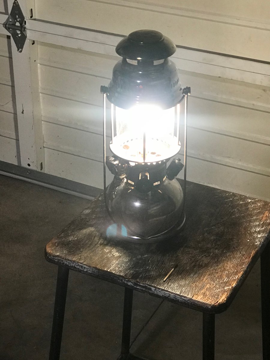

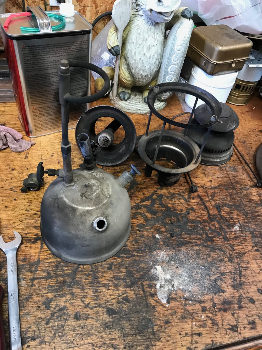

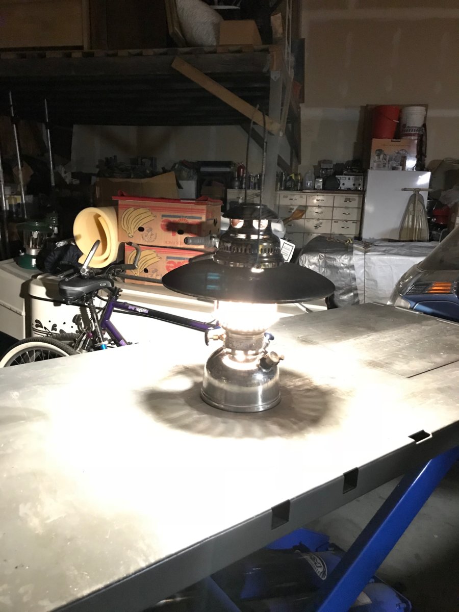

    So I acquired this Petromax in pretty sad shape. It had been sitting on the previous owners front porch for 10 years. He tried firing it up and ended with a fireball. I cleaned up as best I could. Had to manufacture pressure gauge glass. Soldered the quick burner mount on the fount. I still have to clean that up. I also have to clean the reflector. These are awesome lanterns this is the first firing.
    I'm using a Petromax 500 cp HK mantle. Which mantles give out the highest brightness? IMG_0605.jpg IMG_0616.jpg IMG_0617.jpg IMG_0620.jpg IMG_0622.jpg

    Well saved, and it looks plenty bright to me!
    When you get around to cleaning up the solder, unscrew the whole quick start torch from the fount and just replace the lead seal between it and the bung (after re-soldering the bung). A trick that the euro stovies use is to draw a circle around the area to be soldered with a permanent marker. Stops the solder running/wetting where you do not want it to go and gives a neat result. Use a good flux paste with your solder and not too much heat if you use a propane torch. I use an old fashioned copper plumbers soldering iron heated with the torch and just briefly play the flame over the job as needed.

    Amazing that such a beautiful lantern is hiding under that jacket of filth.
    Well done
    16,649
    Well saved indeed!:thumbup::thumbup:

    Thanks for the tips and compliments . That fount is heavier duty than I thought and needs a heavy duty iron to solder with, hence the untidy job. I had considered doing the permanent marker idea but thought that the solder job was going to be quick and easy. Famous last words. lol The lantern is equipped with the meths preheater as well but I like the booster rocket :)
