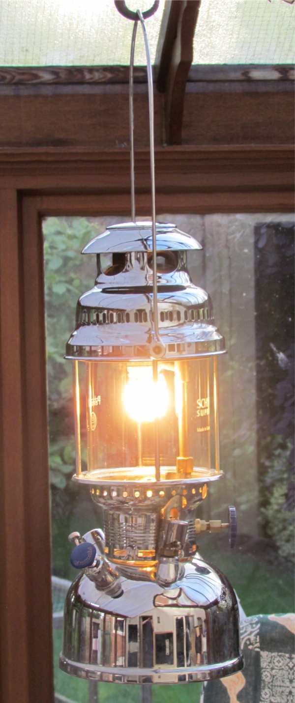

    Hi everyone, my most resent purchase was this Petromax lamp which arrived today. I'm not sure of age if any, probably one of the modern chinese ones. Not too bothered I just wanted a decent useable lamp. Which it was as you can see until the ceramic pepper pot dropped off B0!!$CKS. Might have been because I only had one sock mantle which I had already taken the string out of so I used thin wire to tie it onto the burner. Anyway whats done is done, so now I need a replacement 500cp ceramic burner if anyone has one I shall also put a wanted ad in the trade section. Here is a picture before I broke it. Whilst it was running however I noticed some slight pulsing so I tried to clean the jet which put it out so I lit the rapid pre-heater to try and get it going again but all I seemed to get was flames coming out of the top and it didn't go again. It was only after I'd let it cool down and was pumping it to keep the pressure up while heating it again that the burner fell off :doh: . Lucky I guess it didn't happen while the lamp was running :oops: . Any ideas gratefully received. Regards Matt.

    Looks like a newer version to me but it sure looks good.
    Yes those nozzles can be an awful start when they get loose. It'll become a habit pretty quickly to check it before lighting.
