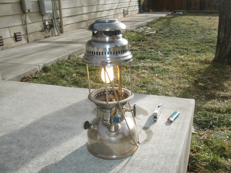

    I just restored a very mistreated Petromax 829 super rapid, and lit it for the first time, new pricker, new foot valve, new pump leather and spreader, new lead gaskets, thoroughly clean with denatured alcohol and shined as best I could, it started right up, no soot, maybe I need to adjust the distance between the jet and the "U" on the mantle section, but it startled me a little that when I cleaned the jet ( turned the knob once) it flared up alarmingly, turned it off, started it again, and after maybe five minutes of use I turned the tip cleaner again, and again a big flare...is it normal?...or I may need to adjust/replace something else?
    Here is the patient:

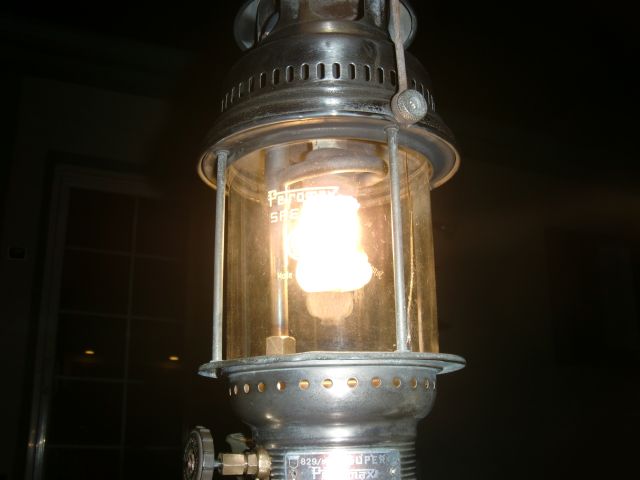

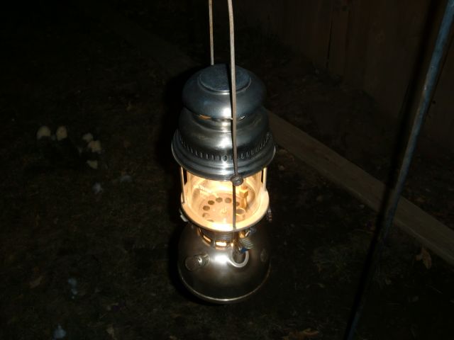

    Ok, I did a full teardown on the lantern, cleaned the brass parts with Carb cleaner ( it let the parts shiny) inside and out, made sure the J tube is at 14.2mm from the jet , I had to fabricate a gauge with stainless steel at work, I am keeping it, changed tip cleaner for a new one, made sure the tip cleaner protrudes .5 mm from the jet, it was interesting that there was a lot of foul smelling residue coming from the Preston loop as well as a lot of carbon residue, after a "dunk test" and making sure there was no leaks under 2 bar pressure in the fount, warmed up five minutes before rotating tip cleaner, no flare up,no gurgling sound, it is blinding bright, here is a picture from the lantern in action. Currently going for two and a half hours with a drop of .5 bar fount pressure, looks quite good.
    My assumption that the foot valve was the culprit was unfounded, with pressure in the fount during rotation there was a definite high fuel stream while open, and no fuel leak while closed, did that several times and there was no appreciable increase in "height" of the fuel stream.
    PS according to the person who sold it to me, it was in a garage at a house near the beach in Barranco, Peru for more than thirty years, and he remembers using it in the eighties when blackouts were frequent.
