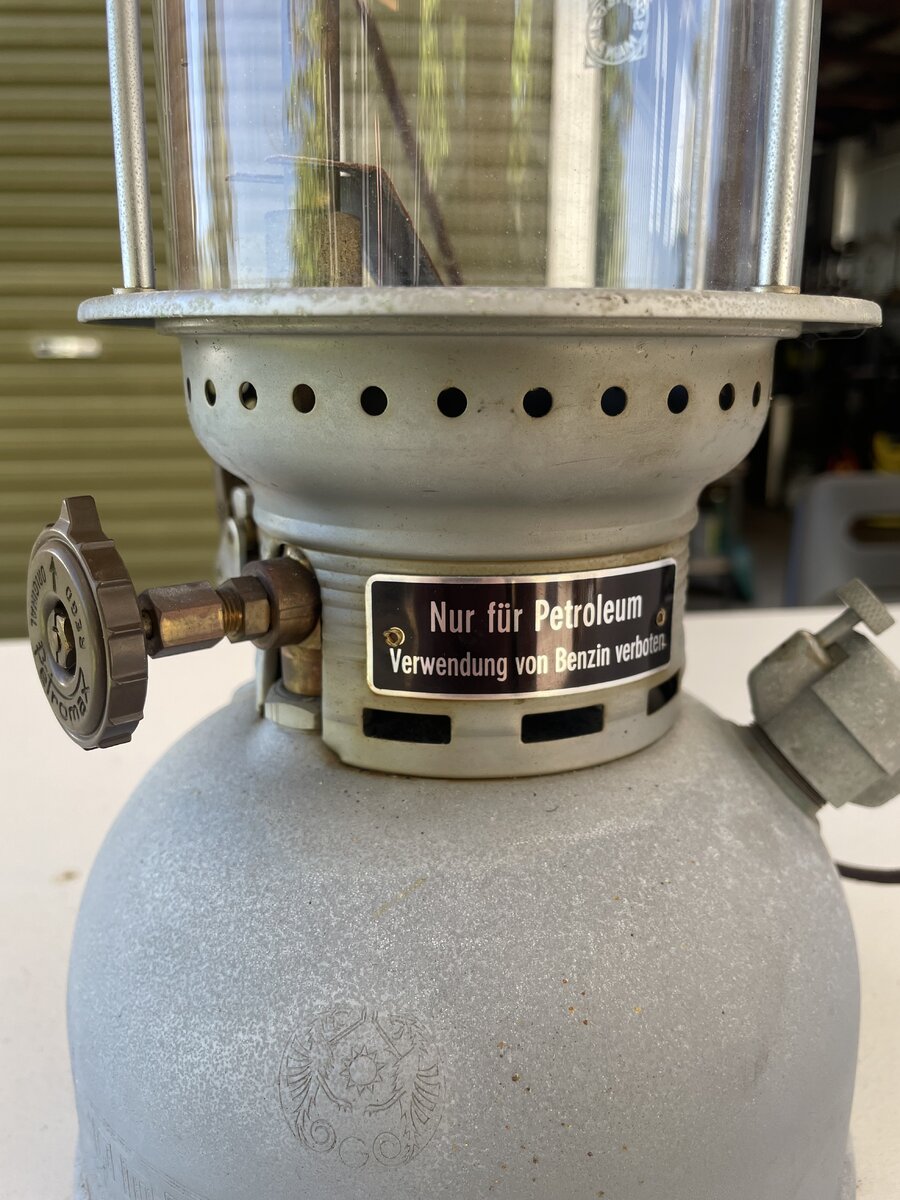

    Really pleased to add this one to my collection! Looks to be in great condition apart from the bent hood.
    I’ve wanted one of these since I got my first Petromax a few years ago. Never thought I’d find one on Marketplace so I made the 4 hour round trip to collect it this morning.

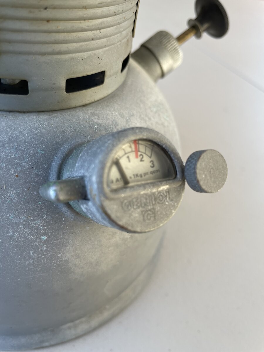

    Geniol pressure gauge…

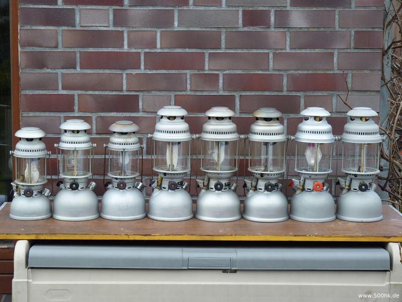

  11. leo
    leo Germany Subscriber
    413
    some of them
  12. Henry Plews
    3,031
    An impressive line-up.

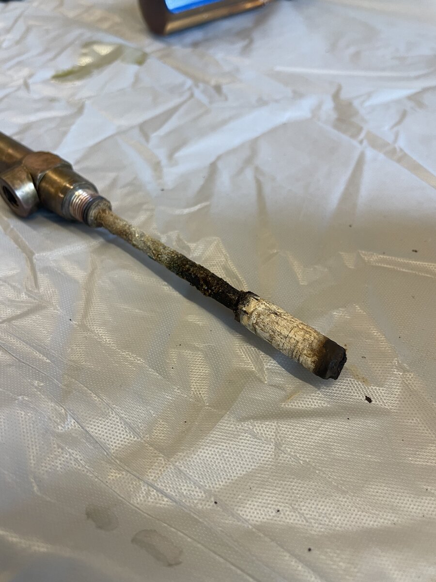

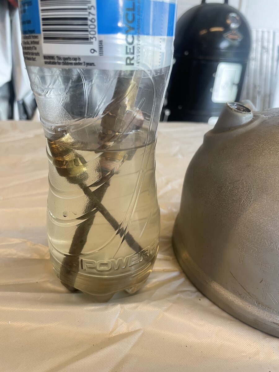

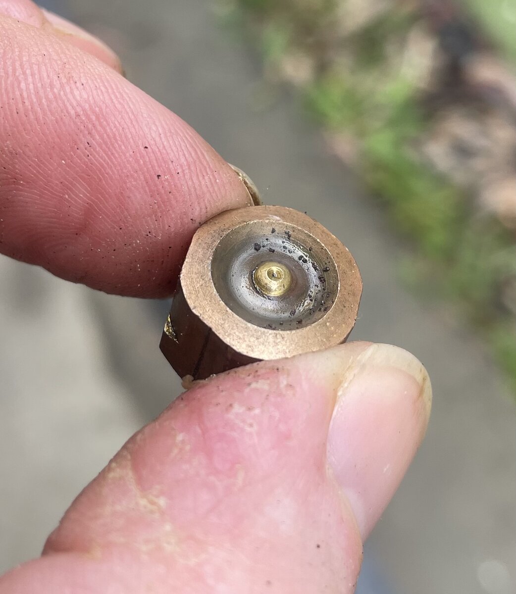

    Does this part have some kind of insert or does it need cleaning? I’m unsure if it’s brown residue or a different material.
    These bits definitely need cleaning!
    Now soaking in lacquer thinner…
  20. WimVe
    3,522
    The rapid jet has no insert. But it should have a jet hole.
    a sfor the two pick ups:
    - the one for the rapid has a small screen filter at the bottom.
    - the main pick up has a valve which has a rubber seal. This seal is now swelling away in the thinner, so you need to replace it.

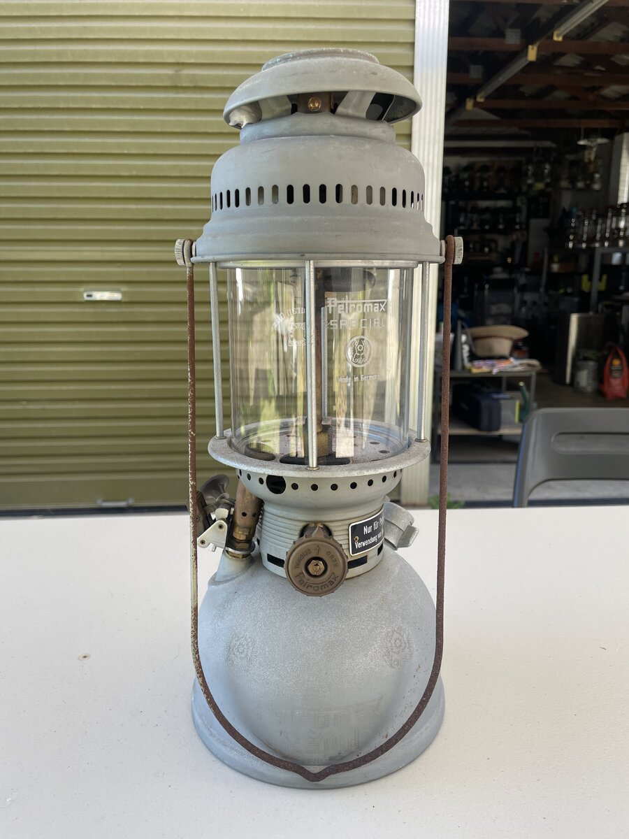

  22. Buckaroo
    Buckaroo Australia Subscriber
    Mar 21, 2020
    446
    Wollongong, Australia

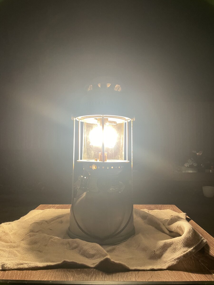

    Success! The rapid preheater isn’t yet working so I added a spirit cup and it fired right up.
    There was a lot of varnish in this but it soon cleared out with lacquer thinner.
    Will wait and see if any kero starts leaking. Running with a butterfly mantle and a modern globe just in case.
    I do like the heat shield!
  23. Reinhard
    Reinhard Germany Subscriber
    Oct 15, 2018
    1,084
    The riser pipe of the Rapid has already been patched. It is certainly leaking or clogged and must be replaced.Get a complete part because old and new Petromax threads do not fit together.
