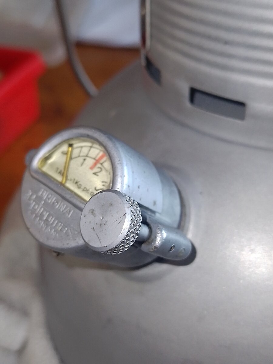

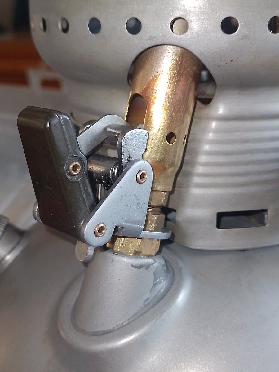

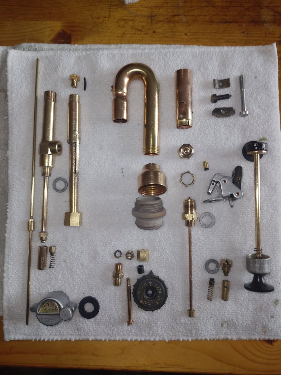

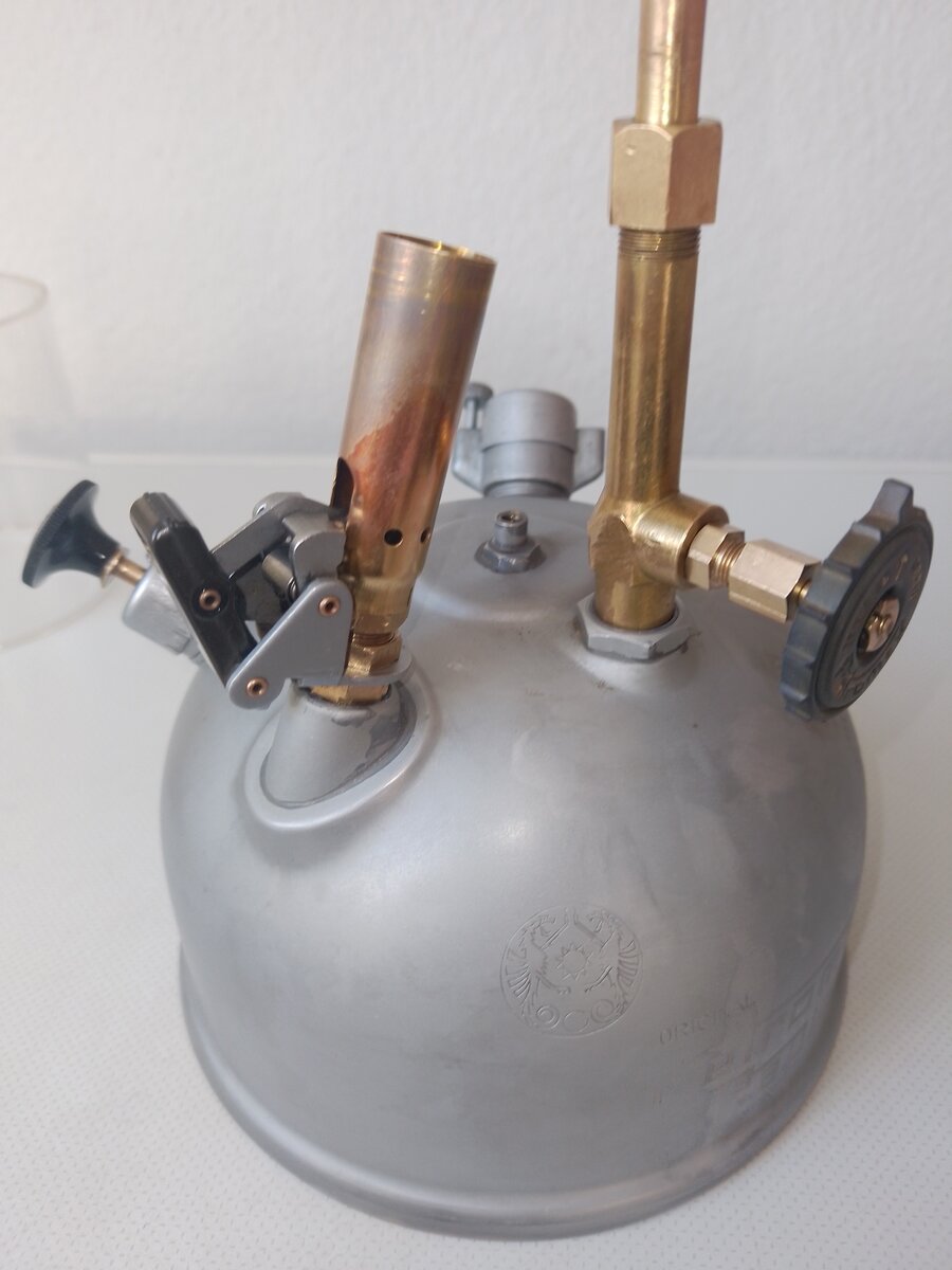

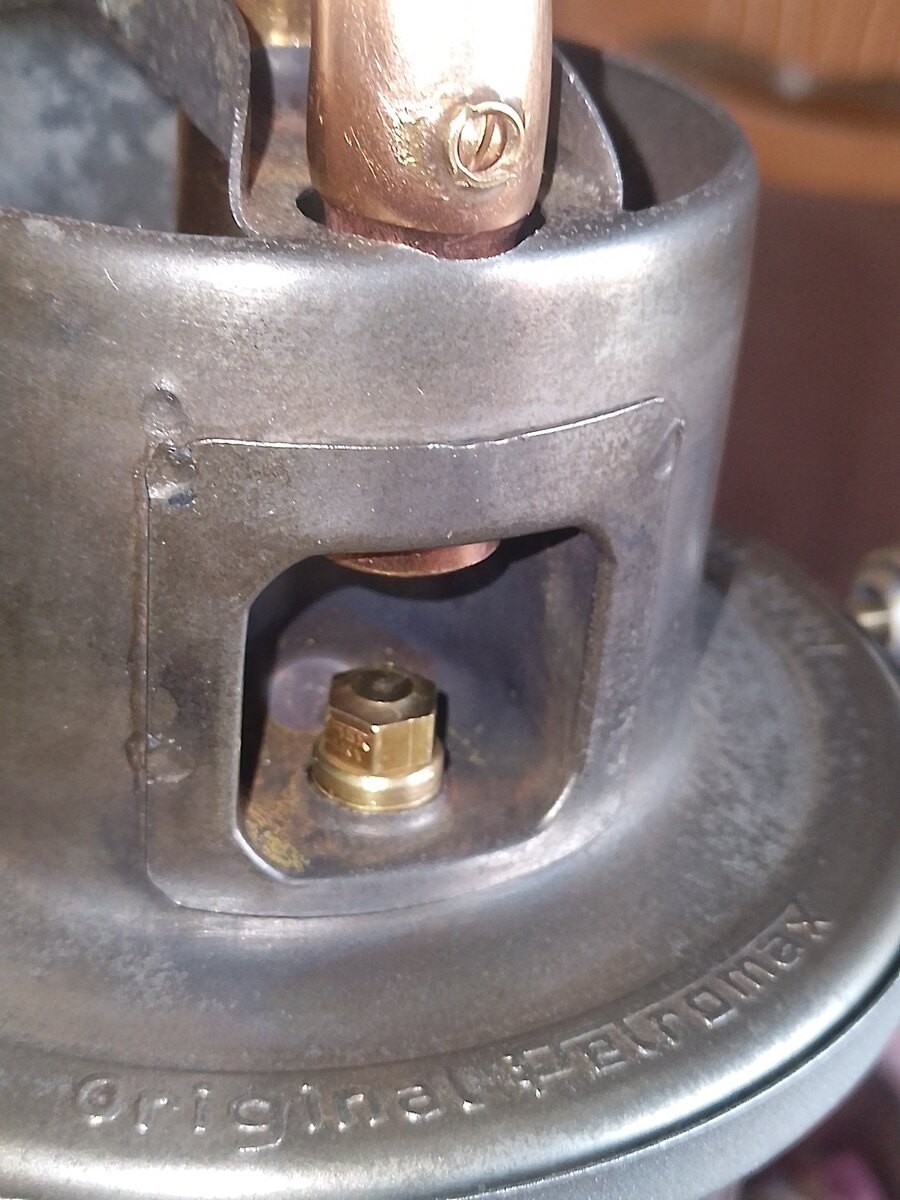

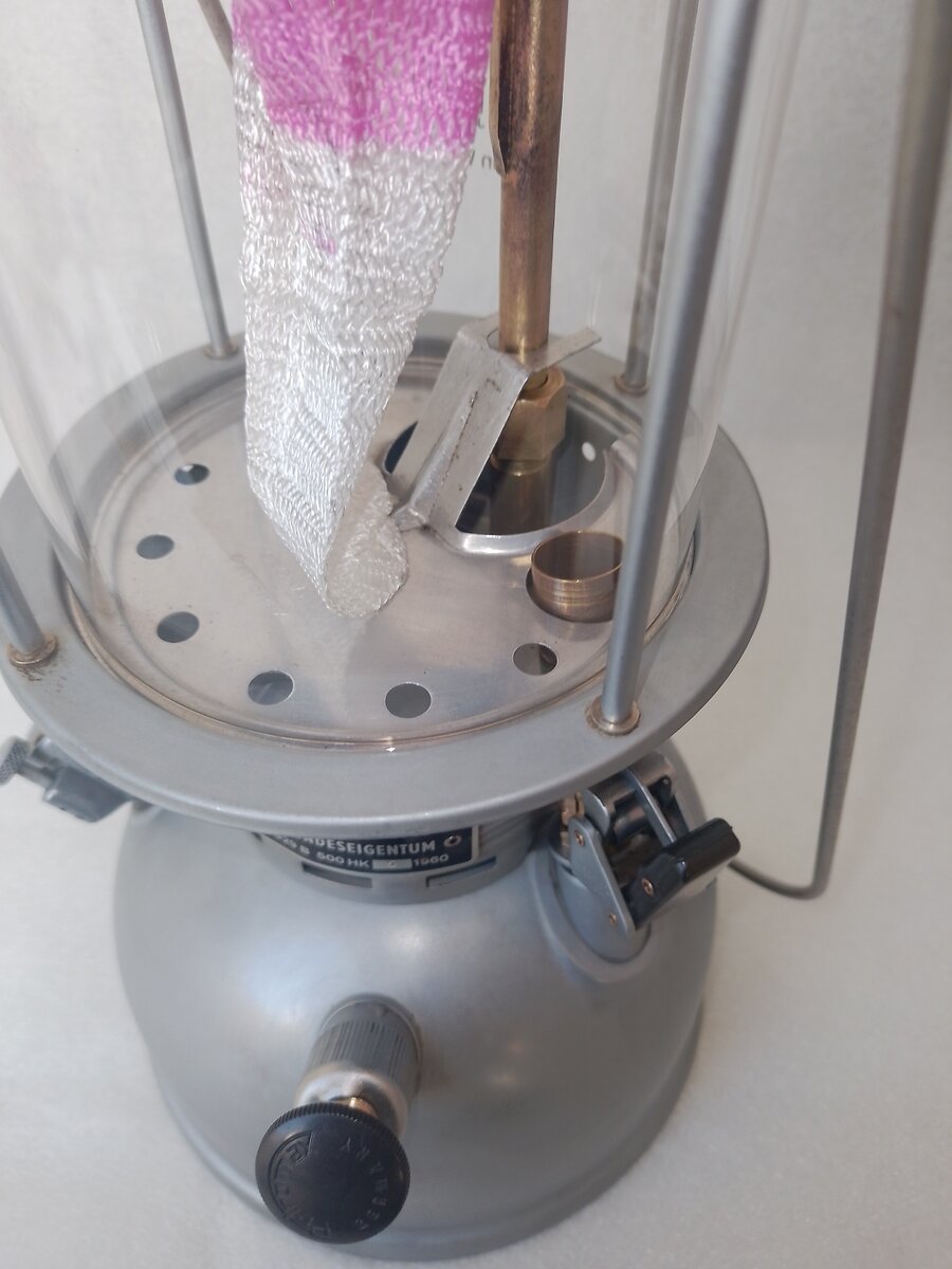

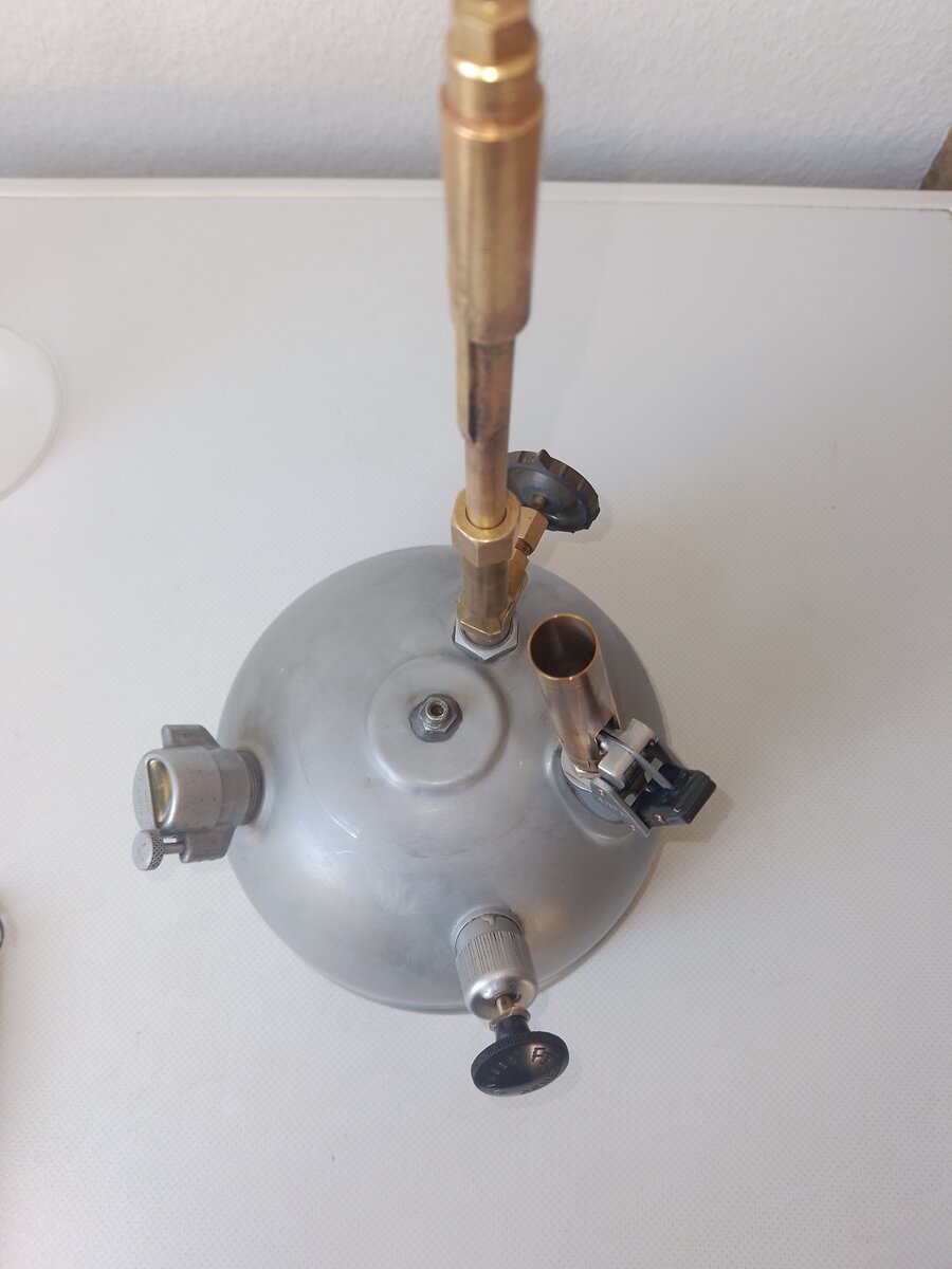

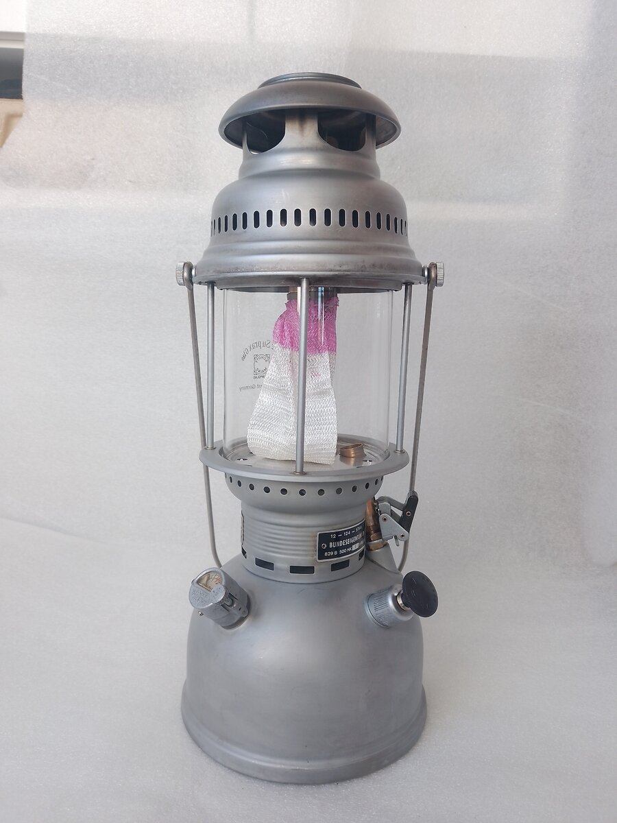

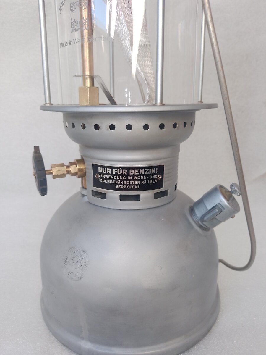

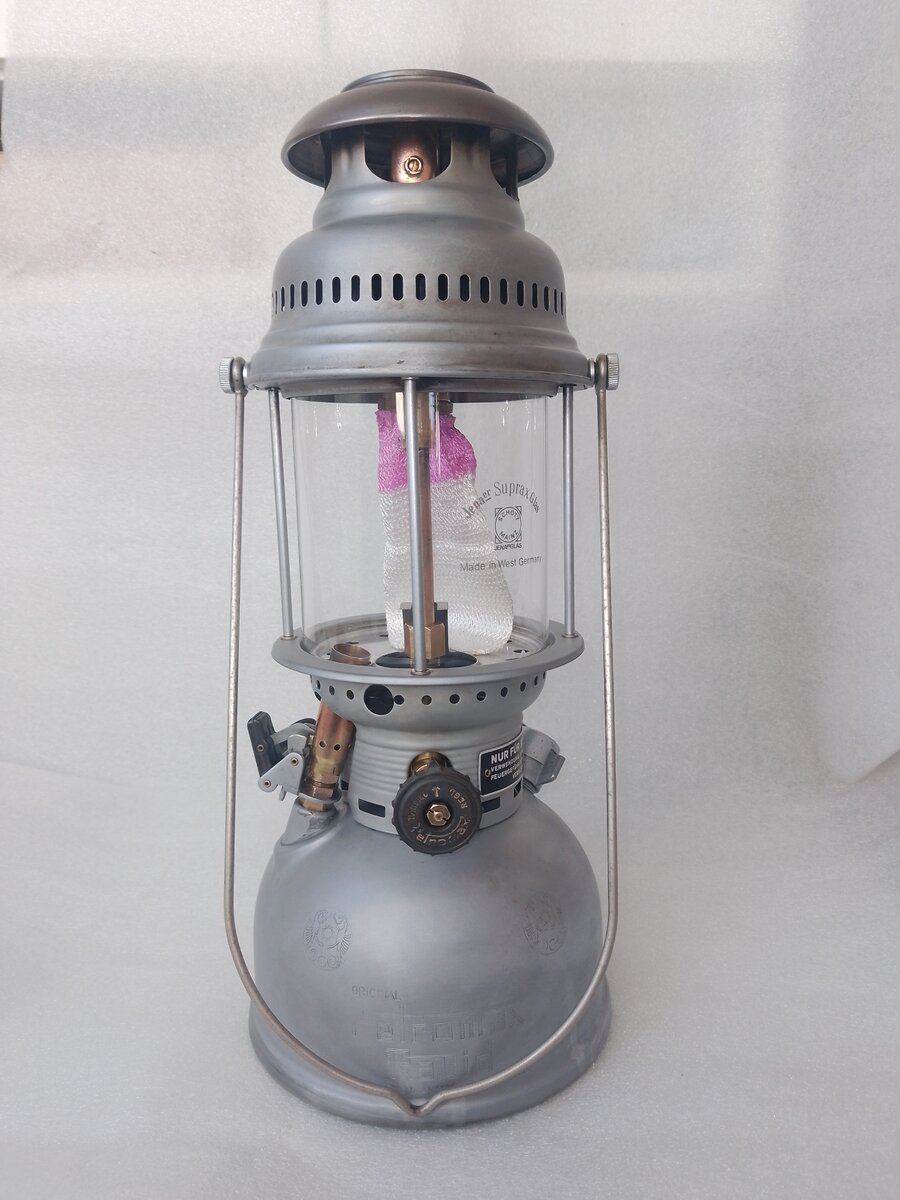

    The German Bundeswehr's Petromax 829B with a petrol carburetor was only available from 1958 to 1960.Until the end of production in West Germany, the Bundeswehr's pressure lanterns did not have numerical Codes on the bottom of the tank. Like all Petromax Rapid made in Germany, these lanterns were not equipped with a spirit cup.The rapid preheater ,called Rapid ,required special attention during maintenance and use of the petrol-powered Bundewehr lanterns in order to ensure reliability and safety.
    IMG_20231015_170620.jpg IMG_20231015_170752.jpg IMG_20231015_170911.jpg IMG_20231015_170852.jpg IMG_20231015_170922.jpg IMG_20231015_164704.jpg IMG_20231015_105431.jpg IMG_20231015_164506.jpg IMG_20231014_204354.jpg IMG_20231015_164410.jpg IMG_20231015_161325.jpg IMG_20231015_161251.jpg

    A splendid example!:thumbup::thumbup:

    Hello Reinhard,
    a beautiful lantern you have presented here!
    The baffle plate (Prallteller) is in my opinion the wrong one, it belongs a baffle plate with raised title block in the lantern.

    @leo
    The baffle plate you showed is older.But consider this : The patent for the baffle DE1256175 was files on December 14,1960.This means that there were no baffles at the time the 829B petrol lamps (1958-1960) were manufactured.
    The glass cylinder is also younger than the lamp.

  11. eiremax
    eiremax Subscriber
    Jul 5, 2014
    628
    Better imagined than experienced...a Rapid Preheater with Petrol:shock:. Fine lantern. I presume used due to heat stains on the Rapid tube, creased mantle etc?
