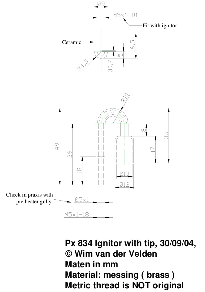

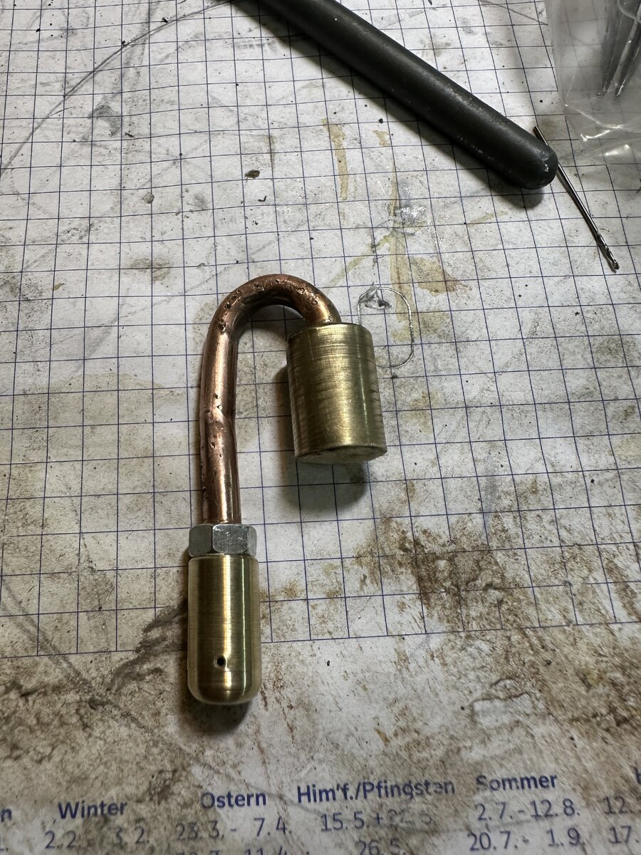

    IMG_2159.jpeg Hello everyone. I have a question about a Petromax
    834. I need a drawing of the preheating nozzle, part number 38 from assembly 49.
    Can someone help me with this? Material, hole diameter.
    Thanks, regards, Michael
  2. WimVe
    3,522
    Here you go:
  3. Atlan Germany
    Feb 29, 2024
    6
    Hello WimVe
    Thanks This is nice.
    What kind of ceramic blank did you use to make this nozzle? Can
    I use brass or something else as an alternative? Steel?
    Michael
  4. WimVe
    3,522
    @Atlan , Michael,
    I didn't use anything, I copied the dimensions from the original.
    I guess you can use any heat resistant material. You may even consider making it one piece with the upper part.

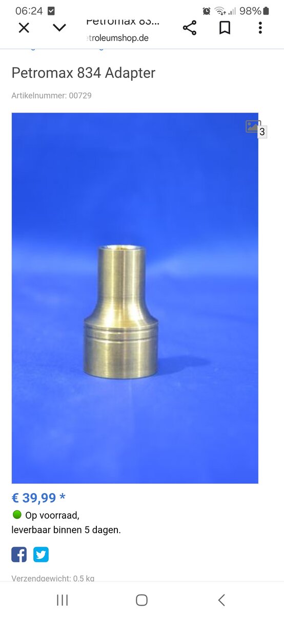

  5. Atlan Germany
    Feb 29, 2024
    6
    I have one more question for you. I need an adapter to the 250 nozzle of the newer version. Do you have a tip for me. Thank you Michael
  6. WimVe
    3,522
    I am sorry but I can't help you with that. I restored a complete original.
  7. Johan Osinga
    Feb 24, 2015
    107
    @Atlan
    You can buy them on:
    Petroleumshop.de

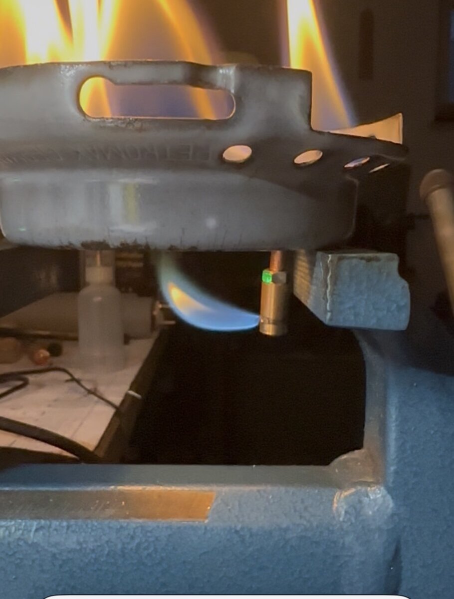

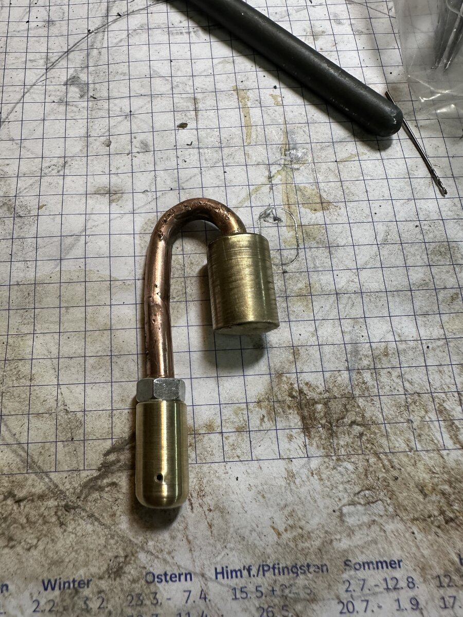

  8. Atlan Germany
    Feb 29, 2024
    6
    Hello VimVe.
    Thanks, I rebuilt it and it works wonderfully. Greetings Michael
