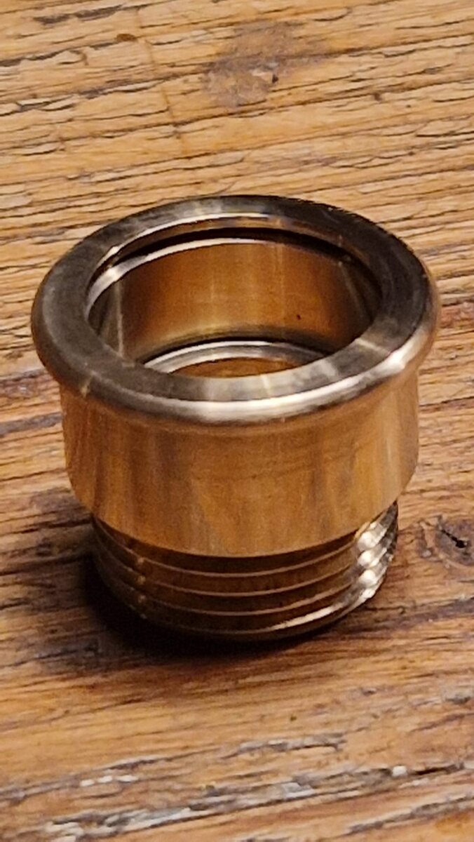

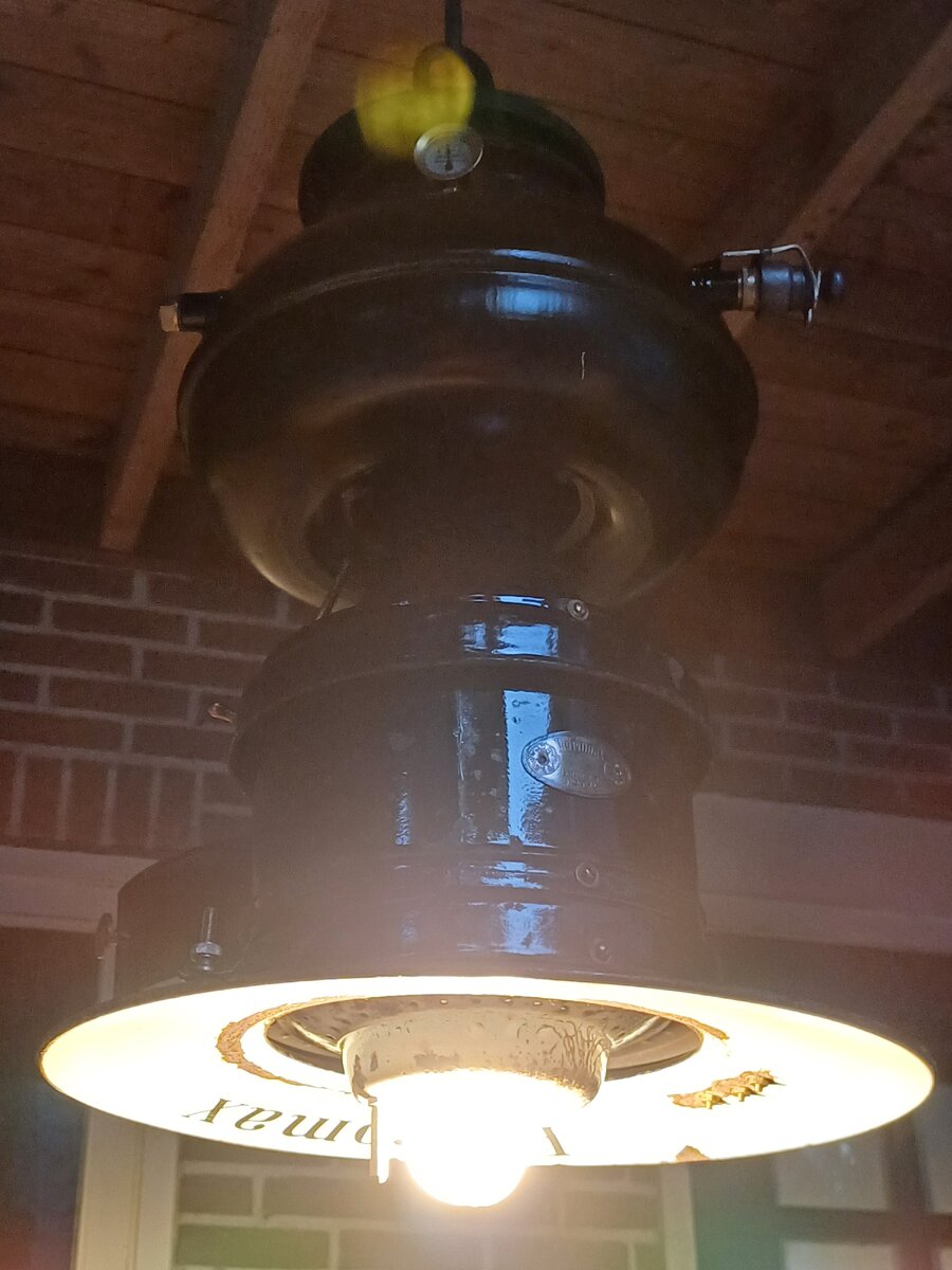

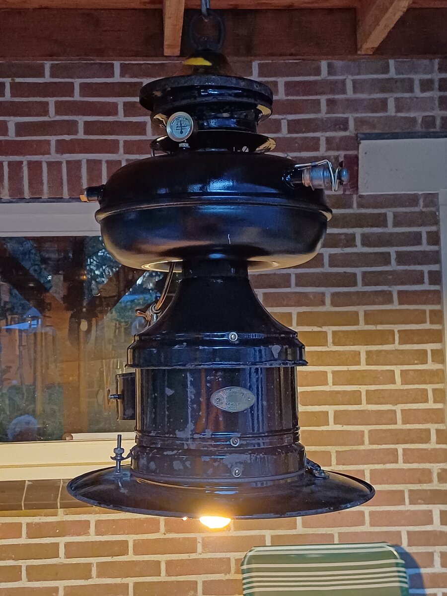

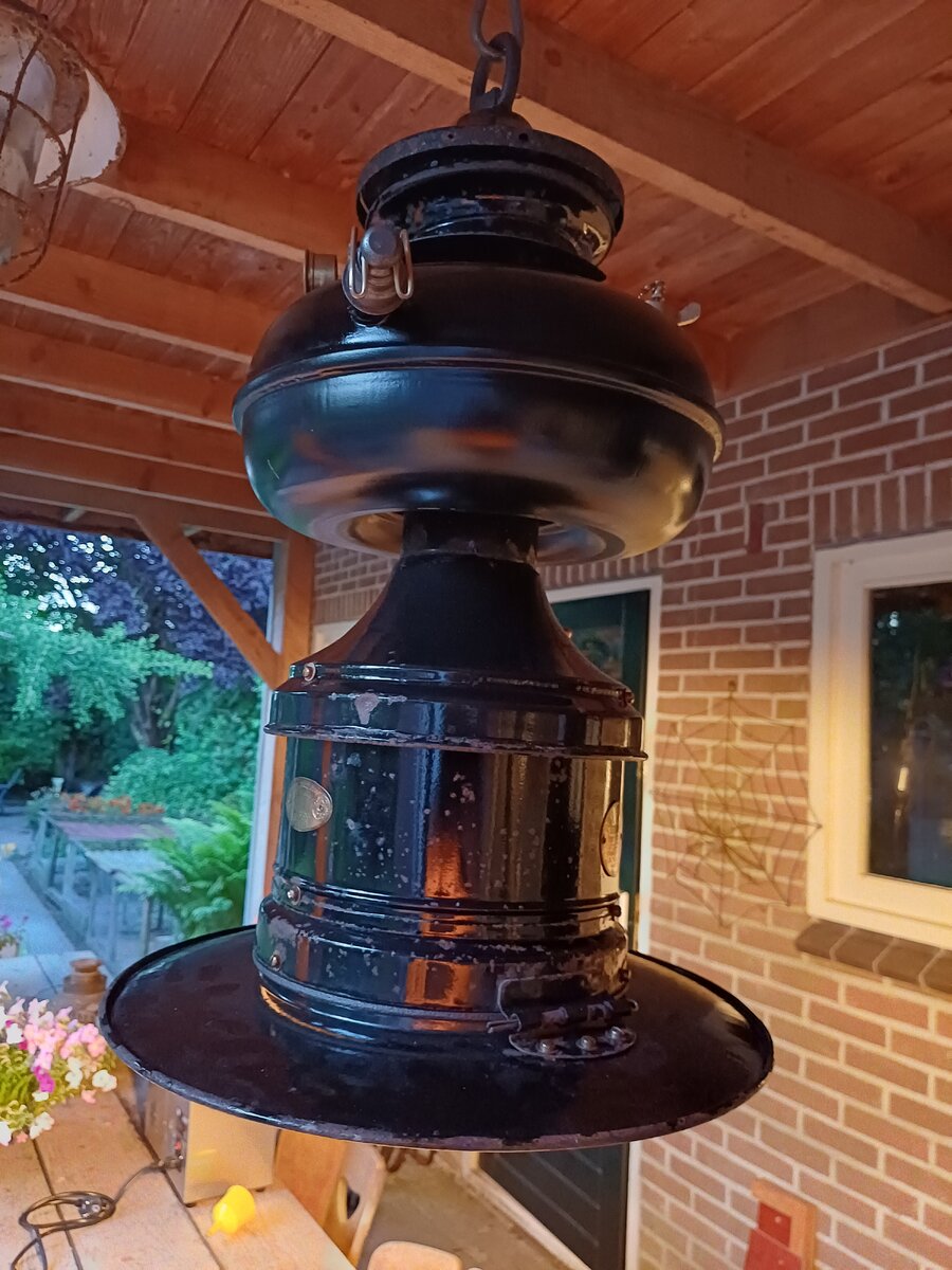

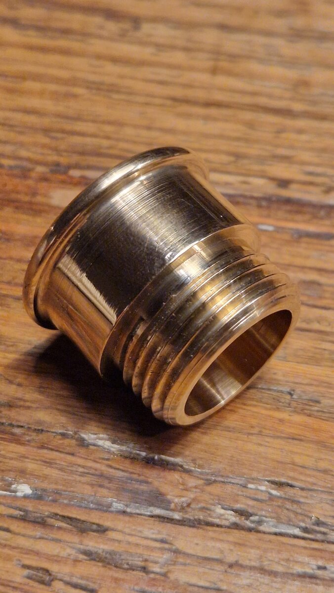

    Found this Petromax some time ago. It needs a very good cleaning, and I painted the fueltank. The burnerhead was missing. A very nice friend made a new one for me.

    Very nice looking lamp, @Johan Osinga.
    Am I correct in assuming that because the tank needed cleaning it was steel? (I’m also assuming it does not have a pricker mechanism).
    I hope you’re able to get a glass for it.
    Best regards

    Yes, that's correct Tony. The tank was made of steel. The former owner did some repairs on the paint, and at some places there was no paint but rust. That's the reason I decided to clean the rust, and repaint it.

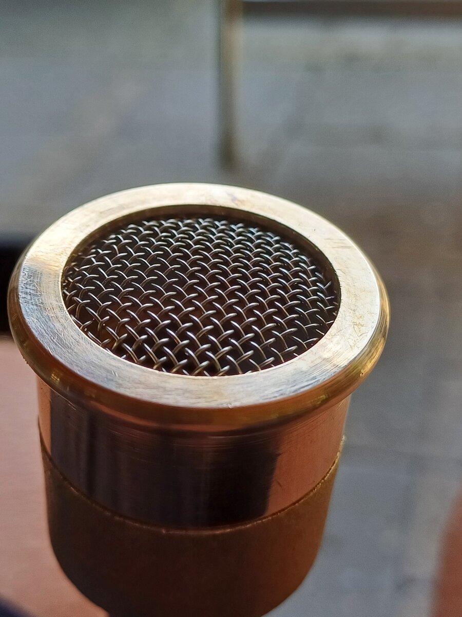

    @Johan Osinga
    Is the burnerhead in 2 parts ?
    This is the idea I have so I can install the explosion-proof grill.
    Regards.
    Gilles
  6. Carlsson
    3,960
    This is a common way to install the gauze into the burner head.
    As with Primus, the spare gauze is cupped when you buy it, and that means that it passes by the rim of the burner/mantle holder to its seat. Once seated, you push it slightly, and the gauze flattens out and get attached into the little groove of the burner.
    Hard to explain in words, but check this post to get some visual ideas.
  7. Sellig33
    Sellig33 France Subscriber
    May 15, 2017
    1,049
    @Carlsson ,
    The explanation is perfectly clear, and I understand better how to install a replacement gauze.
    Thanks for the link.
    Regards.
    Gilles
  8. Johan Osinga
    Feb 24, 2015
    107
    That's the same way I did. A friend made the brass burnerhead. The gauze was made myself of stainles steel. I bend it a little. When cupped enough it will fit in the burnerhead.

    Very nice lamp Johan, very good job for the burner. But why? Was the mixing chamber worn out? All my 836 use the normal PX 500 burner. They are original and best running... If you need a glas, pm me.
  11. Johan Osinga
    Feb 24, 2015
    107
    The original 500cp ceramic burnerhead was not tight enough fitting. The missing chamber is in very good condition. That's the reason I decided to place a brass one .
