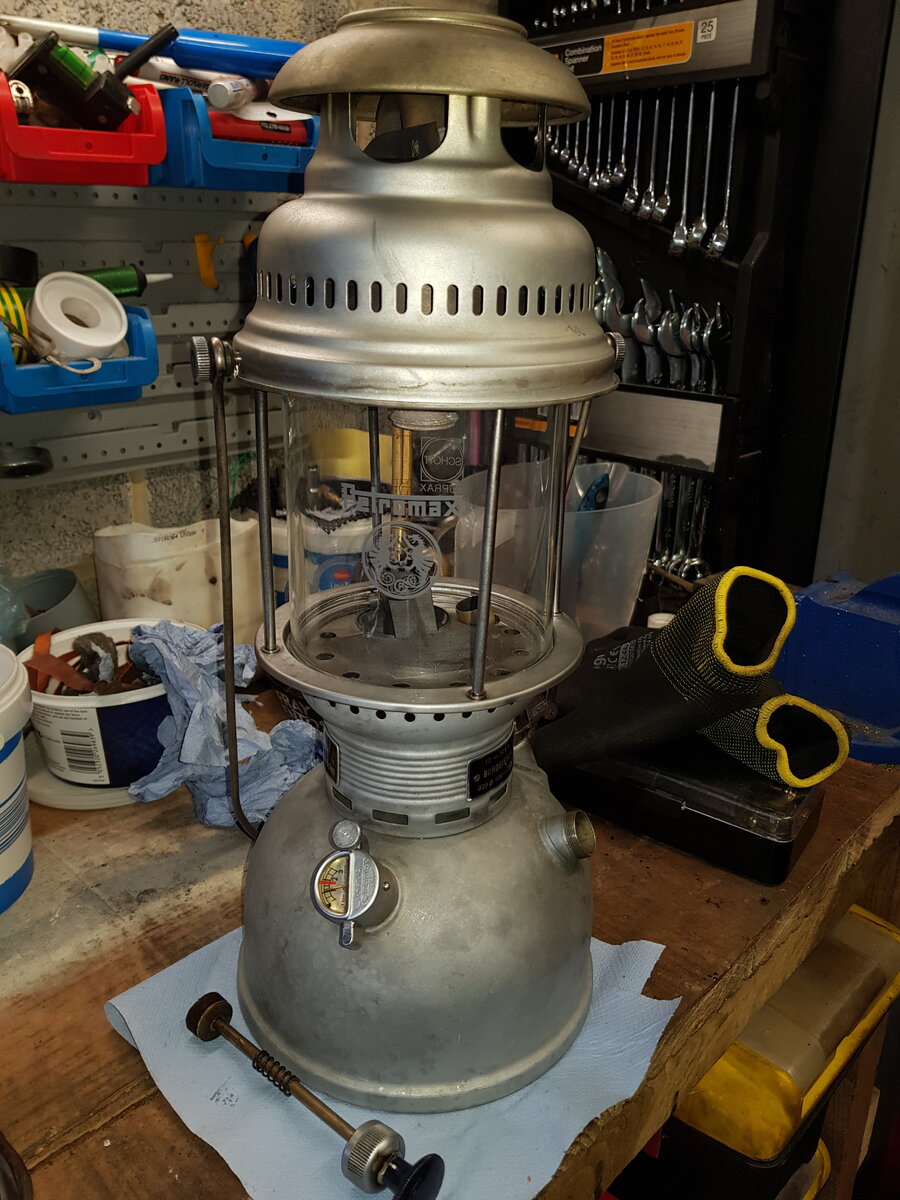

    I wanted to own a German made Petromax, looked on e-bay and even wreck's are fetching daft prices, so I bought an ex army one from the German site.
    Reasonably tidy lamp with a few small issues to tweak up.
    Gave it a clean checked it was pressure tight and gave it a quick go, I know they are bright but I didn't expect that bright, I looked at it and couldn't see for ten minutes, I wonder of the jet is a bit worn and giving out too much paraffin.
    I noticed a couple of things which need looking at (valve spindle is bent) so I took it down again and managed to bust the mantle, cleaned out the vaporizer and fitted new foot valve seal, cleaned up the quick starter and added a new seal.

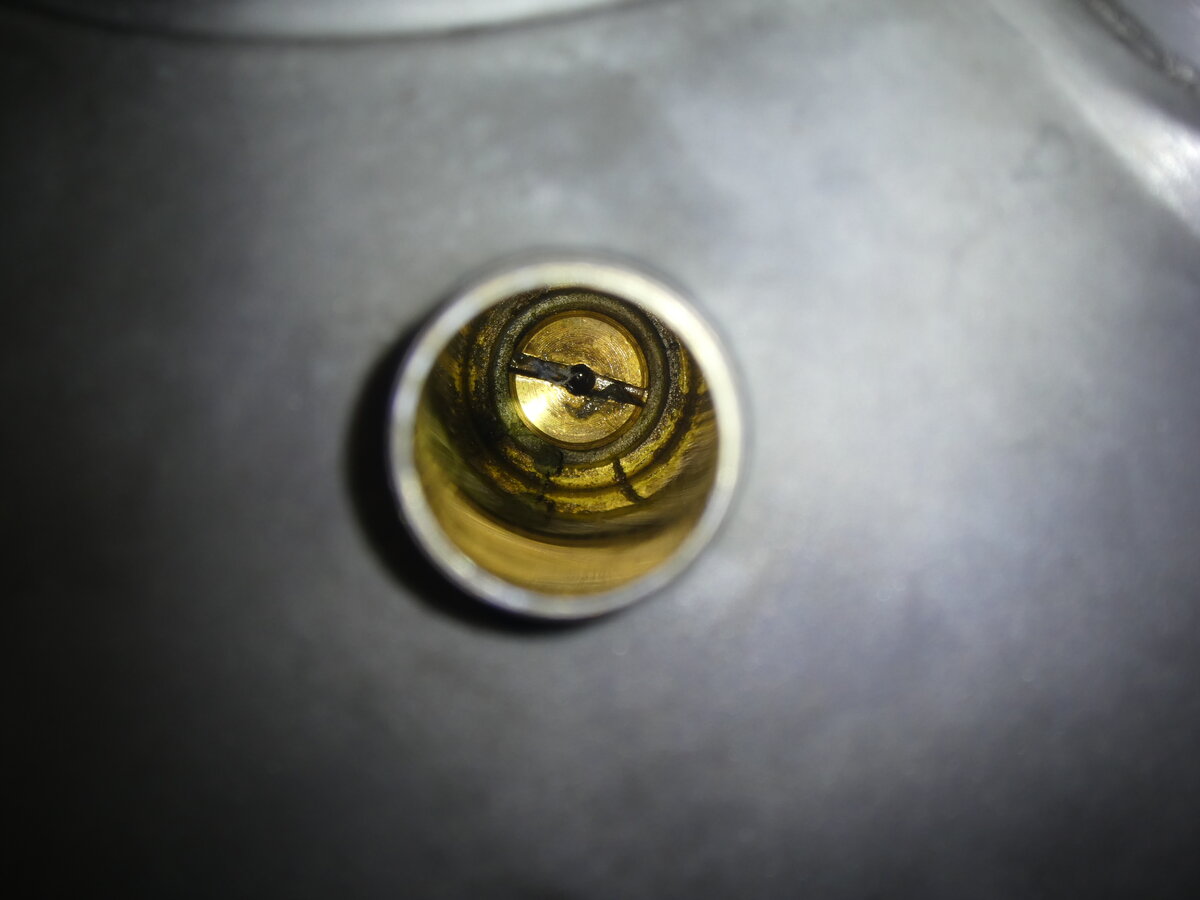

    Two things I noticed,
    The pump NRV is outside the tube and I can't see how it can be serviced.

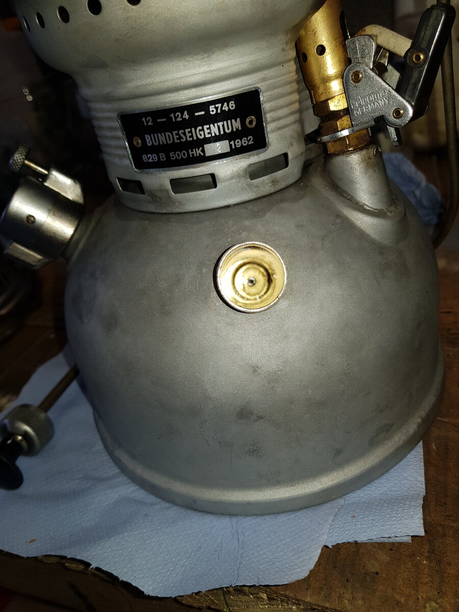

    There is no spirit cup on this one, was it lost or do some of them not have one fitted.

    Those are well built lanterns and not all of them were fitted with meths cups.

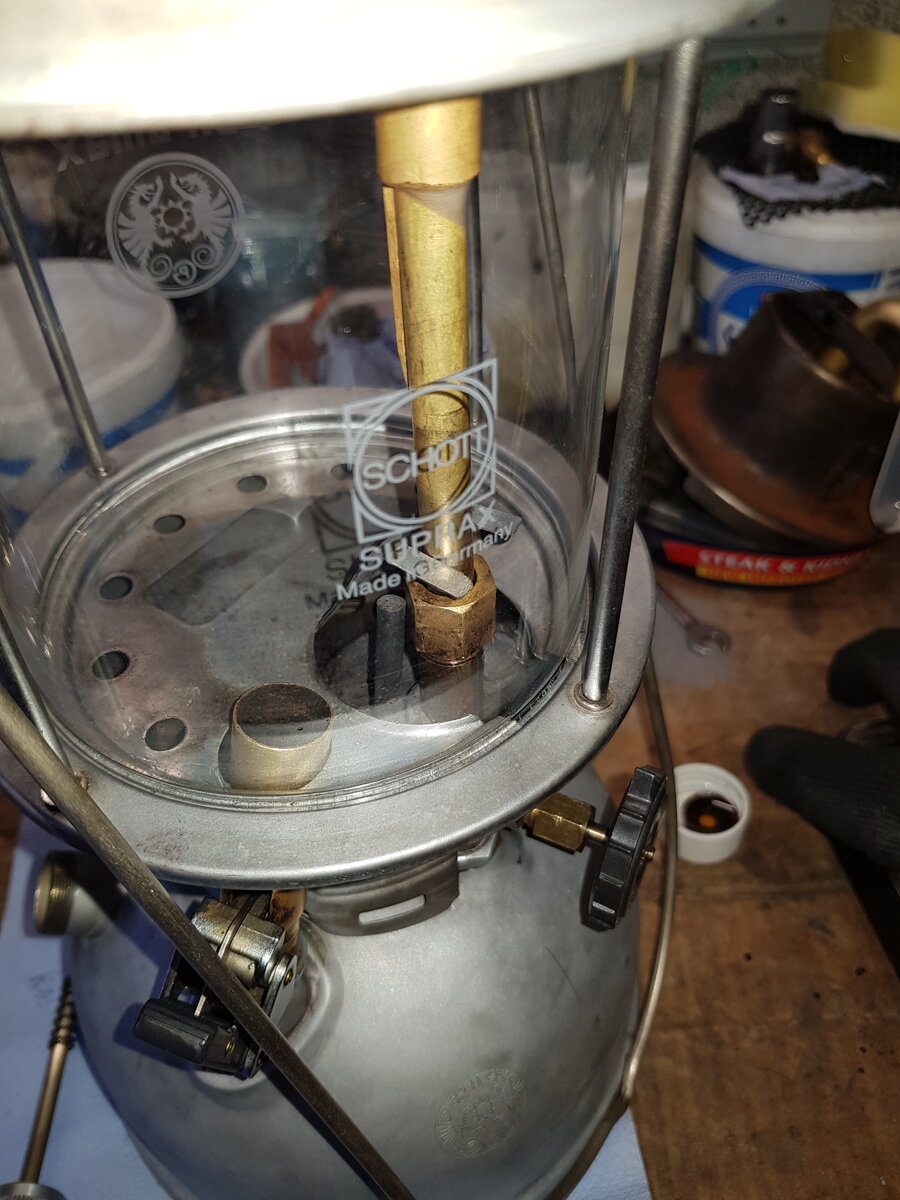

    What is that object which is sitting on the tank in the second picture?

    Second picture is taken with the pump shaft removed to show the bottom of the pump tube.
    Not sure which object you mean.
    Henry
    I don't remove the valve, picture is not fantastic, but looking down the pump tube that's as it was when I stripped the pump out.
    There must be a NRV in there because it holds pressure when I pump it up and left it for about 45 mins
    I will try to get a better quality picture down the pump tube tomorrow.

    Fantastic lanterns, extremely versatile. Bundeswehr lanterns such as this was finished in a matte nickel finish and were not issued with an alcohol reservoir. The NRV is threaded into the bottom of the pump tube. A dash of wd40 plus a good size straight edge screwdriver will remove it. Any amount of takedown videos on youtube to guide you.

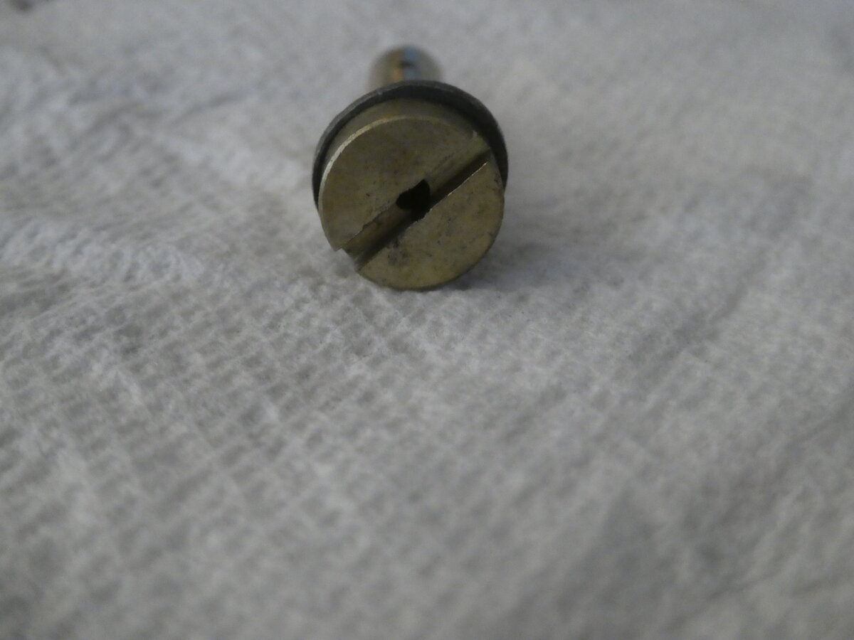

    The lamp had a spare NRV iwith lead washer in the kit with it, and it has a slot across the top making it obvious how it assembles, maybe my eyey are worse than I thought but I can't see a slot or any other means of removal in the existing assembly.
    I'll try to examine and photograph it tommorow, hopefully it's just filled with gunk or a trick of the light.

    Since you got a spare valve: is it possible the head is twisted off of the pump valve? This would explain the picture we seem not to reconize.
    When there is no pump valve: the is a big hole at the end of the tube where the valve should be fitted.
    If the head is broken off you get a "falt" surface with the small (air) hole.

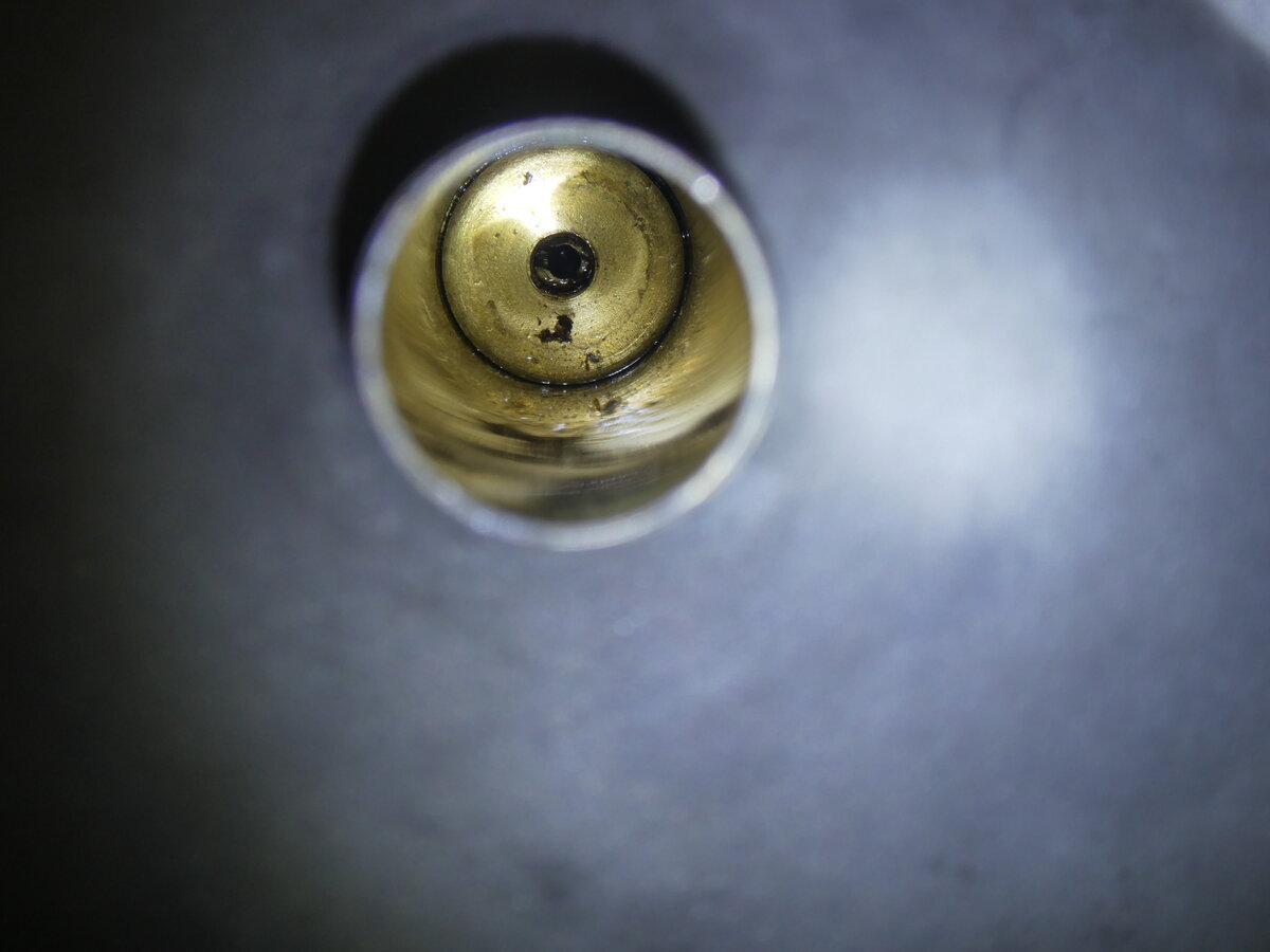

    Today I took some pictures with a better camera which show more detail you can zoom right in as they are quite good resolution
    Now its possible to see what is in there this is what is confusing me
    End of the spare NRV looks like this

    Looks like a broken NRV to me. Dose in WD40 and try a get a small straight edge screwdriver and try and entice it out.

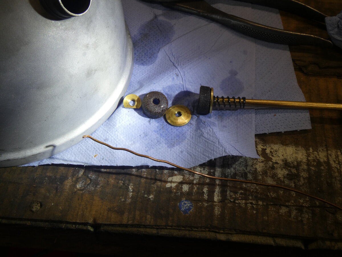

  20. rayw United Kingdom
    Sep 13, 2020
    457
    Mystery Solved
    I spent time looking at drawings pictures and considering what people had shared with me here, so I tried a long screwdriver down the pump tube and the brass plate in the bottom moved slightly.
    So I made a hook from copper wire bent over slightly at the end, and Shure enough the hook took hold of the brass plate and pulled it out, all became clear.
    in the bottom of the tube covering up the NRV was a pump washer complete with retaining plate and backing plate, obviously it had become unscrewed and fallen off, then someone had taken out the pump shaft and seen the end assembly was missing so they had just put a new assembly onto the end and pushed it back in without checking the tube.
    so what I had been looking at was the back of the washer backing plate.
    Now I can see what I expected to see in the first place
    Thanks everone for your input
