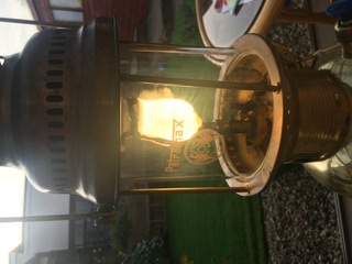

    Hi
    I have had some issues with this lamp, not burning evenly, lots of black soot etc I stripped it down and noticed the jet was partly blocked and the pricking pin bent
    I straightened the wire cleared the jet and reassembled put a new mantle in and tested all seemed good, well mostly
    The mantle burns brightly however the light pulses bright then dimmer about once a second
    If I turn the control knob down I can just about get to a point where the pulsing stops this is a tiny position, a fraction of a turn up and the pulsing starts a fraction down and the lamp goes out if I get the sweet spot the lamp will run smoothly for a few minutes then go out if I don’t quickly turn up, then the pulsing starts again
    not sure what the next step is
    The lamp is half full of paraffin
    The pressure is good and steady
    The mantle is a petromax one
    many thanks for any suggestions
    Simon

    A 500cp or hk Petromax should burn a lot brighter than what is shown in your picture above.

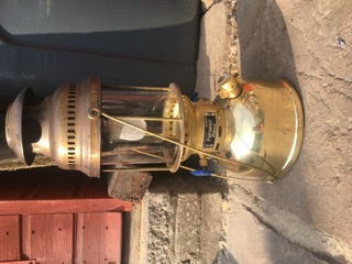

    Can't focus too well on the picture but is this an original German Petromex or a clone?

    If this is a new lantern, am I correct to say this is the bare-brass version of the current Petromax range of products?
    If so, this is not exactly the original Petromax produced by Graetz of Germany decades ago.
    But that does not necessarily imply that its not as good.
    From the picture, I was earlier thinking its an old Petromax that was stripped of nickel plating.
  24. spike589715
    Jul 27, 2014
    67
    Hi yes a new (last 5 years) brass version says Germany on it and original .... probably made in China ?
