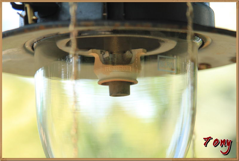

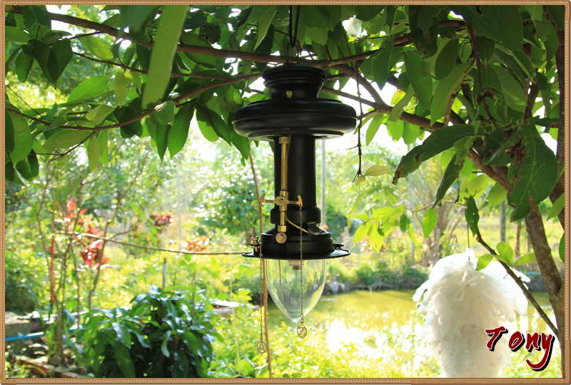

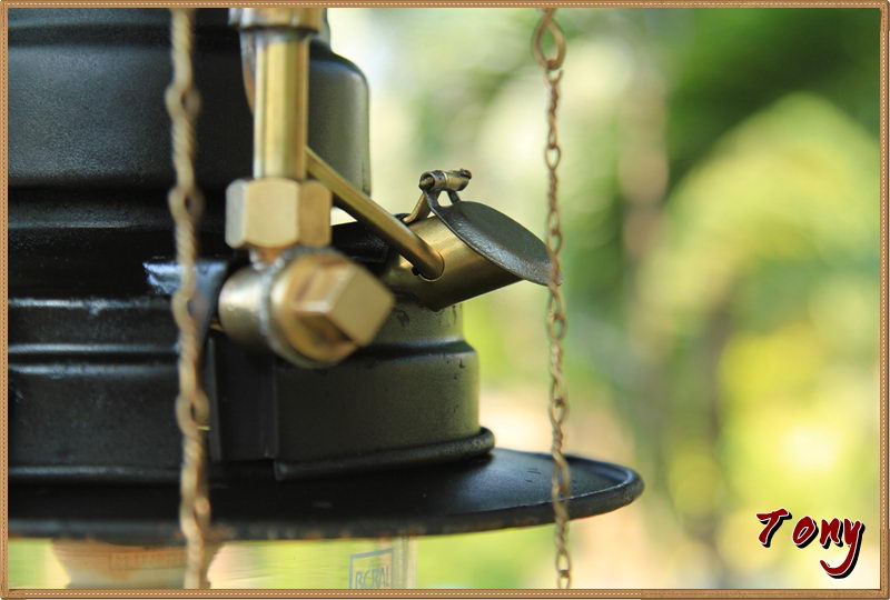

    Petromax (Graetzin 915H).
    From references http://tgmarsh.faculty.noctrl.edu/lantern/intllampeo.htm
    After completion of the adjustment. Minor repairs.
    What's recommendations suggested.
    Thank you.

    Nice condition but I can see that the globe you fitted there has a hole on the bottom end. I have one of these and, even if I still didn't light it, I made some research.
    You need a completely closed globe on the outside and a second globe on the inside opener on both ends. There are three tags on the pre heat cuvette, visible on your pics, to attach the inner globe there and at least it will give you an idea of the globe diameter; I know that Wim Van der Welden adapted a Feuerhand globe for this.
    I know that both globes, the external one close and the internal one open, generate a proper air flow from outside to inside and then through the chimney for the proper burner working.
    Have a tour here: Link
    Juan

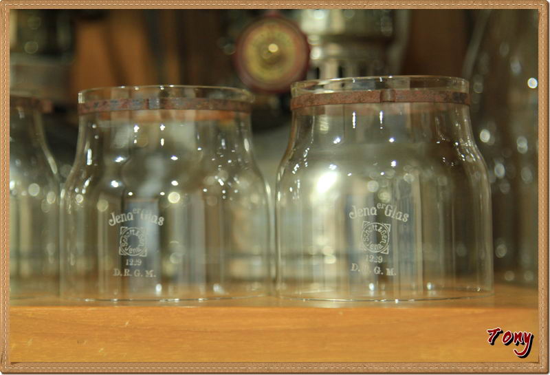

    I think inner globe is this type.
    and hard to find.
    Thanks

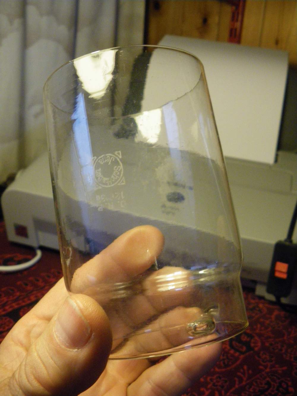

    hello Superman
    perhaps I have the glass who need ??

    Wow!....This is difference glass other than that ever seen.
    It look like longer.
    Thank you for your guide to me.
