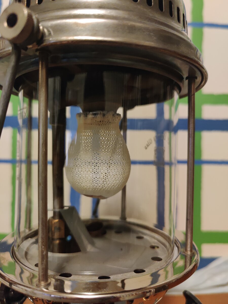

    So I ran out of petromax mantles and only had the midstate lighthouse branded no. 625 mantles and while it filled up beautifully, my main concern is the final size it has after firing. Should I worry about possible overheat?

    No you should not.
    Use the correct shape and size (CP) the brand is of no concern. Quality aside.
    In fact the flamefront or flameshape will form the mantle.
    Other fact is how the mantle folds are distributed around the burner head.
    What would be overheated or overheating do you think?

    I'd say that should be the correct size for a 500CP lantern, and pretty well shaped. So no concerns.

    At 2.5 to 3 bars. Shutting it off reveals parts of the inner case and J-tube glowing a dull red. At 2 bars, it's less apparent and only the nozzle glows.

    When alight for some time metal part get hot yeh, but that is ok.
    Nothing to worry about.
    When the tank gets dull red then it is time to start running.....

    The Midstate Lighthouse #625 mantle does not seem to be too large for your Petromax.
    Basically, there should be no overheating concerns from this alone.
    The more worrying part would be the extent of the J-tube's glowing. At most, only the lower end near the ceramic burner should be glowing from normal operations. Anything more extensive would be damaging to the J-tube.
    You should check if there is any flame outside the mantle, indicating a worn jet/gas tip or other anornalies.
    In some instances when you are operating the lantern with a higher-than-normal pressure range, a slightly worn jet can produce a somewhat higher output(visually brighter than the usual ratings) without indicating a rich burn or producing any sooty leftovers.
    For the unwary user, this can certainly overheat the lantern parts by excessive heat output.
    Not sure if this applies for your lantern here.
