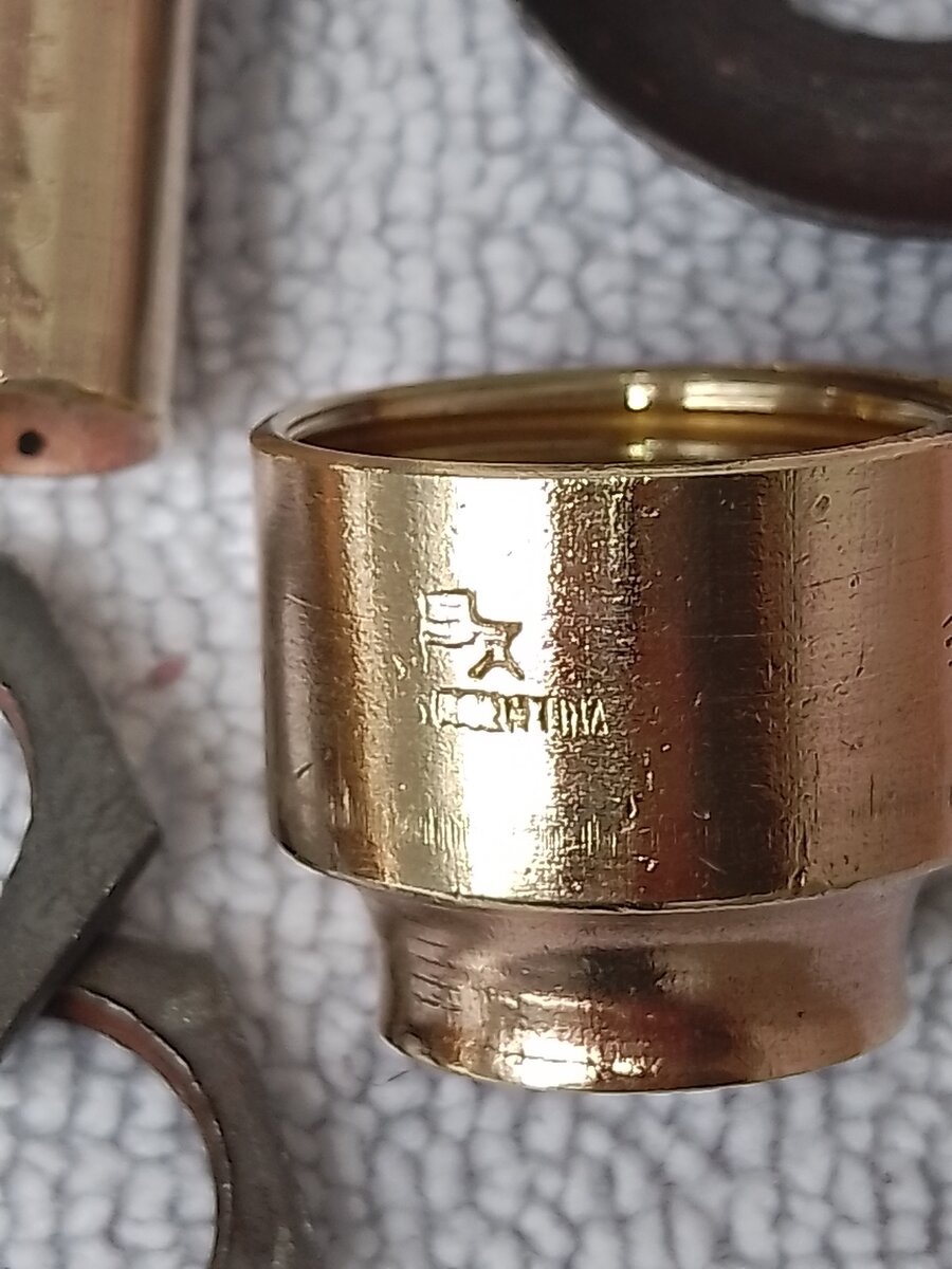

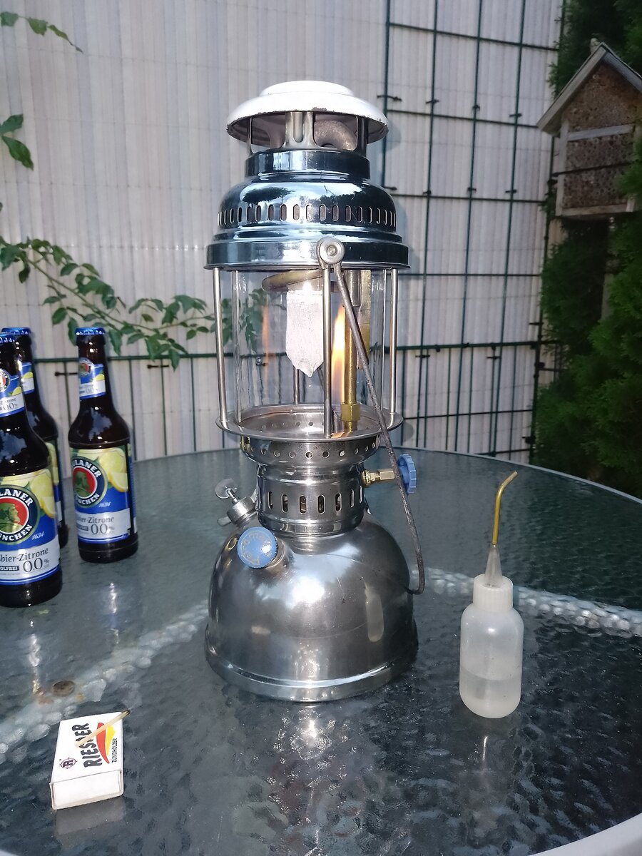

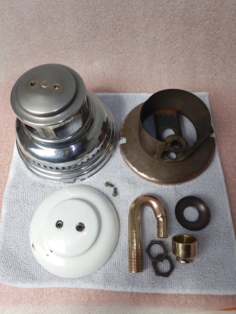

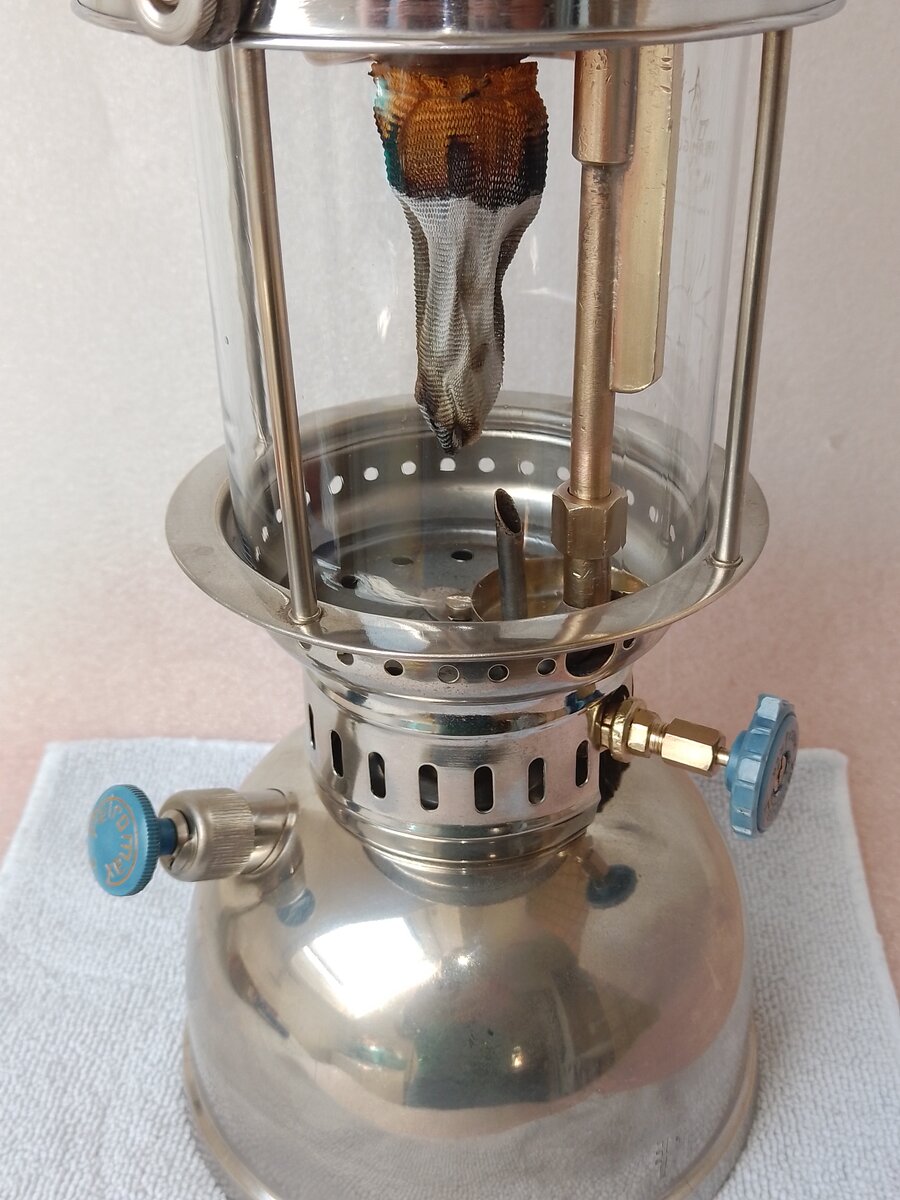

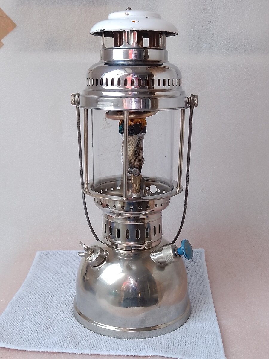

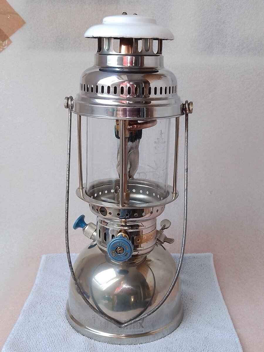

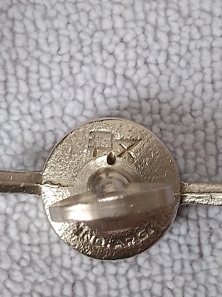

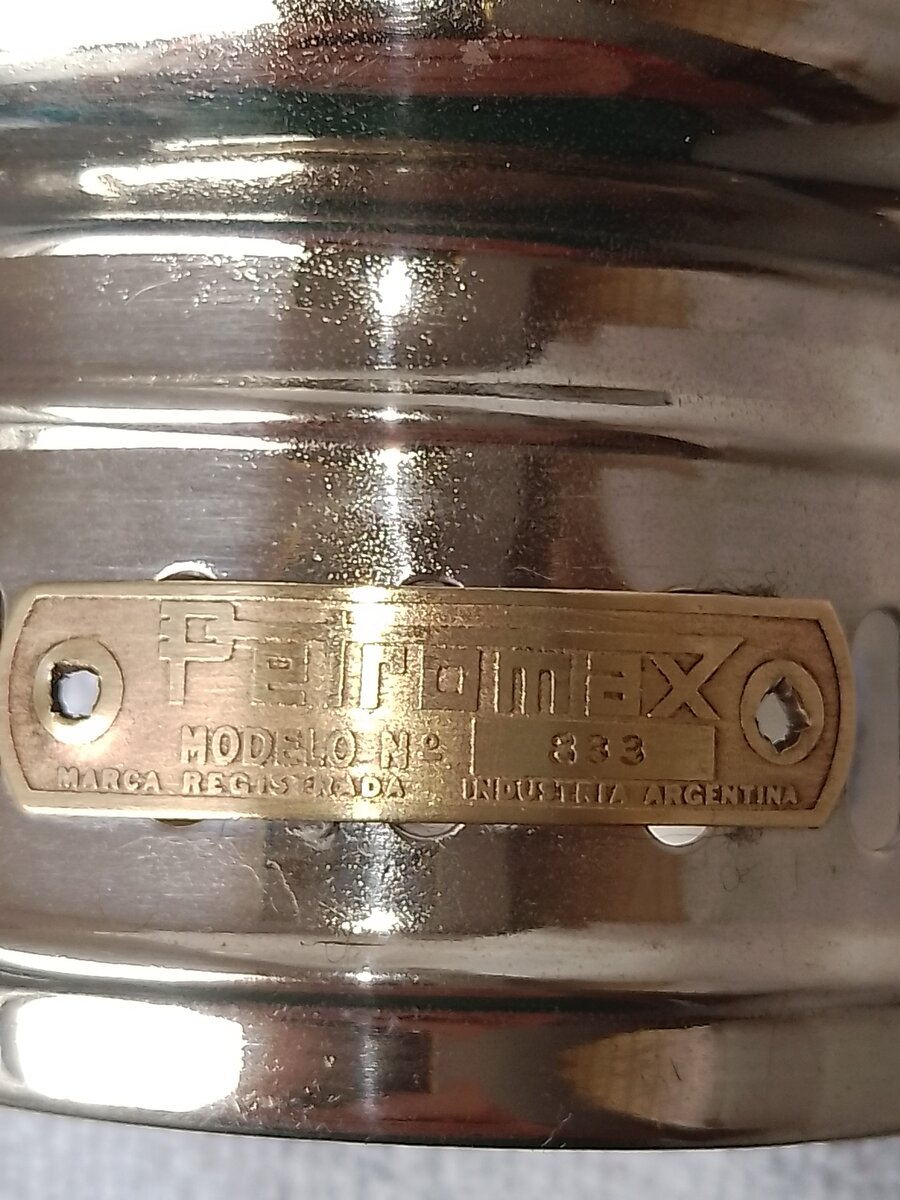

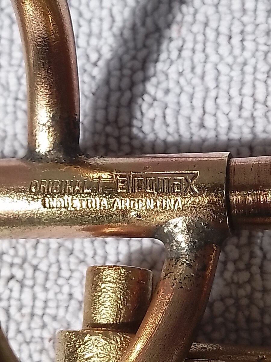

    Petromax Modelo No 833
    Marca Registrada Industria Argentina
    Found in Italy
    Control knobs in light blue and the hood cap in white enamel like the Argentine national flag.

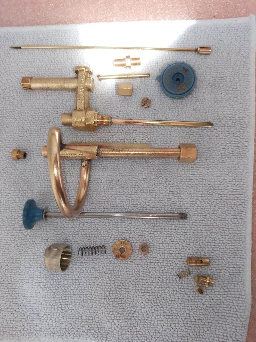

    The 833 is made of brass and nickel-plated .The pressure vessel and the inner casing are reminiscent of German pre-war models 826/523.

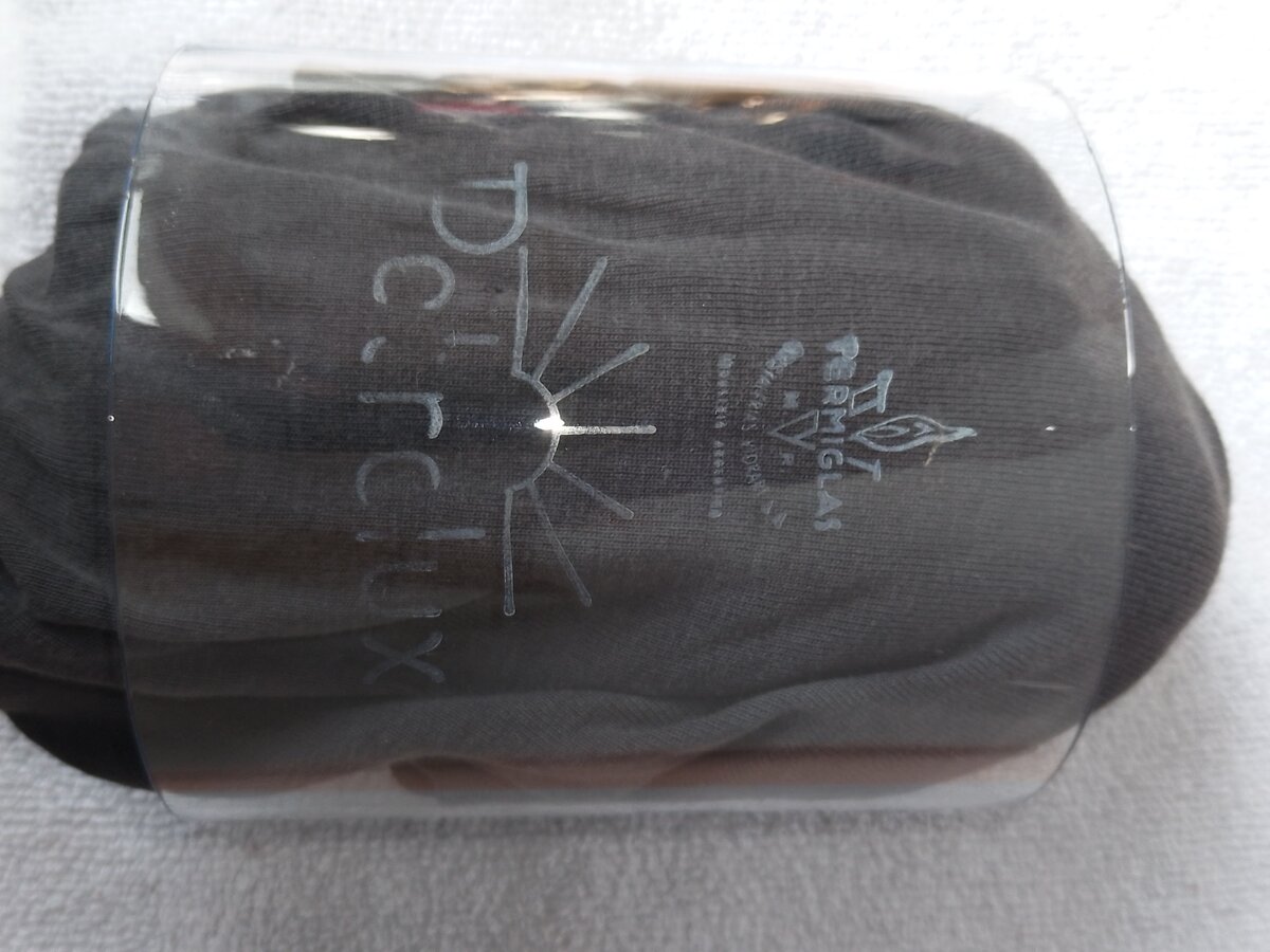

    With original PX jet and the Petrolux glass cylinder is made in Argentina.
    The 833 has no foot valve and no regulating screw in the J-tube.This 833 lights up perfectly.

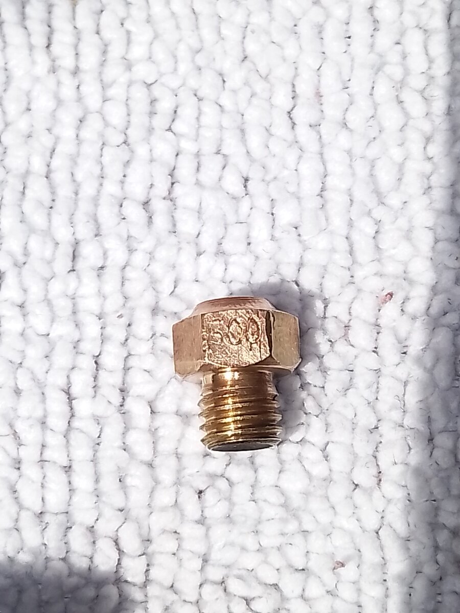

    This Argentine PX 833 has no date markings.
    The reinforced vaporizer top and the 500 jet indicate that the Argentine Petromax No 833 is a 500cp lamp.

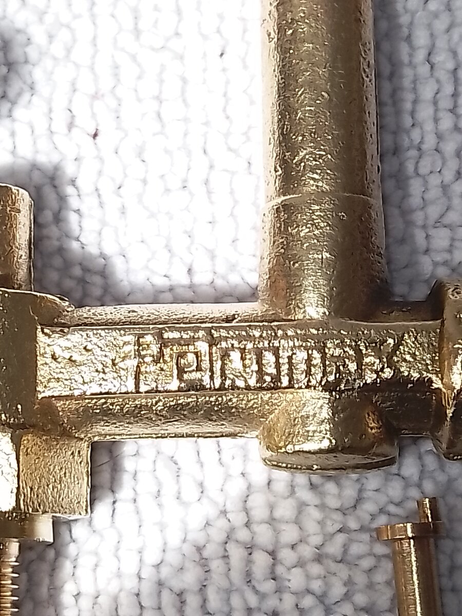

    This Argentine Px833 share some features of both the earlier pre-War and post-War Petromax from Germany.
    Althought almost similar in overall appearance, it is not 100% identical to the earlier pre-War units from the Treptow, Berlin factories.
    The inner hood/J-tube/burner support is different although there are two screws on the top cap. The 'fin' on the Preston loop vaporizer is extra large and located outside-facing.
    The outer hood and vent seems a bit taller than the 1930s German Petromax. The oblong slots on the hood appear to be slightly longer and more similar to post War units made in the Altena factory.
    The pricker control wheel and pump knobs are basically post-War style.
    I wonder if the blue pigment in the plastic would darken like those from Germany.
    I figure this Argentine Petromax was made after the War.
