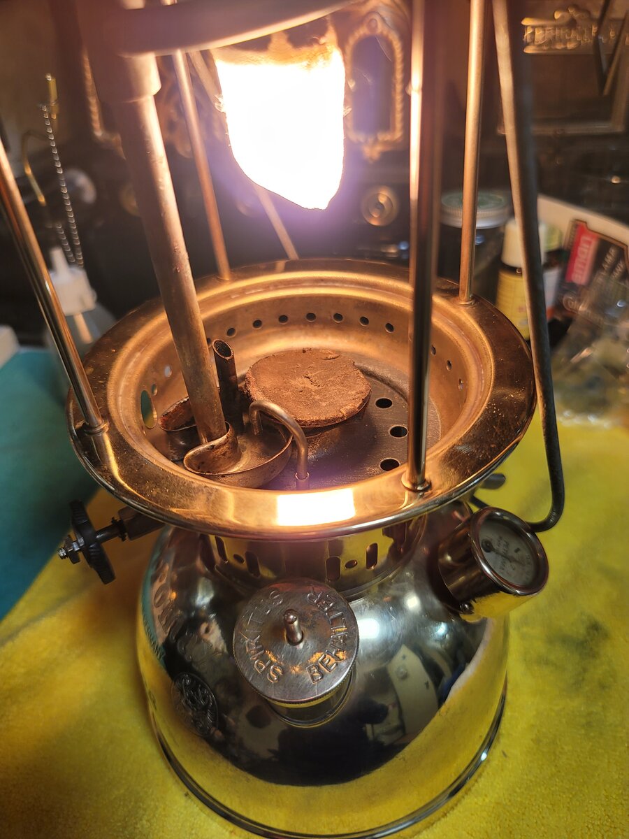

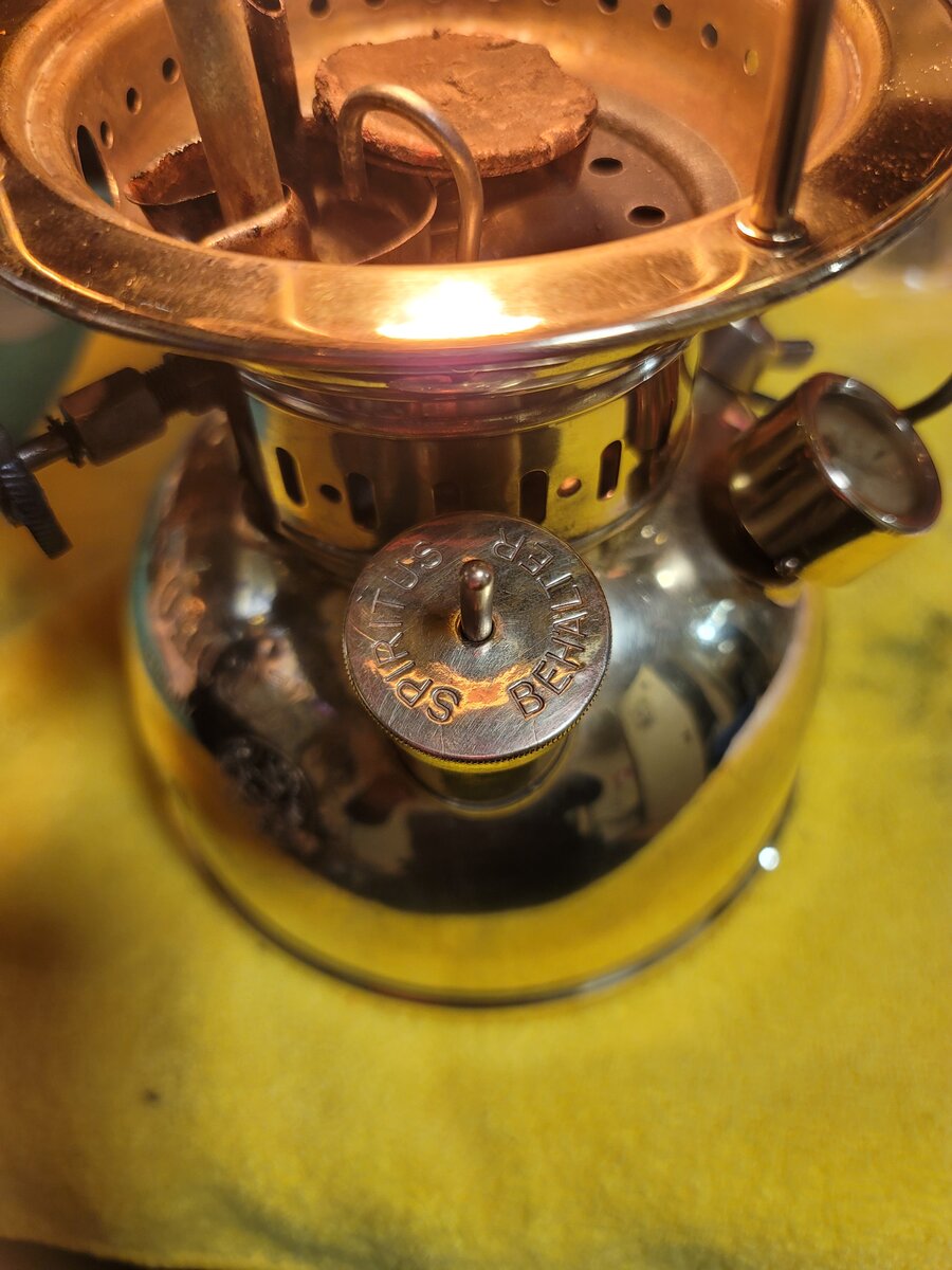

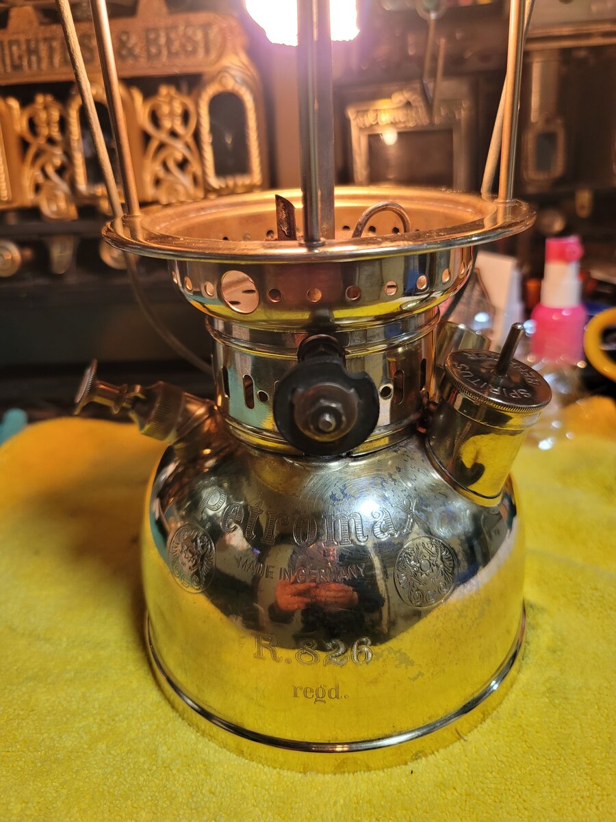

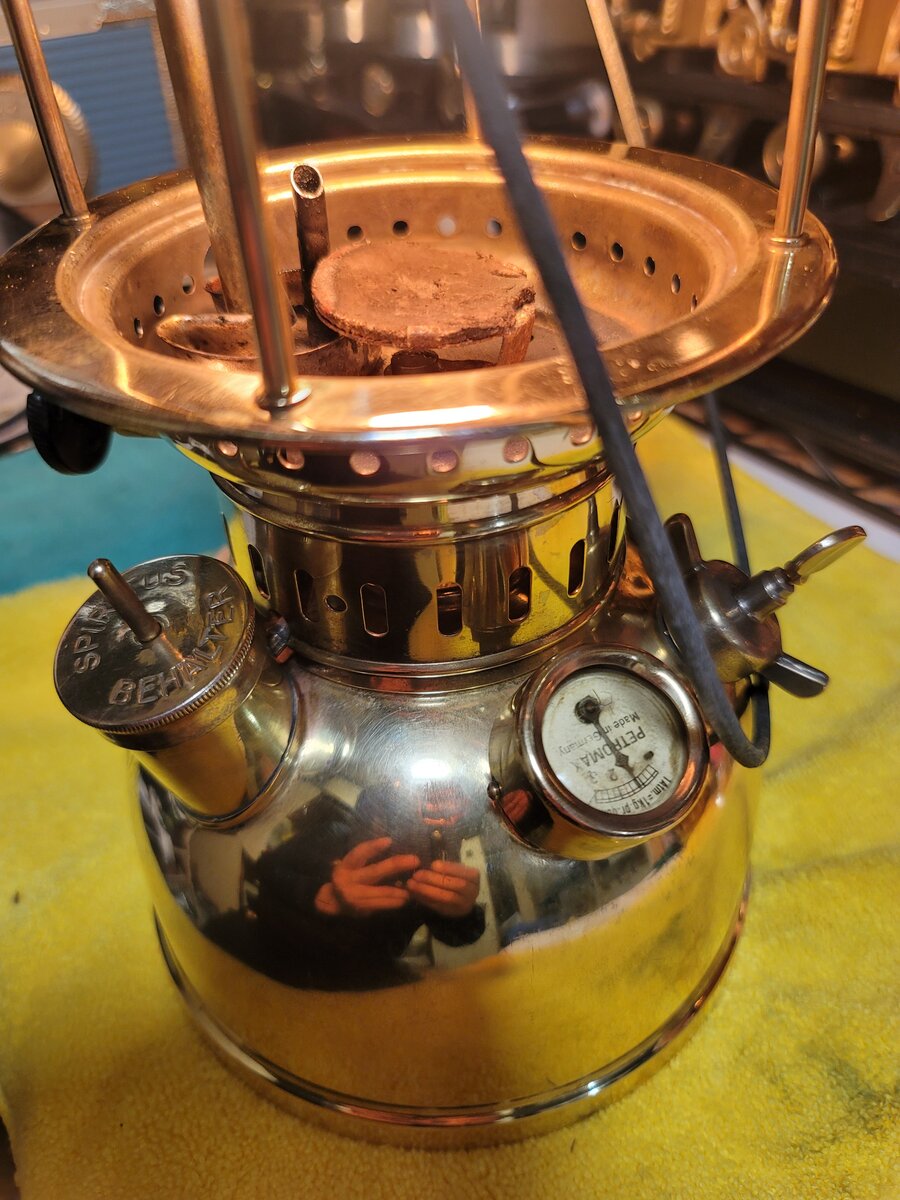

    Disassembly, cleaned and replaced parts.
    I was able to ignite it. Pump function is working properly
    Thank you for your help.

  6. Henry Plews
    3,072
    It looks fine now :thumbup: :thumbup:, but it would look even better if the control wheel was the other way round with the metal disc at the back :thumbup: :thumbup: :thumbup:.
  7. Fireexit1 United Kingdom
    3,538
    Yes ! and Watanabe san - the glass is the same size as the 829 so easy to find: 110mm Diameter x 115mm High
  8. Tom Pedersen
    Nov 13, 2019
    286
    Denmark
    Fascinating. I have never seen a Petromax where the alcohol container is integrated into the lamp.
    Can you upload a picture where it was taken out. Or is it soldered to the font.

  9. WimVe
    3,544
    @Tom,
    The "spiritus" pump is integrated into the tank. Like the normal air pump tube.
    The challenge is to find a complete lamp. Looks like our new friend manage just that.
    The lamp would look even more better when the pressure gauge is turned so the text is not upside down ;-)

    Thank you all. I don't think a round plate makes sense. (Asbestos??? ) Even when pre-heated, it is burning in the heat cup.

  14. Martin K.
    Martin K. Subscriber
    Sep 20, 2013
    1,148
    Dear Kazuyuki,
    the asbestos plate is meant to improve the heat shield and serves as a base for solid fuel (e. g. Hexamine fuel tablets), which can also be used for preheating.

    Is this the correct way to place asbestos?
