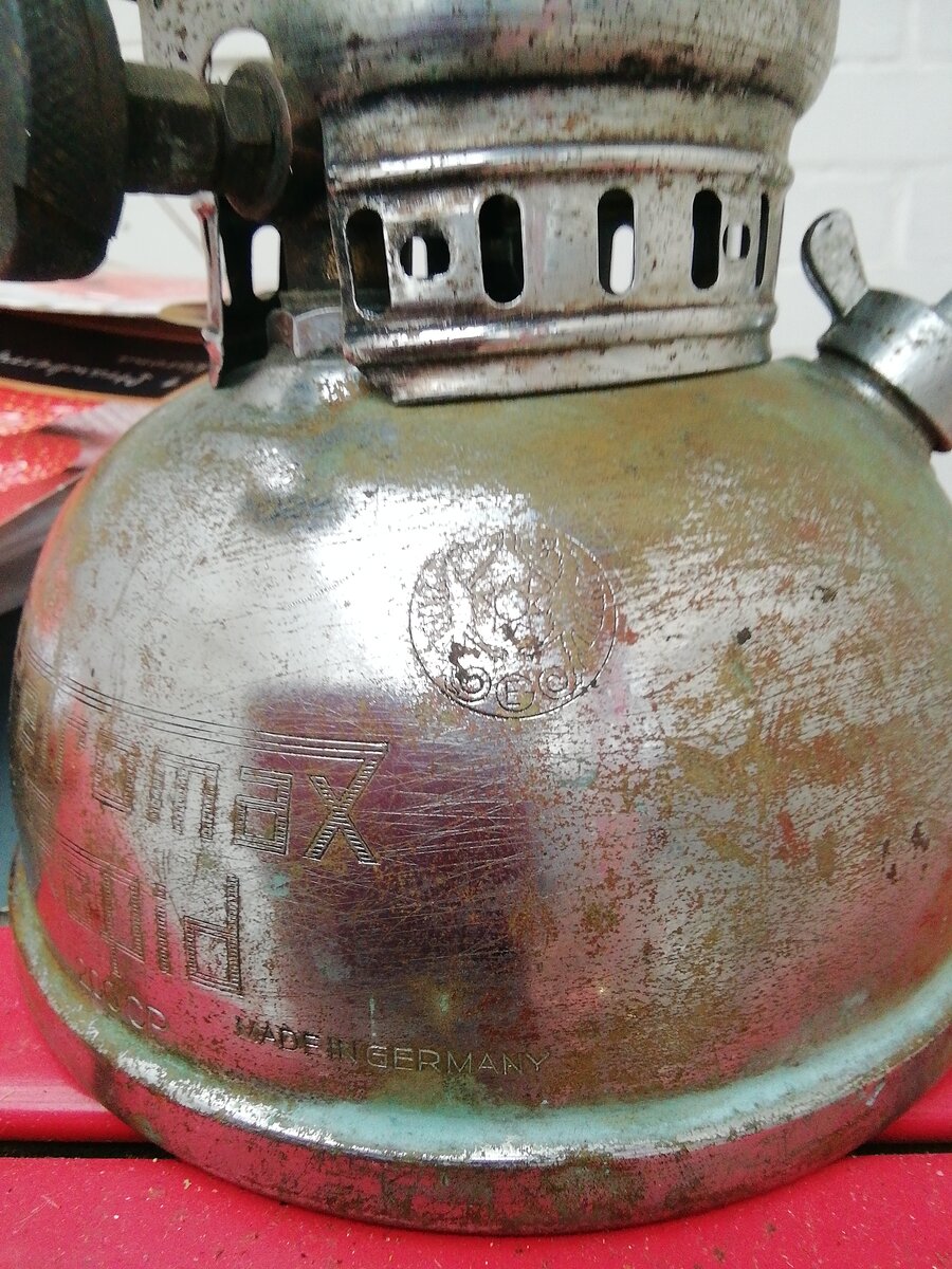

    I received this very worn Petromax today .
    I'm not overly familiar with this model of lamp ,I've managed to clean the dirt from the logo and there is only the 'e' in the circle and I don't see any numbers on the base .

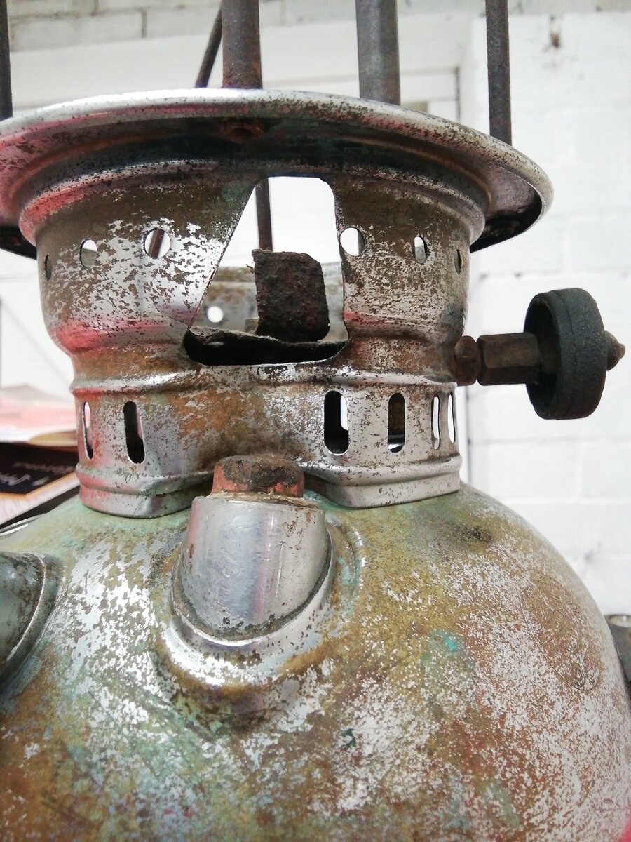

    There a few things that I could do with some advice on ,firstly the cut out in the frame for the rapid preheater looks like a homemade adaption .
    The inner base plate looks to have been custom made aswell .

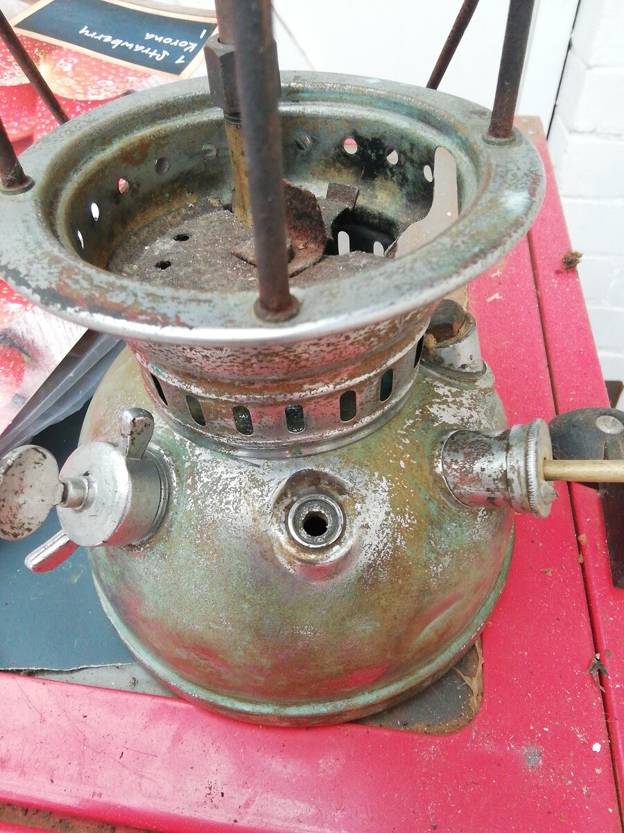

    What is missing from the hole between the pump and the filler cap,I have a feeling that it might be a pressure gauge ?

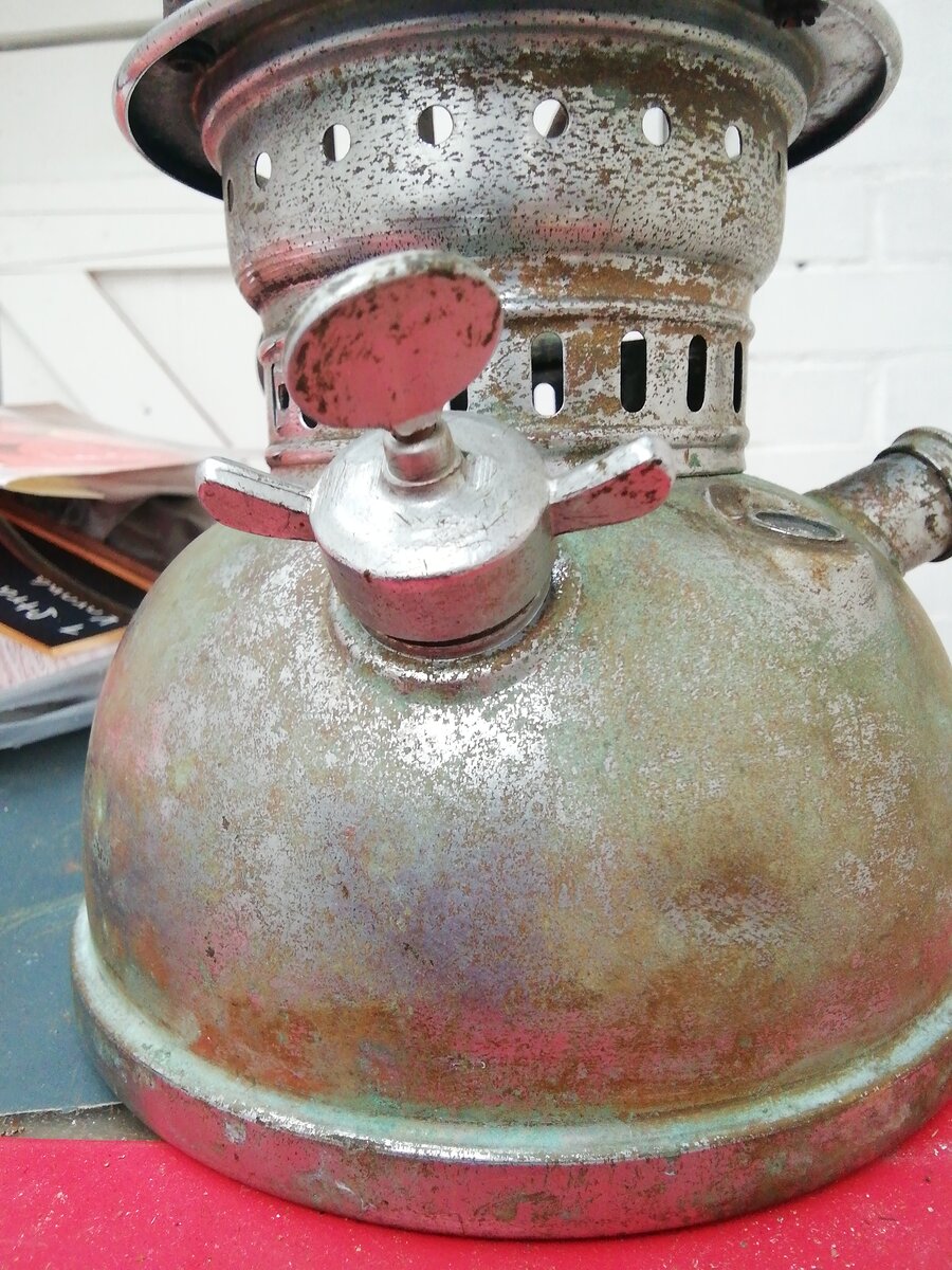

    And lastly for now at least, the filler cap, to my eyes it dont look right .

  2. podbros
    4,097
    Hi Marten.. if you look at the ‘E’ you will see it is inside a larger ‘G’
    lots of help available from members on here for your lantern :thumbup:
    ps looking at other 200cp petromaxes in the Gallery, I think the filler cap is ok?
    Good find :thumbup:

  3. Madras United Kingdom
    Sep 12, 2019
    112
    Uk
    I don't know how I missed the G with the E ,that was the first part I cleaned to see the logo more clearly, I did not notice that at all ,thanks for pointing that out :thumbup:
  4. MYN
    That could be a Petromax 827.
    Most of it is original except the pricker control knob. The original knob/wheel could be a single-piece 'fibre-pertinax phenolic' or an early 2-piece bakelite one.
    The cut-out was meant for the rapid preheater(missing).
    Yes, there should be a pressure gauge mounted where the hole is.
    The filler cap is the correct type for older Petromax lanterns.
    E&G(Ehrich & Graetz) of Germany would be the original manufacturer. Later units(still original German Petromax) only have a G (Graetz) in the logo.
    I don't have an 827.
    There are many members here having this model.

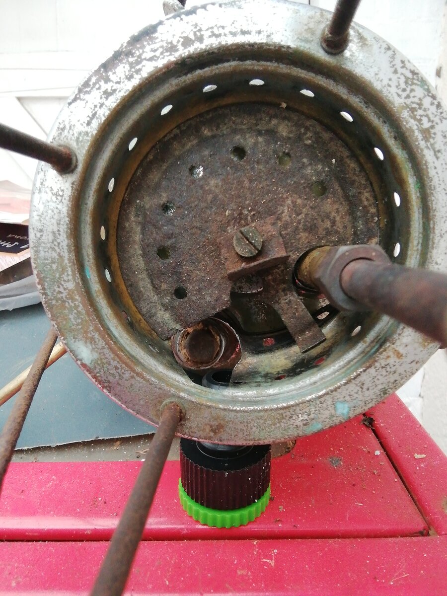

    What about pictures showing the top parts: hood/cap, inner hood and burner assembly?

  5. Madras United Kingdom
    Sep 12, 2019
    112
    Uk
    Thanks mum for the reply .
    I did notice the controll wheel when I gave a quick wipe over, it appears to be a two piece but I think it's brass?
    At the moment the controll wheel is stuck solid and I can't turn it so a little bath of wd40 is in order I think :thumbup:
  6. Henry Plews
    3,066
    The control wheel looks like a pump cap to me. Is it threaded on the inside ?
  7. Madras United Kingdom
    Sep 12, 2019
    112
    Uk
    Hello Henry
    Yes the control wheel does have threads in the inside of it ,and now that you mentioned it ,it does look like a pump cap ,unfortunately it got a little destroyed trying to get it off.
    Someone had brazed a sleeve to the inside of the wheel and then soldered the whole thing to the eccentric rod ?
