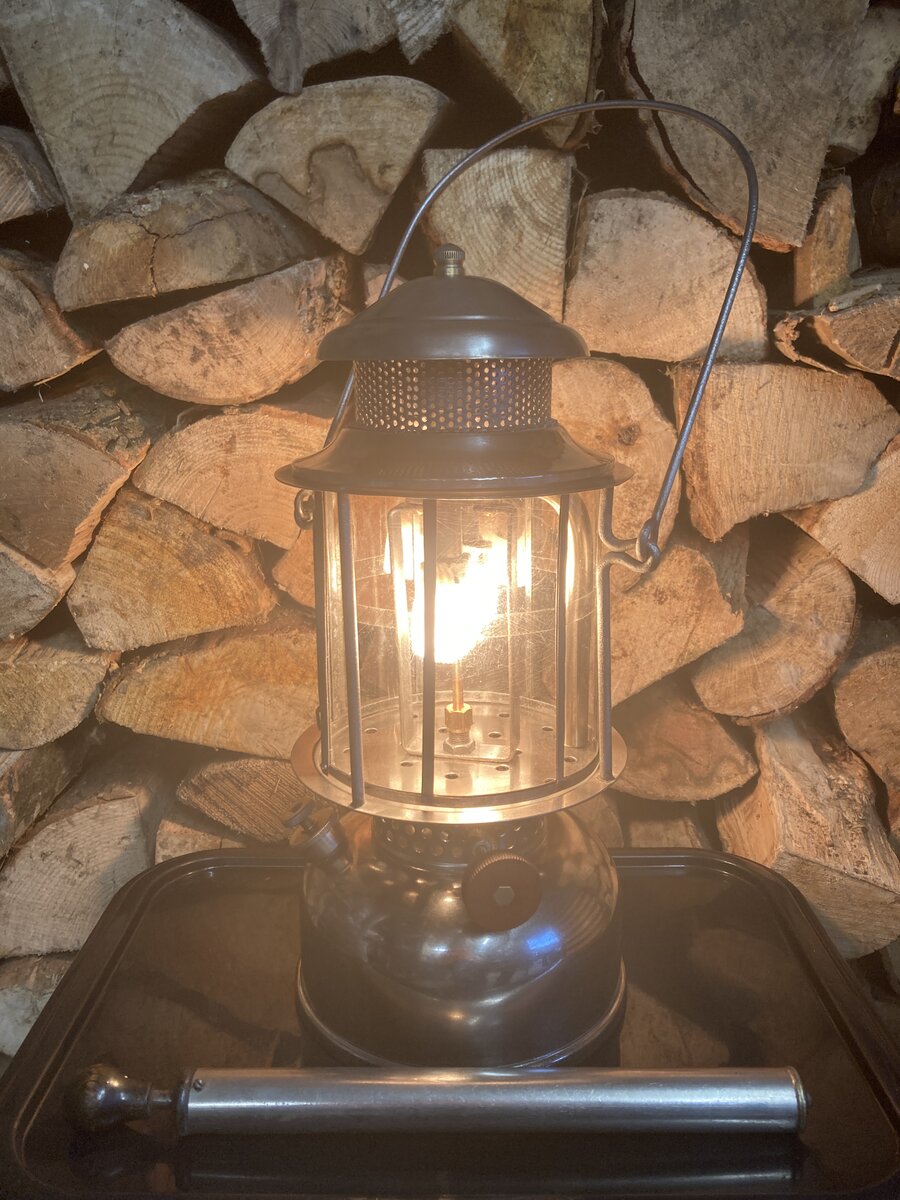

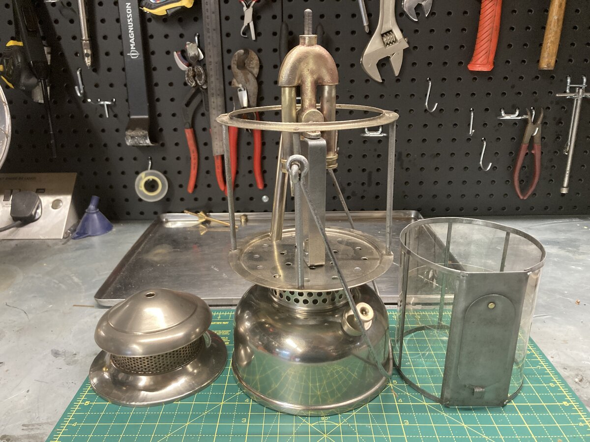

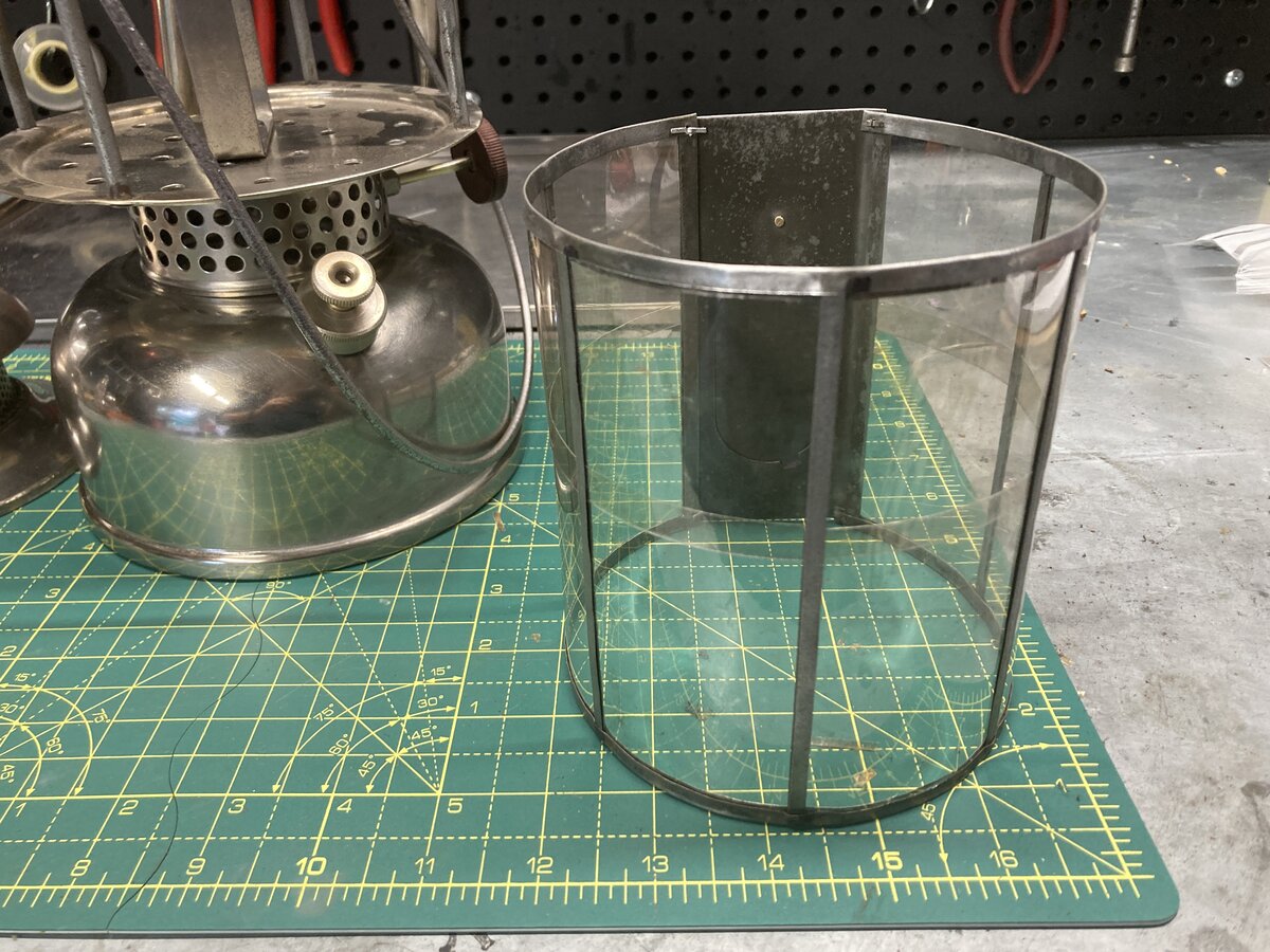

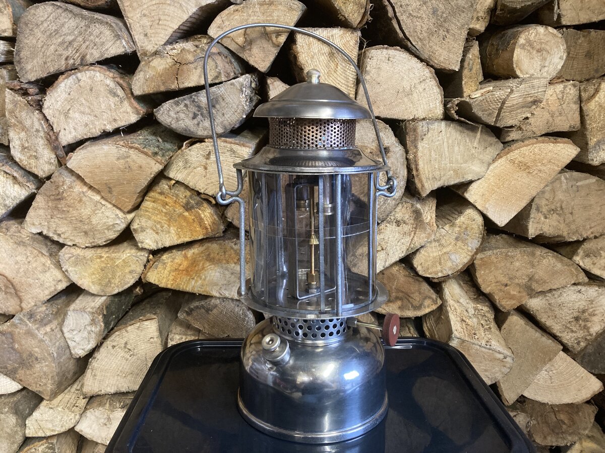

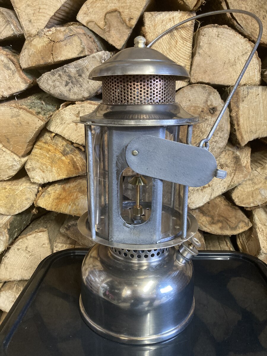

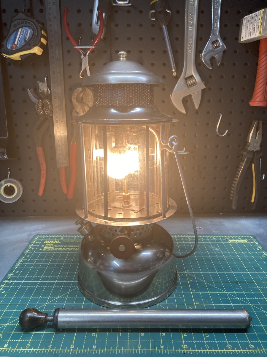

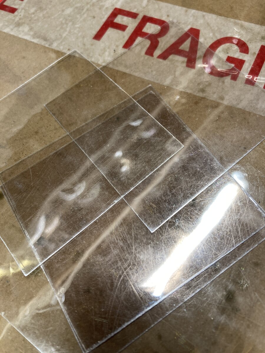

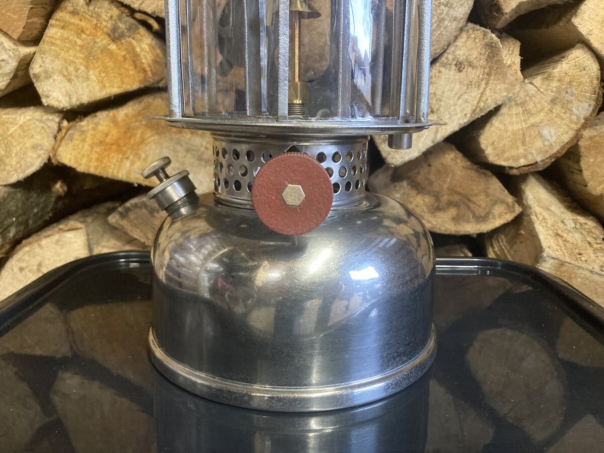

    I found this Phare Besnard “Peebee” in Spain in reasonably good condition but minus the generator and every pane of mica. Fortunately the chimney frame was still there. A good clean up, made some seals, dismantled the chimney to replace the mica and fitted a repro generator and away she goes. Great build quality as you’d expect of the period. The chimney rebuild was fiddly but not as bad as I expected.

    Looks good.
    Didn't know that they existed up until now.
  3. leo
    leo Germany Subscriber
    413
    That’s a nice lamp, well done!

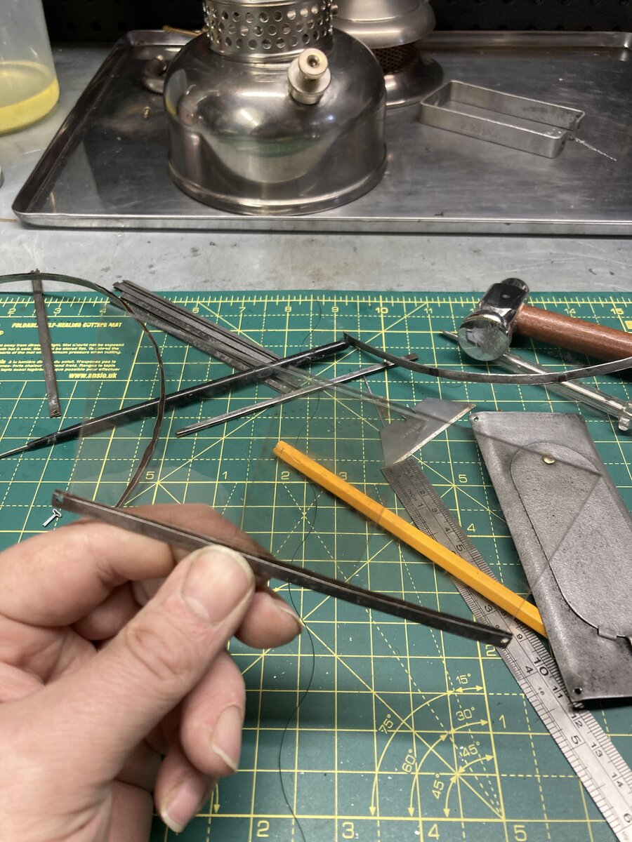

    Apart from the chimney refurb it was fairly straightforward. The chimney needed a few days in the evaporust bucket!

    Not a lamp you’ll see every day - Well done restoring it @Scott D
  7. Tony Press
    Great work on the Peebee!
  8. podbros
    4,116
    Top job and great work with saving the mica frame !
    Looks really good! :-)

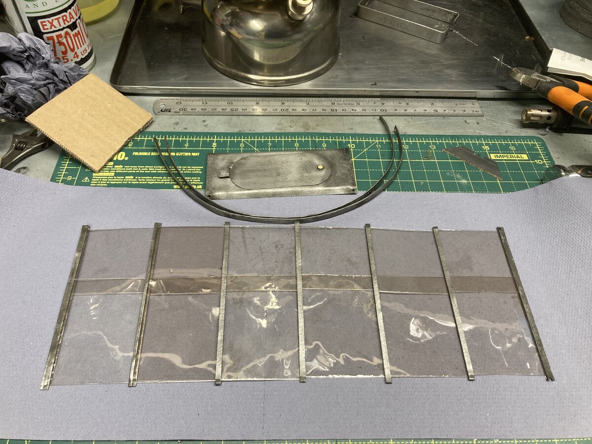

    The guillotine gave a better finish on the mica cuts compared with the scissors. A Stanley knife blade was really helpful too for opening up the frame to insert the new mica. Parallel brass pliers were good for crimping it all tight again.

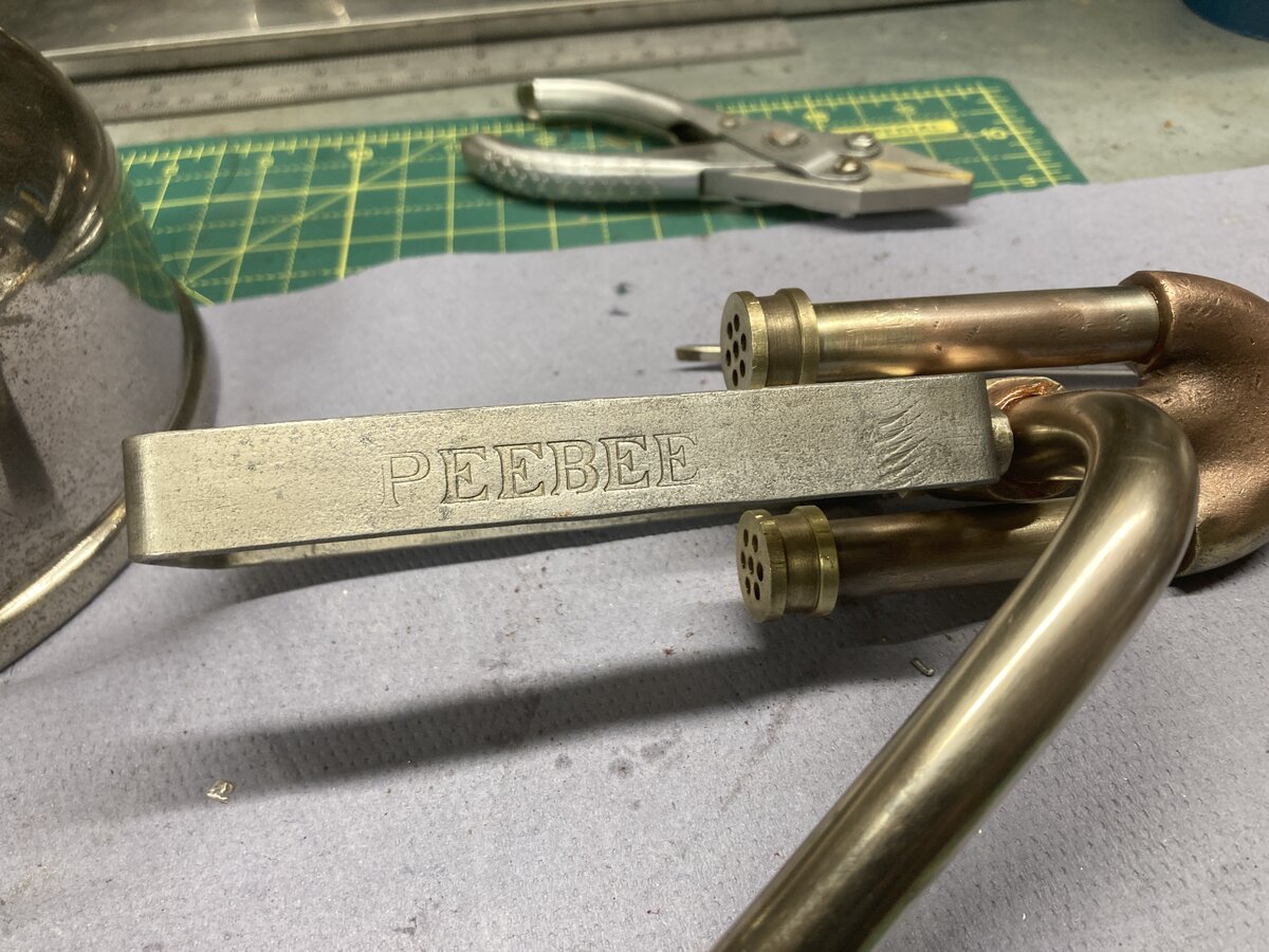

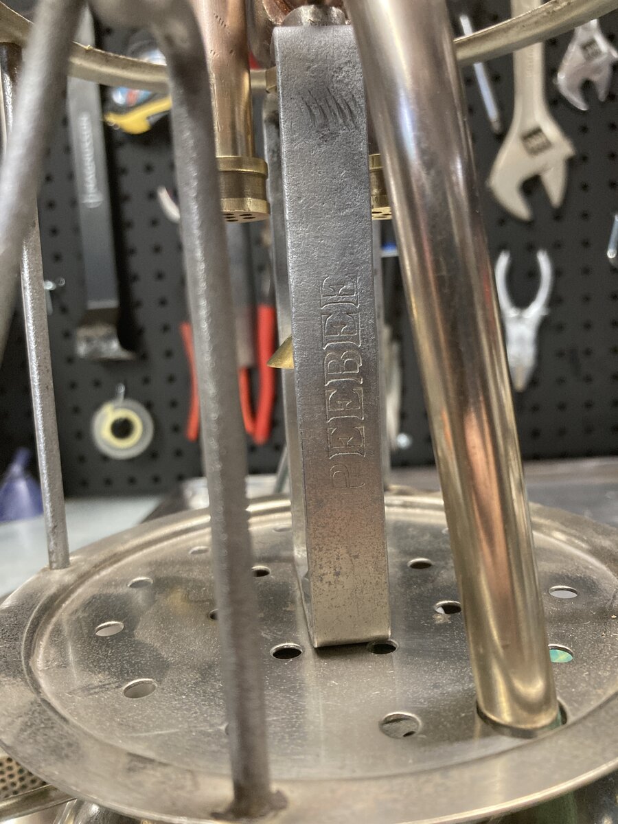

    It's curious, it looks exactly the same lamp as Nulite 5 or 5M, right?
  11. Scott D
    Aug 10, 2020
    756
    Yorkshire, UK
    @Serge - It does and I presume it pretty much is the same bar the stamping on the burner support. I’m still getting my head around the different Nulite models. The 5, 5M and even the 2 look very similar bar the generator. The 2 appears to have the high level tip cleaner. The 5M relates to the match lighting umbrella? Interesting that the 5M can also accept an R55. Will see how it goes with the current umbrella repro gen, but may run it with an R55 for ease.
  12. James K
    Nov 10, 2017
    656
    Nice to see such a rare lamp fettled up to such good condition, great find and great work esp with the mica chimney.
  13. Walkop Australia
    955
    Good restoration on a rare old lamp. Well done.
