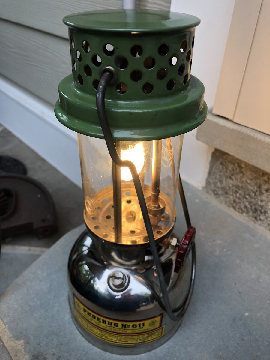

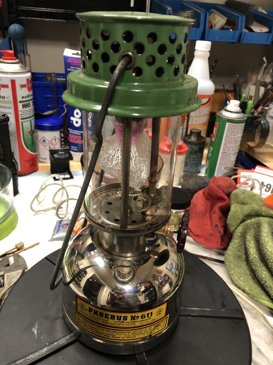

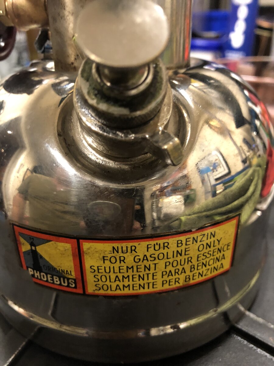

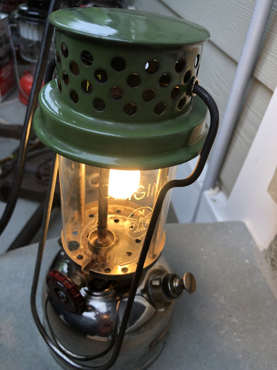

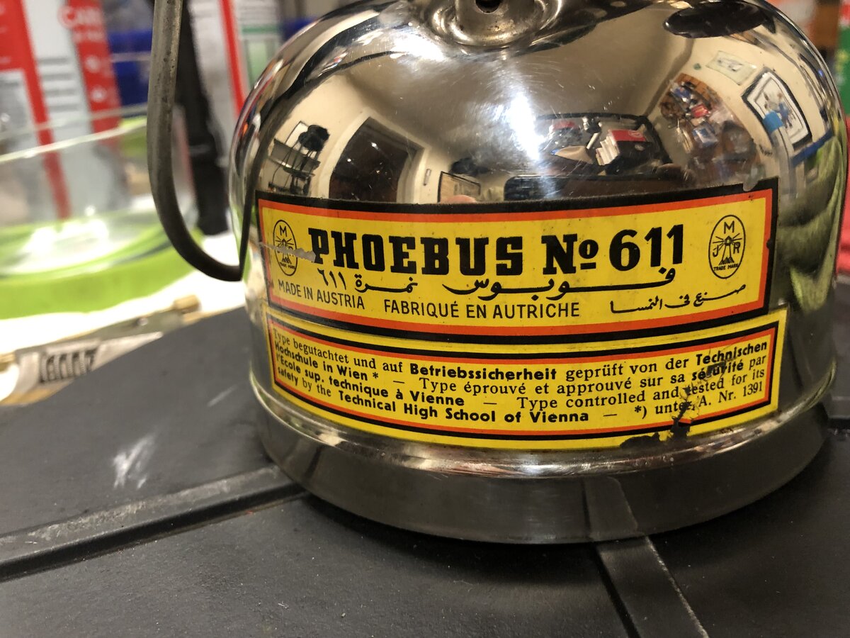

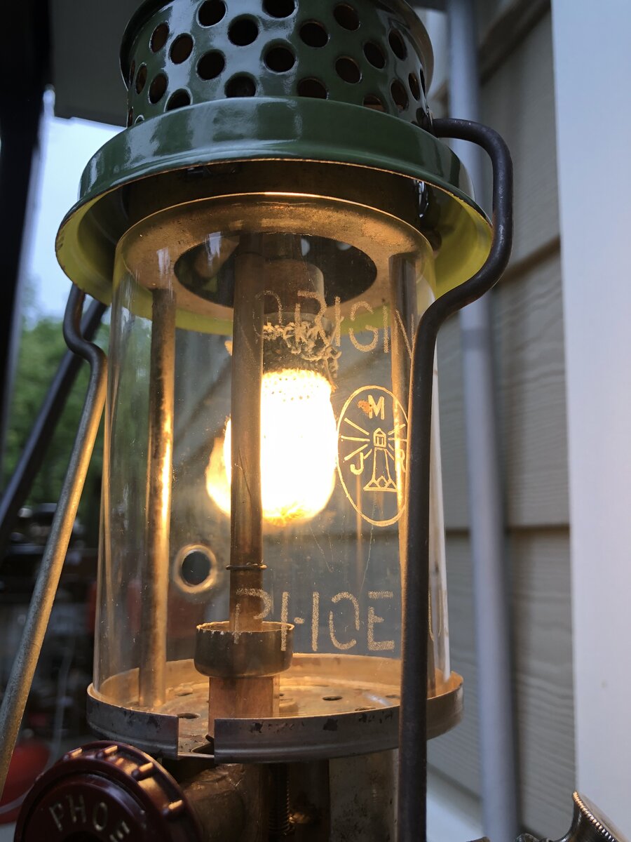

    Brought this little fella back from the dead … nice oddball lantern. And really quite bright!

    A neat lantern!:thumbup::thumbup:
    11,089
    Thanks for posting! Look after that glass...
    I see these are rated at 200cp, so your's must be operating very well. I note, too, that this is only the second one shown in the Reference Gallery.

    Thanks guys. I'm going to use a small mica chimney when I run it, and leave the original glass someplace safe.
    Tony -- I will take luxmeter readings soon, but I would say it's putting out a good 200+ cp. It's not a 350 but it's no shrinking violet either. I rather like it b/c without frosted shades, I find most lanterns are too bright to have on the (outdoor) table for supper.

    This is the first plated one I've seen - very nice :thumbup: :thumbup: :thumbup:

    Wow, Henry, you know that didn't even register with me until you mentioned it, but it's the first one like that I've seen as well. By the way, it was pumping out 5000 lux at the distance of one foot from mantle last evening.

    Use your Lux meter at one metre to get an approx CP reading. ::Neil::
  8. WimVe
    3,537
    ...and do four (4) measurements around the lantern. E, W, S, N or 12, 3, 6 and 9 o'clock. This way you eliminate any directional differences.
