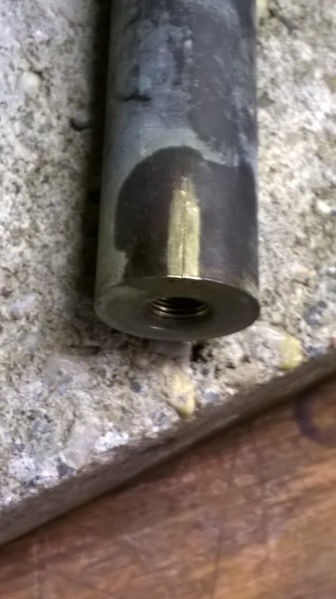

  4. bp4willi
    1,156
    Brass tends to have small cracks, which you even don't see with naked eye.
    When you have pressurized the empty fount and remove the pump piston ,
    do the water bucket test and have close look.
    Are bubbles coming out if the nrv centre hole?
    Or the lead seal of the nrv?
    Or from the brass pump cylinder wall?
    Recently I had to unsolder a pump cylinder from a Petromax, to close/ solder 3 (!) small cracks in the brass.
    Then insert it back into the fount.
    Lantern survived.
    Regards
