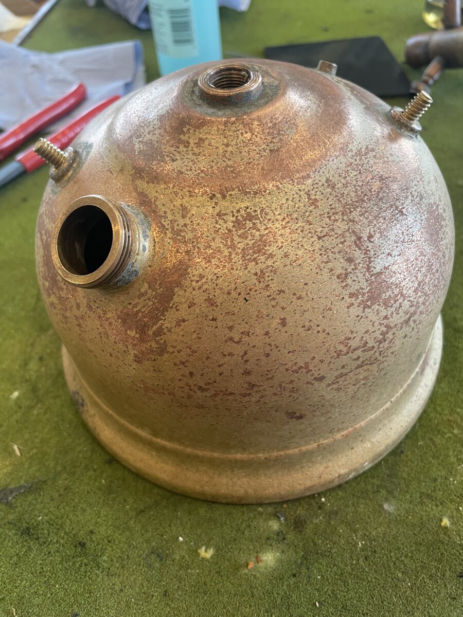

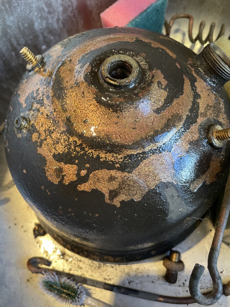

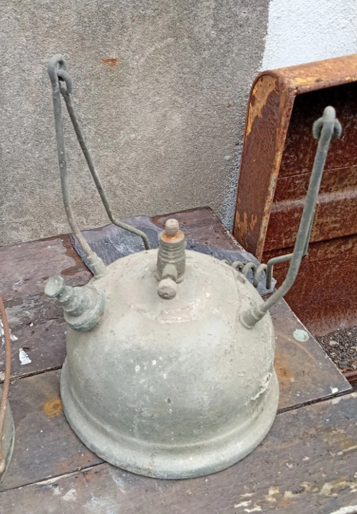

    I picked up a rough PL53 tank and handle as part of a bulk lot
    It was filthy so washed of and then found to be coated in something , pretty much every part
    A good soak in an warm citric acid mix and it’s back to a partly painted tank
    What the thoughts on paint ?

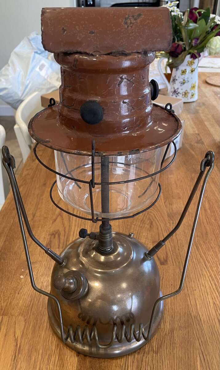

    I’m not sure it would look right polished and hasn’t the aged patina of my other PL53
    16,617
    It looks much better now.:thumbup:
    A previous owner most likely gave it a coat of paint, but the link below shows a Tilley which was originally painted black and there is also relevant information shown there.

    Much nicer, but this one is on you.
    Might be a nice exercise with high build primer/flatting back to fill in the little imperfections and giving it a gold topcoat. It's not really worth painting it unless you do that, IMHO.
    You could give it a rub over with Autosol to even things out and then rub a little oil in, it will turn mellow yellow quickly and should maintain that sheen/patina then.
    Either way, please report back!
