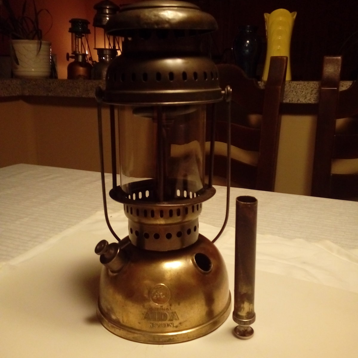

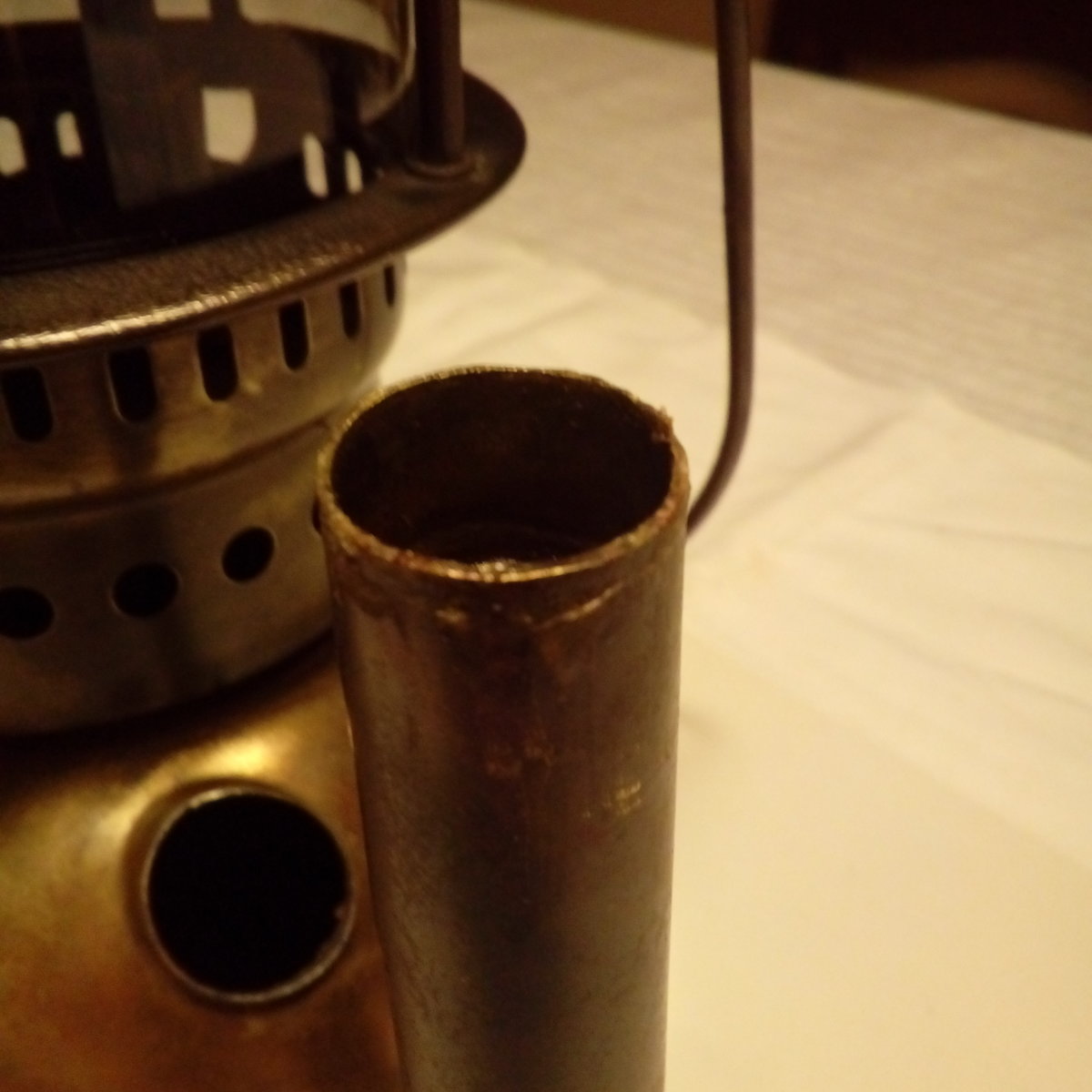

    That's what I found when I started the repair.

    It was not secured to the tank and the valve was missing

    Is the end of the pump in the font?
    If not you will need a donor from another pump or you will need to make a new end for the pump.
    The closest usable thread for the NRV is M8x0.75.
    Primus NRV M8 thread ?
    There are several posts here about re soldering a pump.

    I have an N.O.S. (NOS) 120mm by 20mm complete tube here if you want.
